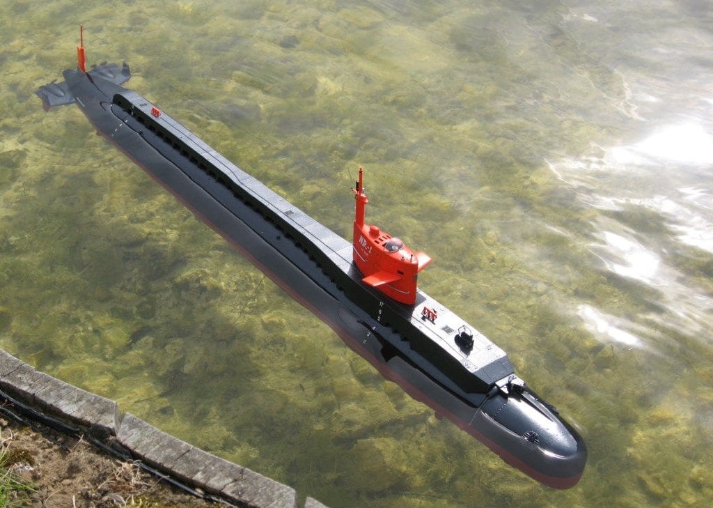

At the time of writing in early 2013, the model has been built with the intention of being a working diving model, but currently the dive unit and drive motors have not been installed, owing to a house move. It has been photographed though, suitably ballasted and in the water, and when finally fully operational will be an unusual model submarine.

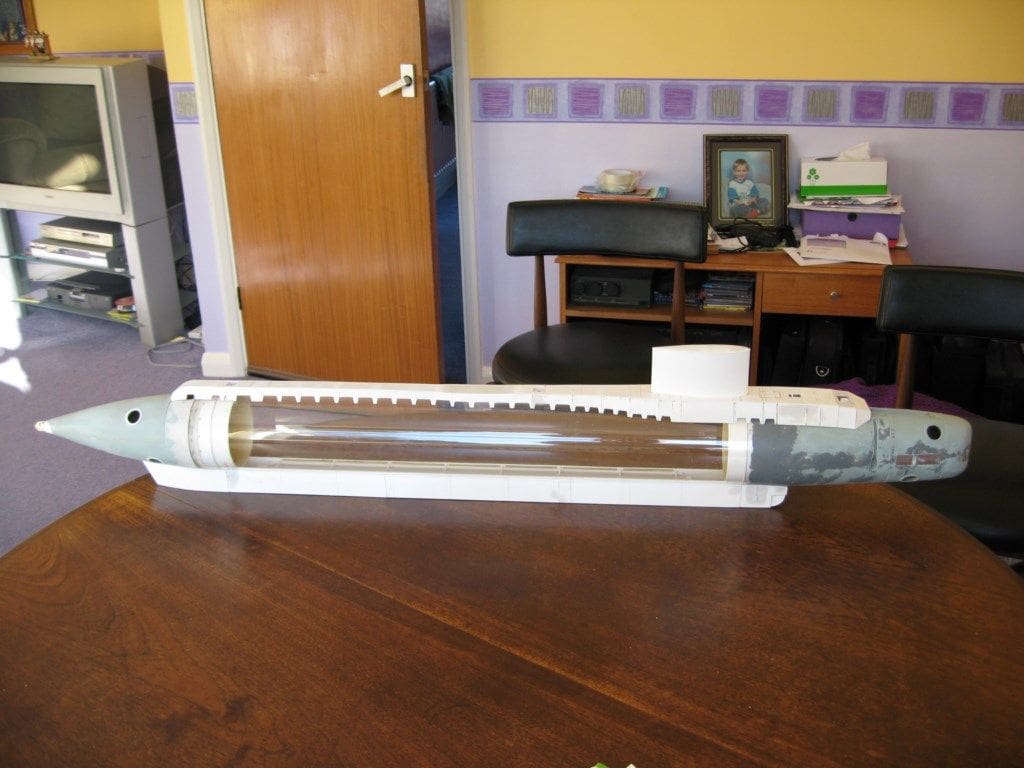

The scale of this model of NR-1 is governed by having a 100mm diameter clear acrylic tube for the centre section of the hull, so determining the scale of 1:36. Having such a tube for this part of the model is of course very handy for installing a dive unit, but the two propulsion units will have to be outside of it unless a means of connecting the propellers though the hydroplanes to motors inside the hull can be devised, but that is for the future. From photographs and information obtained from fellow submarine enthusiasts, a drawing was created, based around the 100mm diameter of the central part of the pressure hull. To this would be added removable bow and stern sections plus the substantial styrene keel box which will contain the drive batteries in a sealed tube and a built-up top casing, also of styrene. The sail (conning tower) is also a moulding taken from a master.

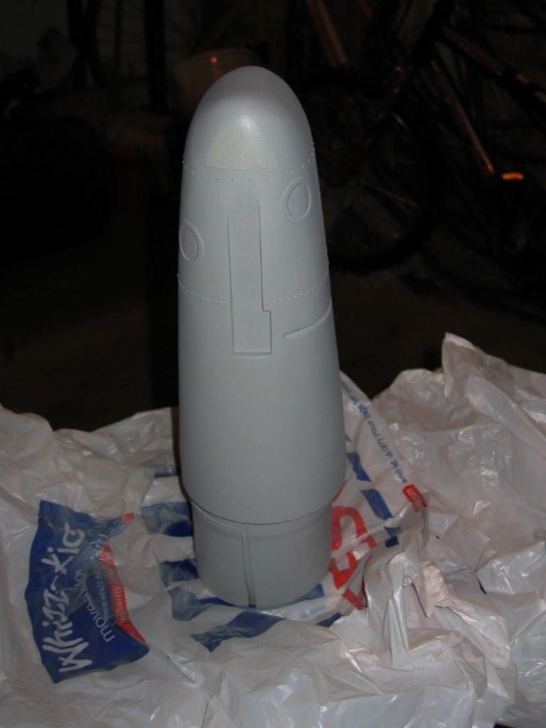

This is unusual in that it is neither like a WW2 designed submarine, nor is it like a modern nuclear powered attack boat, but is somewhere in between the two. A master was made using balsa wood frames, the shapes of which were taken from Roger’s plan and the spaces between them filled with expanding polystyrene foam. This was shaped as necessary, covered with filler and sanded to its final profile. Allowance had to be made for a sleeve at its rear end to fit later into the 100mm acrylic tube.

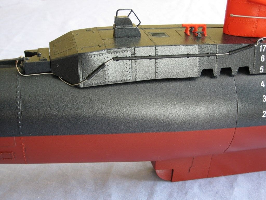

This basic ‘master’ for the bow section, had detail added in the form of seabed searchlights, sonar panels, thruster outlets and of course rivets, this last feature not usually being seen on modern submarines. This relatively modern submarine actually has loads of rivets, which makes it even more unusual and a model making challenge.

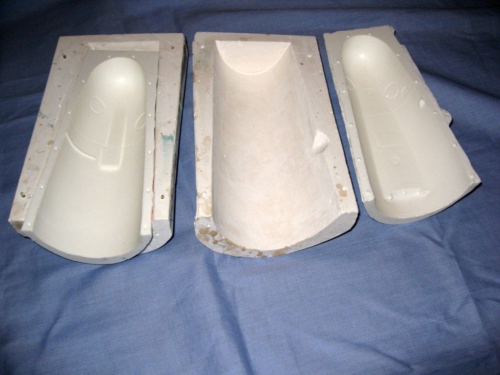

Once the master (sometimes known as a plug) was complete, a silicone ‘skin’ mould in two halves was taken and the complete bow section moulded in GRP and in one unit. Silicone rubber ‘skin’ moulds were used so as to ensure all the detail was transferred to the mouldings and also to keep costs down. This flexible rubber is not cheap! Reinforced Plaster of Paris was used to support the silicone.

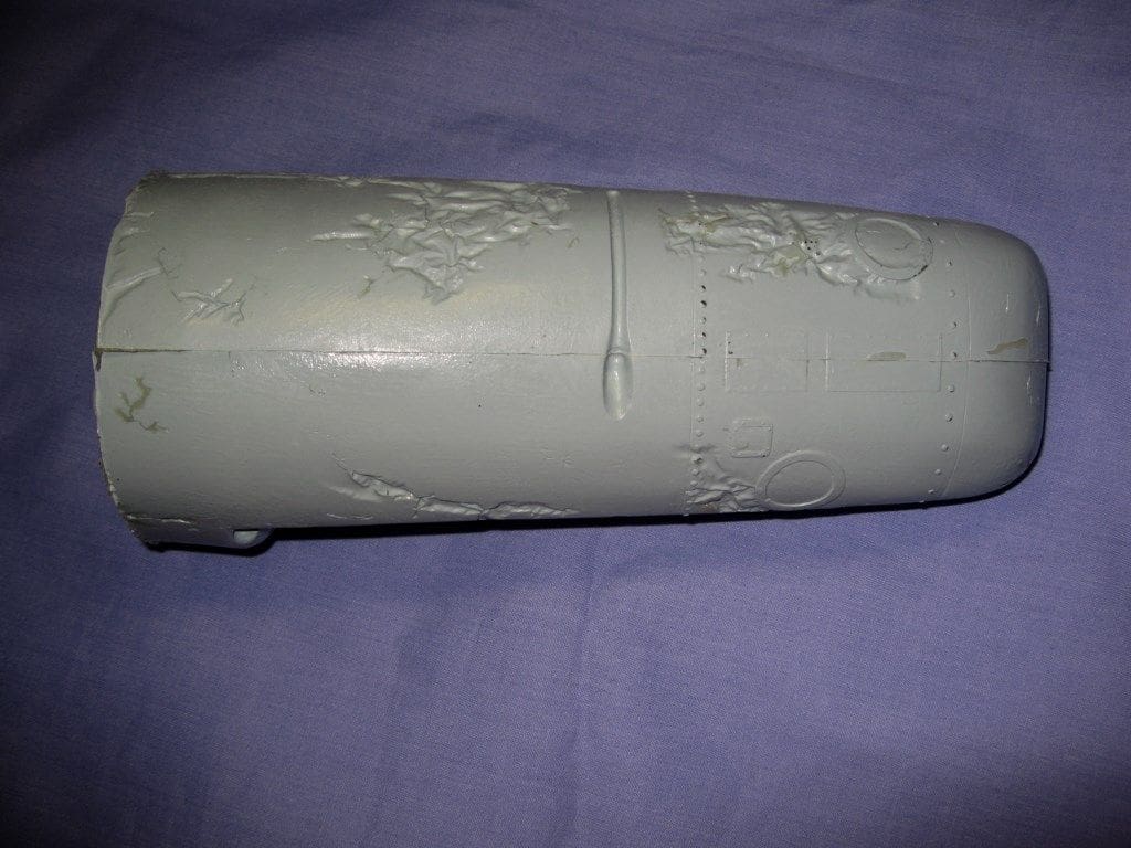

There were problems actually making the GRP moulding, due to low ambient temperatures and damp at the time, but a decent hollow version was eventually produced from the mould.

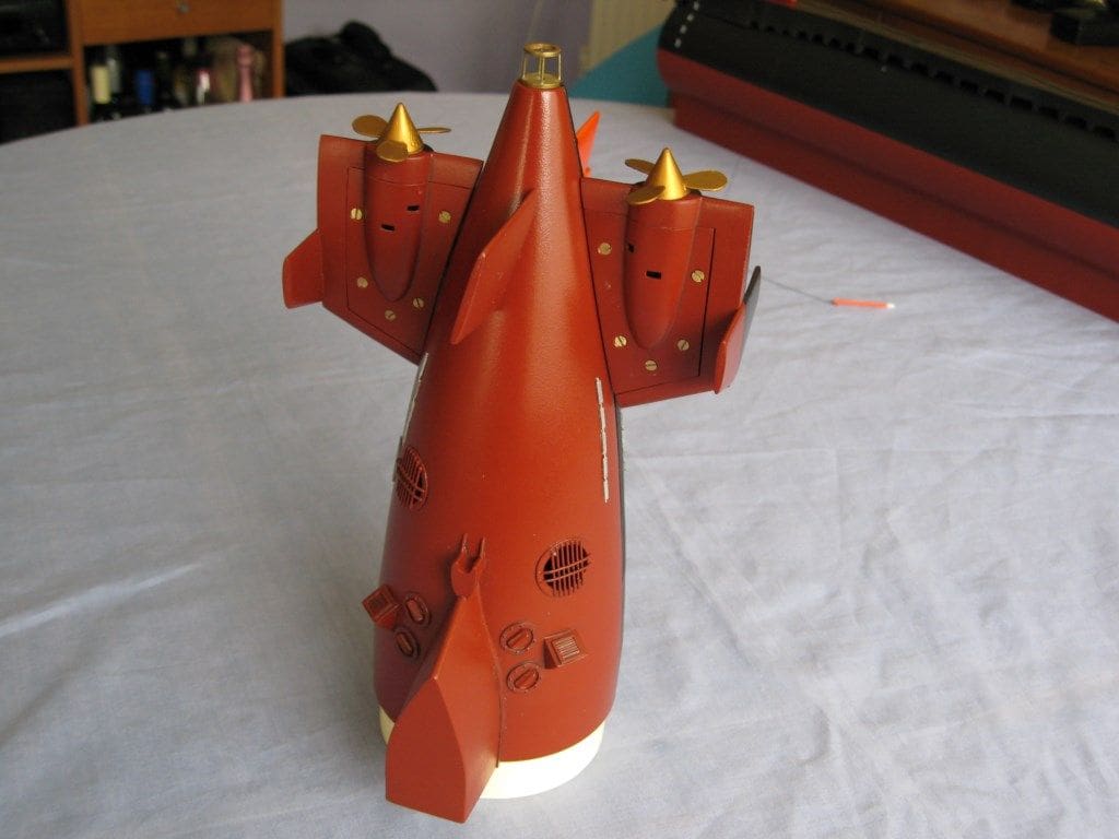

In many ways this was much easier, as the basic shape is a cone with a ‘curved cone’ if you understand what I am writing! The ‘master’ for it could could be turned on the lathe to be just perfect. Like the bow section, some detail was added to it, a mould taken and the stern cone likewise made of GRP. Joining it to the main central tube was in much the same way as for the bows, using a sleeve to slide into the 100mm acrylic tube. The real challenge, was later making the hydroplanes and stabilisers and ensuring they were perfectly in alignment with the axis of the hull.

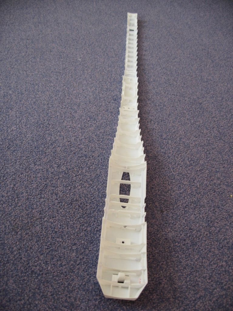

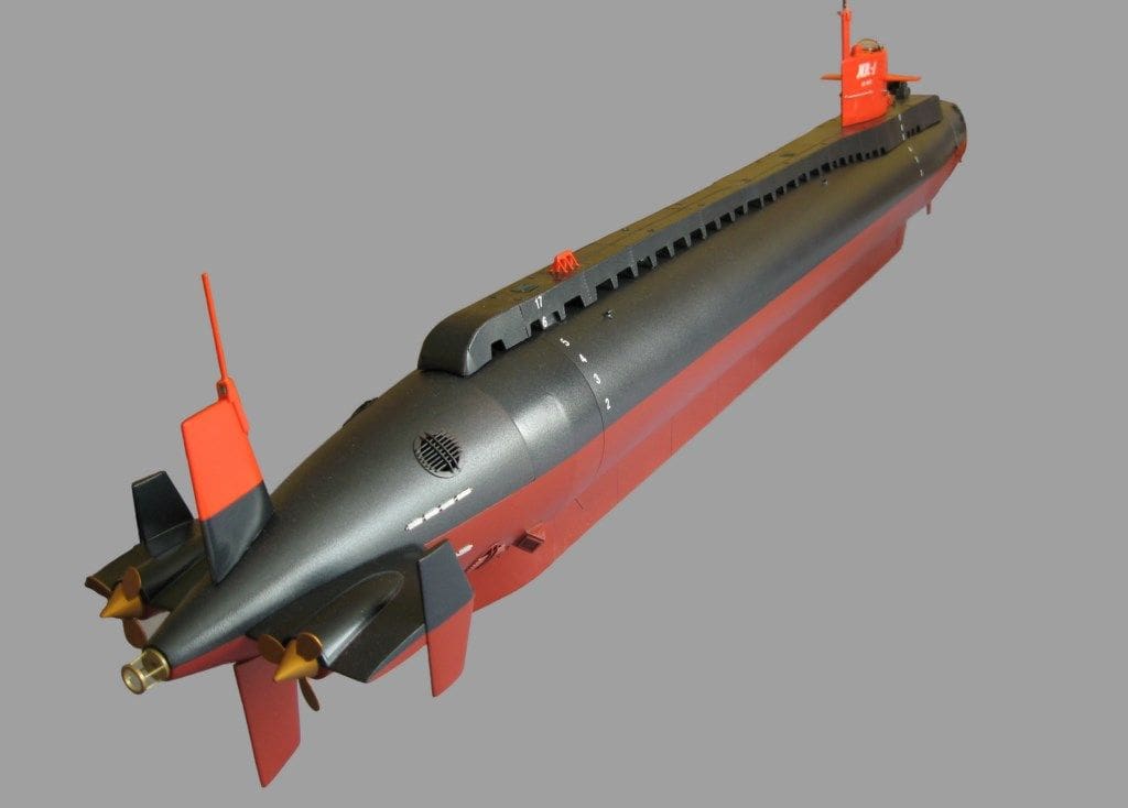

This is quite complex, with numerous cardboard templates being needed to get all the profiles just right. Since it has lots of openings in its outer surface, care had to be taken to ensure its cross-members would not appear immediately behind a hole. This complete unit is fixed as once piece to the central tube, whereas the keel is in three parts joined separately to the bow, central and stern sections. Care had to be taken to ensure that everything was in perfect alignment each time the model has to be reassembled. To do this, Roger made sure nothing could be reversed, the tubular butt joints were perfect and additional alignment pegs built into, and onto, the sections means that there is no room for mis-alignment.

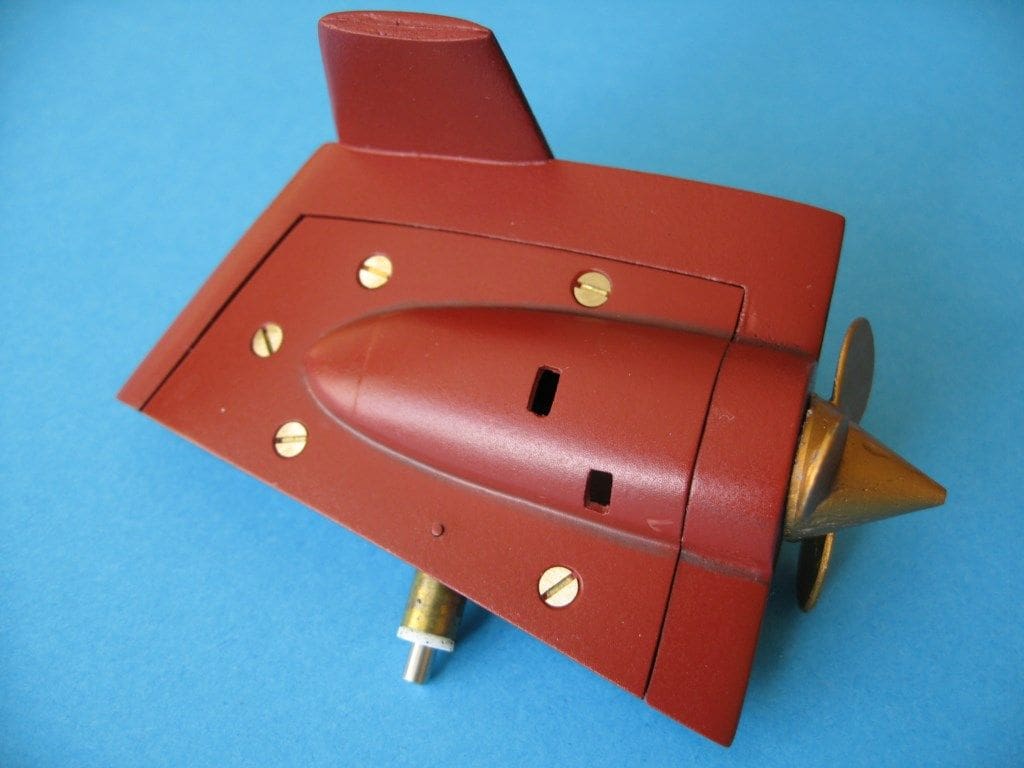

As mentioned earlier, the propulsion units and propellers are mounted on the moveable hydroplanes. For all the sections of these, masters were made and moulds taken from which resin pieces were made. It was possible therefore to make hollow mouldings for where the motors should go. Sections of the whole assembly are removable, being held in place by screws out of the normal line of sight by being underneath. Getting everything square was a nightmare, but Roger got there in the end!

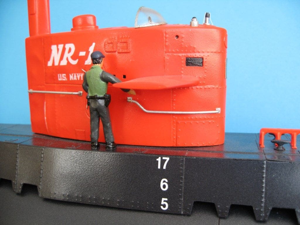

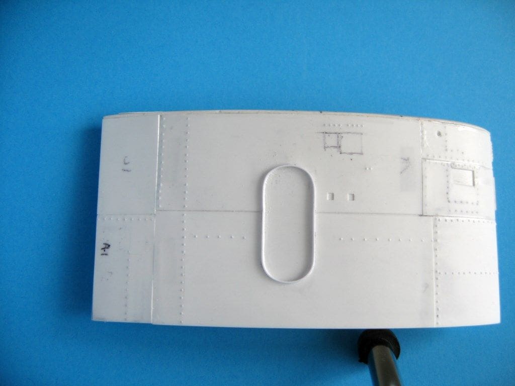

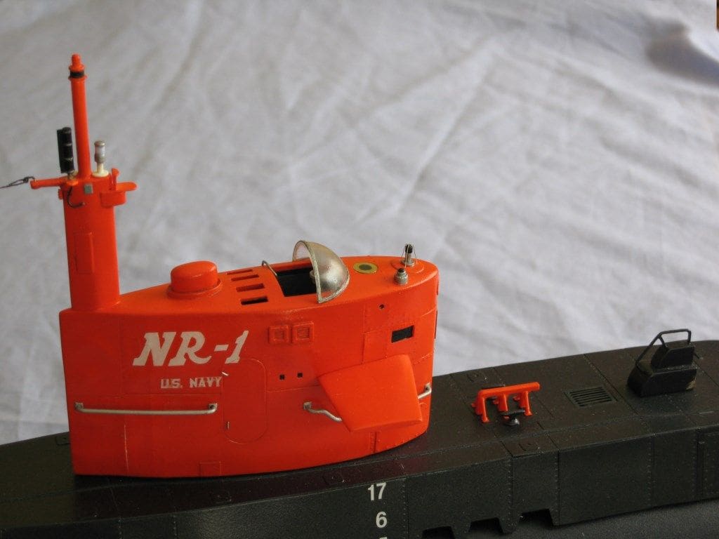

Following standard US Navy principles, this has the forward diving planes mounted either side of the ‘sail’. As for the other principal parts of the model, a well detailed master was created, a mould made and a resin casting produced. The rivet and panel detail is a key feature and Roger has successfully replicated it all. The NR-1 logo on the conning tower is produced by Roger on a computer, the unusual font being hard to replicate.

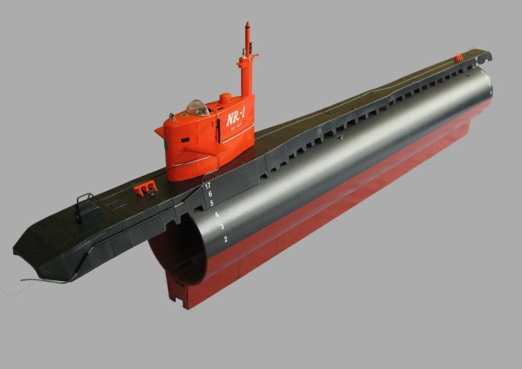

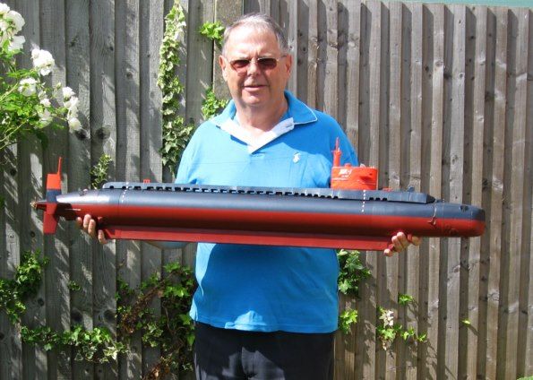

Having a black and red oxide hull, together with a red conning tower, certainly makes the model stand out from the current all black colour scheme of modern naval submarines. Nothing more exotic than car accessory shop standard aerosol spray cans were used where possible.
The model is now complete, but only as a static model, although it has been ballasted and floated for photographs. The dive unit and motors have had to be put ‘on the back burner’ whilst house moves are underway in the winter of 2012/2103, but in due course more will be published and possibly a full feature article.
