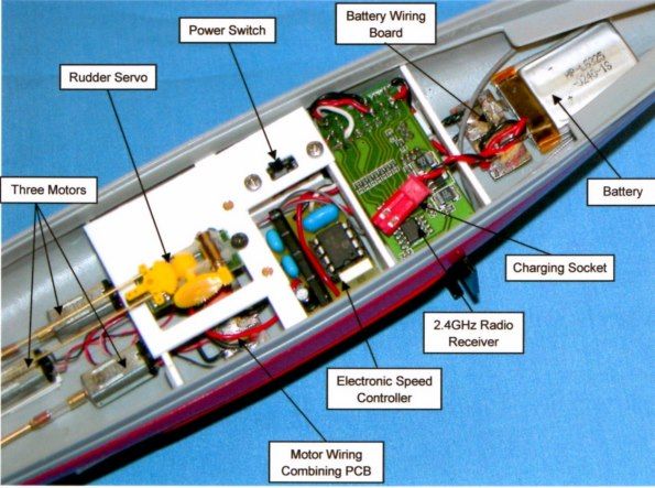

The initial task was to find suitable r/c items that were not only small, but also light. A very small servo was located that weighed only 1.6gms together with a small electronic speed controller (ESC). Details of these are listed at the end of this article.
ESC and receiver modifications
ESC
This was purchased in kit form, since I did not intend to use the plastic box supplied as I was convinced that it would not fit into the hull of the model and on receipt I was proved right. The printed circuit board (pcb) was trial fitted into the hull and did not require any further modifications. All that was needed was for me to assemble and solder the components to the printed circuit board in accordance with the supplied instructions. The device was then tested and found to work satisfactorily.
Reducing the receiver size
Looking at the receiver it was evident that it was too large to fit inside the model, so the plastic housing and connector were removed, reducing the unit in size and weight. The servo and esc would later be wired directly to the receiver board, thus saving some weight on plugs and sockets.

The plastic propeller shaft stubs (port and starboard) were drilled through their centres in order to allow a 1/16 inch diameter brass running tube to be inserted. The centre tube is cast as part of the hull, which is supplied in two halves, this requiring a small slot to be cut down the centreline of each half shaft stub. The two halves of the hull were then glued together and a 1/16 inch drill run down the slot, opening it out to accept the centre running tube. The propeller shafts were made from 0.9mm diameter brass rod, each threaded at one end M1.0. The propellers, as supplied with the kit were each drilled and tapped M1.0 to match the shafts and then screwed on and bonded into position. The A frames were each very carefully drilled out to accept a short length of 1/16 inch brass tube for shaft bearings.
The twin rudders were each drilled and tapped 16BA and two small shafts made from 0.8mm brass rod with a 16BA thread cut at each end. The rudder post tubes were made from 1.5mm copper tube and two small tiller arms fabricated from brass sheet. The three flexible couplings were made from short lengths of silicone tubing with brass bushes inserted and glued in at each end. All these parts can be seen in Photos 3 and 4, just prior to their assembly into the hull.

Final hull layout and wiring
Having assembled and glued the hull together, I noticed that the sides had to be sprung out in order that the deck would seat into it correctly. So, some full-width bulkheads were made to correct this problem and they also support a small platform within the hull to which the rudder servo and power switch were mounted. There are also some small dividers added in order to retain the esc and receiver in their correct positions. Two small printed circuit boards were made; one to assist in combining the wires and decoupling of the three motors and the connection to the esc; the second was used to interconnect the battery and power switch wiring.
Painting the lower hull
The propshafts were removed from the hull together with the twin rudders. The upper half of the hull above the waterline was masked off, allowing the lower section to be painted red together with the rudder blades. The three plastic propellers were painted bronze, then everything was allowed to thoroughly dry prior to re-assembly.
The individual r/c assemblies were tested before they were wired together and fitted into the hull together with the propeller shafts and rudders, Photos 7 and 8, all followed by functional testing of the complete system. So far, so good!
