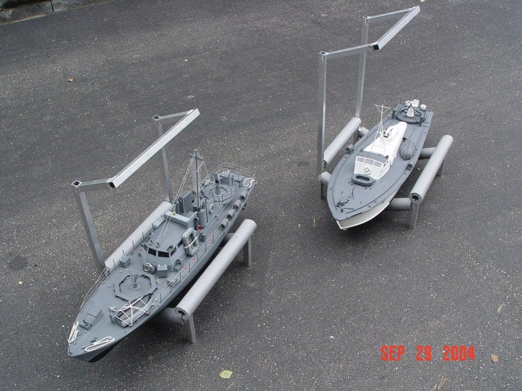

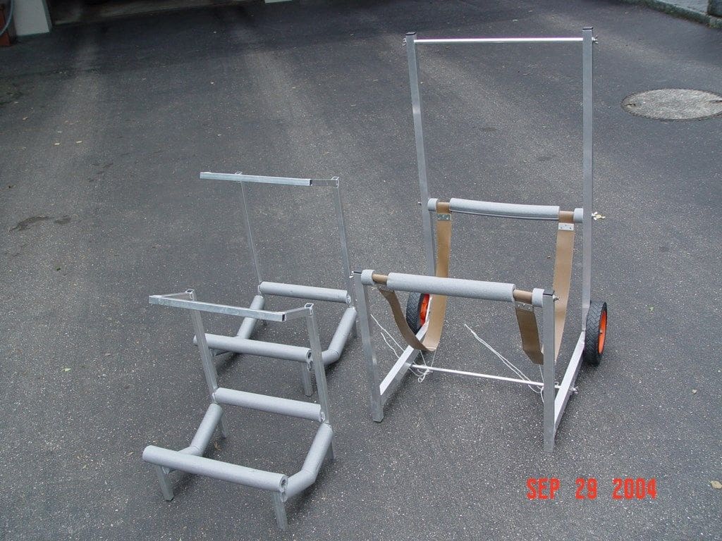

Smaller boats can be hand carried in an aluminium frame without wheels. One size doesn’t always fit everything, so there are two smaller frames that are not quite identical.

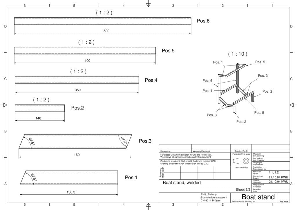

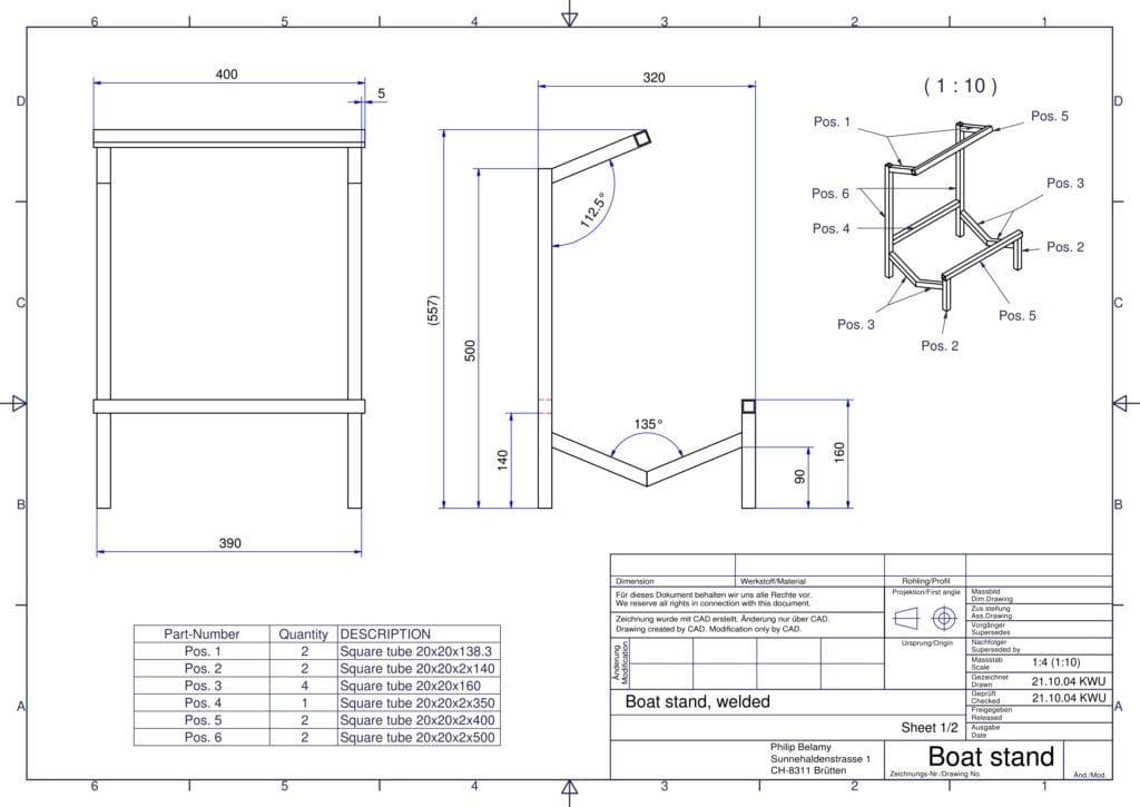

Why aluminium? Well, it is lighter than steel and does not need any surface protection for normal use and is a material of which I have experience and can weld. These two frames were made from 20 x 20 x 2mm (wall thickness) square aluminium tube and all the joints welded, but with minor modifications could be bolted together if you wished.

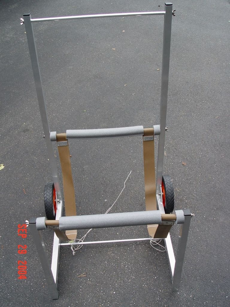

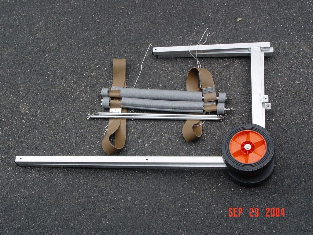

Square tube? Again, it is easier to cut and weld a straight line than a curved one which will happen if round tube is used. All the cuts are either 90 or 67.5 degrees and the welds were around the entire circumference of the tube to form watertight compartments. The ends of the other tubes are left open so that water can drain out as necessary. It should be pointed out though, that aluminium construction is not recommended for salt water operation. The largest of the three frames is of a slightly different construction, but again from aluminium. The bottom member is much deeper than the vertical tubes, which was necessary to give some added stiffness. This frame can be easily taken apart for transport and is held together when erected by threaded rods and wing nuts. The threaded rods are held in the aluminium tubes with just a roll pin and are of stainless steel. It would seem to me that today’s zinc plated steel fasteners, which are only clear passivated, are manufactured so that they do not rust as long as they are on the vendor’s shelves, but by the time that you get them home the rust has already started to attack the base metal.
Stainless steel fasteners are only slightly more expensive than plated steel versions, but not all stainless steel is truly rust proof, especially with salt water. Most fasteners are grade A2, but for more corrosive use then grade A4 should be used, the latter being obtained from ship’s chandlers.

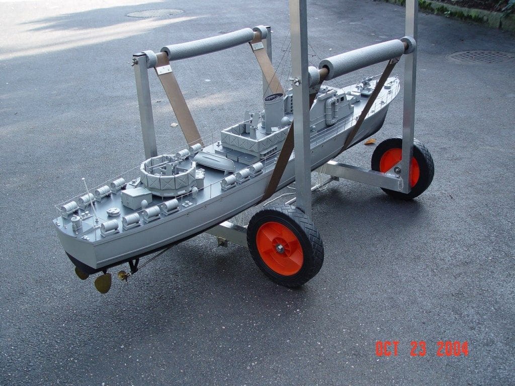

Foam plastic pipe insulation has been used to protect the models from their normal display stands, but on this cradle the rubberised canvas support straps for the hull are similar to that used by some chair manufacturers. With just simple sling supports, it will be found that the model rocks too much when being transported, so the lowest point of the catenary is tied with some nylon cord to the lowest cross member, so the sling is now nearer to being a vee shape. The wheels are plastic and are bought as spares for a lawn fertiliser tool, their axles also being from stainless steel.
The dimensions for these cradles will depend on the models to be transported and of course the room that one has in one’s vehicle. Certainly do not make them too narrow and don’t forget to take into account the thickness of the foam insulation when determining the width and height of the cradle.
