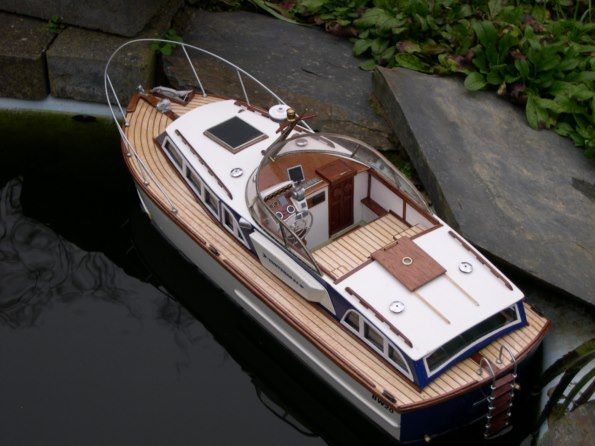

Cabin, cockpit and fittings
The cabin construction is basic and straight off the plan. I chose to stick to my favourite material of wood instead of styrene, although I did make the window frames out of 1mm styrene which proved a pain as I should have used 0.5mm which would have been easier to cut. Most of the upperworks are 1/32 and 1/16 inch plywood with 1/8 inch balsa strip to strengthen corners.
Mahogany was used where the real boats had it, namely for the doors, capping strips, handrails and so on, all of which was cut down from larger pieces, usually scrap. Woods like this are very expensive to buy nowadays and I grab whatever I can find if it is free and put it into stock.
Making good use of the many pictures on the the Fairey Owners Club website, I endeavoured to replicate as much of the deck hardware as possible. Balsa was carved for the console with ‘jewellery jump rings’ for the dials ( from Hobby World, art and craft shops). The CQR type anchor was made from brass, together with the winch, towing pulley and other rope fittings. A pack of 50 tubular foam darts found in ‘Toys R Us’ made the long straight floats and fenders and the round fenders are just cork ball floats from the fishing tackle shop. These were all encased in AA size heat shrink tubing, the tops formed by squeezing the plastic closed while hot, then drilling and shaping. The wire stowage cages have yet to be made….
This is the most enjoyable part of modelling for me and I can happily spend a day making a tiny fitting such as a steering wheel, so yes, my wife thinks I’m mad as well!
Fishing tackle and haberdashery shops are great sources of items that can be adapted for our models and usually at a fraction of the price of a ‘proper’ fitting. For example, the ventilator covers are chrome sequins and cost £1.95 for 500, and yes, that is not a mistake! We all use copious amounts of brass wire and buying 300mm lengths from model suppliers can cost a fortune. SIF bronze welding rod (Spelter) from an engineering shop has proved ideal for most of the handrails and ladder rails. It comes in various diameters, polishes and solders beautifully and is in three feet lengths. Usually you buy it by weight and 20 lengths cost me barely £3.
A proper windscreen?
One design aspect that stands out on these Fairey boats is the curved windscreen. It defines the look of the boat and according to one full size boat owner I have spoken to, they now cost more than a small family car to replace!
Models are often built with just a piece of clear plastic bent to shape, stuck on with a smattering of trim tape round its edges. A close look at the real thing will reveal a substantial stainless steel or aluminium H channel frame, often with mahogany inlayed into its top edges, small hand holds, navigation sensors, mirrors, radio masts and so on, all attached to it at various places, depending on any upgrades the owner has made.
I wanted to replicate this quality product if possible and began looking for a suitable material. It had to be the right section and in lengths long enough to form the two main curved rails. Some OO/HO gauge flexible railway track in Model Zone was spotted which was over three feet long and very bendy, so a length was purchased for £3.95. Throwing all the plastic track ties into the spares box, I was left with two pieces of metal strip of the exact profile required. This was an H section and made from what I can only assume to be an alloy of tin and nickel, so was unlikely to rust.
A simple pattern shape was drawn on to a piece of pine, cut and sanded to shape so it sat neatly over the fixing area on the cabin. The railway track piece had to be annealed before it could be bent round the pattern. This was then pinned in place and the smaller angled uprights cut to size with a location tab on their ends to fit into the channel. A fiddly task, but not difficult. A dab of flux paste and a second with the small gas blowtorch soldered all the joints and the frame was taken off the pattern block for cleaning with needle files and wire wool.
It certainly looks right when in position and clear acetate pieces cut from stiff, but thin, Easter egg packaging just snap into the channel without messy glue. The top exposed channel was filled with mahogany two part wood filler paste, sanded flush with the metal before varnishing, thus finishing the windscreen just like the full-size versions.

Maiden voyage
The weather had closed in just as the model became ready for trials and even our local lake was frozen solid. I had to wait till things got better before I could fully test out the model and take some on the water pictures. Whilst visiting an old aeromodeller friend in Essex, he took me and the model to the Promenade Park Boating Lake at Maldon where it was a nippy, but bright and sunny day. Only a 2s 7.4v LiPo pack was installed, a bit smaller than the 11.1v size planned, but adequate for a slow run round and shakedown first outing, or so I thought……. The propeller was a normal nylon 35mm diameter version with a standard pitch. The propshaft was well oiled since Maldon is salt water. A few clicks forward on the throttle stick, and?
Yes, at quarter throttle it lifted straight on to the plane and tore down the pond like a rocket! I thought something had gone wrong, but all was well. It was just so unbelievably fast, but handled remarkably well. Increasing the throttle and the model just went faster and faster leaving only about two inches of hull in the water and this was where it all went wrong.
Without thinking, and as the model was getting a very long way away, I tried a full speed turn to bring it back which was a very bad mistake!
Have you ever seen one of those pineapple corers and peelers, well that is what it did. Right over on its side into a really tight circle, the cabin even though designed not to, came flying off and the hull plunged under the surface for an instant before leaping vertically out of the water like a dolphin. My mate, who was watching from next to me, made a loud expletive to which I concurred. The hull is unsinkable and it all seemed to be still working for a somewhat slow return to the pondside, but the cabin took another 20 minutes to drift in.
Some water came out when the hull was inverted, but everything was still working okay, so we slowed it down a bit and took some pictures. Back home, the r/c gear was cleaned and allowed to dry naturally and the hull washed in lukewarm fresh water as another soaking could do no harm after this day’s adventures.
The next day, it was tested and found to be fine, but the rudder throw was reduced by half of its travel and about 5mm was cut-off its blade’s back edge as well. At about 525 grams all up (just over 16 ounces) it was obviously too light and needed some ballast which was added from assorted pieces of 6 x 50mm scrap copper plate. A further trial and sensible throttle use has now tamed the model.
