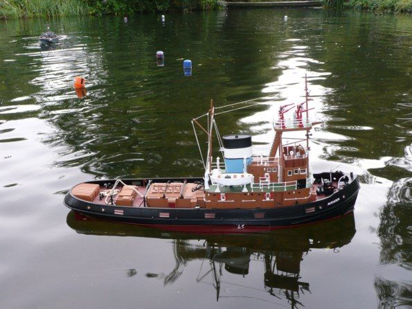

The 6v geared motor turning the large propeller proved more than adequate for the task, Photo 40. Turning circle with the rudder full over, was about 1.5 times the model's length. Astern control was very good for a single screw model and maximum speed was over-scale, so plenty in hand there.
Conclusion
A nice well detailed model with plenty of construction work to stimulate the model maker's fingers and brain and the parts and materials supplied were all of high quality. Yes, it is a single screw model, but it handled well enough on the water and of course there is plenty of scope for super-detailing, if the purchaser so desires. Price is £350 plus p&p, which is excellent value for money judging by the prices of some kits nowadays, but it is a kit for those with some experience within the hobby. It is only available direct from Metcalf Mouldings, tel: 01920 438686, website: www.metcalf-mouldings.com. Please see their regular advertisement in this magazine for further information about the whole product range.
A selection of detail, finished and on the water images of this impressive model are shown below.
