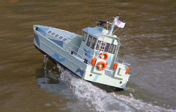

Photos 23 and 24 show the completed model from both bow and stern views, ready for on the water testing.
On the water and conclusion
I was not quite sure what to expect from the brushless motors and was more than surprised by the model's performance. To say it was fast is an understatement, even with the twin 3300mAH 7.2v NiMH packs, Photos 25 and 26. These battery packs gave a reasonable run time when alternating between fast and slow speeds on the water. A later change to 11.1v LiPo batteries gave the model even more speed and a longer run time as the motors were working even more efficiently. So yes, brushless is the way to go if you want speed with lightweight motors, but the downside is the cost. It does have to be said though, that if you use the Internet then equivalent motors and speed controllers may be found, and cheaper, but these motors and esc's as listed have proved just right for this model and as for the kit itself?
