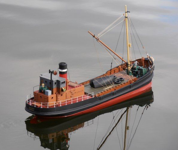

ALLAN MILLER builds the Mountfleet Models kit
This model has been around for sometime, but it remains popular because it builds into a nice practical size of model and there is plenty of scope to individually detail it and of course it can be either electric or steam powered, the later though requiring some ingenuity to get everything into the after part of the model. Length is 32 inches, beam is 8 inches and the scale is 1:32. Current UK price is £299 and it is only available direct from the manufacturer who regularly advertises in this magazine. I was therefore looking forward to building it because it makes into a detailed model without too much extra work and there is plenty of access to the hull interior in which to fit the batteries, motor and radio gear.

On the water, the model sails well, but it is not too good at reversing in a straight line which is not unusual for a single screw model. Being able to carry a huge battery capacity, means that this is a great model for those long sailing sessions on pleasant summer warm afternoons, Photo 25.
Conclusion
This kit builds into a well detailed model which looks the part both on and off the water. There is nothing particularly difficult in its construction and it has enormous scope for weathering and super-detailing. Recommended!
