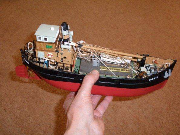

ANTHONY ADDAMS super details a 1:72 scale Model Slipway Puffer
When I first saw the Model Slipway kit for a 1:72 scale puffer, I immediately wanted to build one. When you see a puffer, it is instantly recognisable for what it is, namely a working vessel with loads of character. An added interest lay in wishing to add to my fleet already including the steam drifter Cosmea (also from Model Slipway) and tug Rana featured in July 2012 MB. The three models are seen together in Photo 1.
There are a variety of kits for puffers from a number of sources and those for larger scales are inevitably much more detailed than this small model from Model Slipway, which is just 13 inches long.
If the kit is built as supplied, the result will be a very nice and practical model such as this fine and neat working example by Stuart Underwood, Photo 2. However, I could not resist the temptation to add more detail to what is an excellent value for money kit. I will not deal with the kit assembly, which is fully described in its comprehensive included instructions, but rather describe my additions to this model. Small models suit my style of model making as in Photo 3!

The kit comes with the hull having a port and a starboard side moulding. Before joining the two halves, a 2mm sheet was added between them to provide a more prominent stem and keel. Also, so that the model will always stand upright on a flat surface, two bilge keels were added as in Photo 4. This is an added convenience, both during assembly and in operation as the model can be safely put down on any flat surface or worktop.
At an early stage, the hull was painted matt red, as I could not feel it to be right to have such a vessel in bare white vac-formed mouldings! Later, I repainted the red and marked the waterline with the pencil held in an adjustable workshop tool, as in Photo 5. The masking tape was applied just below the drawn line so the pencil mark could be rubbed away, prior to painting. Tins of Humbrol Matt Black do seem to currently vary from being very matt to semi-glossy. One such tin had a more glossy finish which was used to give an attractive finish. Okay, maybe not 100% pro-typical, but fine by me! This may not be really correct, but it is my choice.
The lettering for DORIS is from BECC lettering. A scalpel blade is the easiest way to extract a letter from the carrier sheets and place it into position, assisted by a strip of masking tape to ensure proper alignment, Photo 6.
