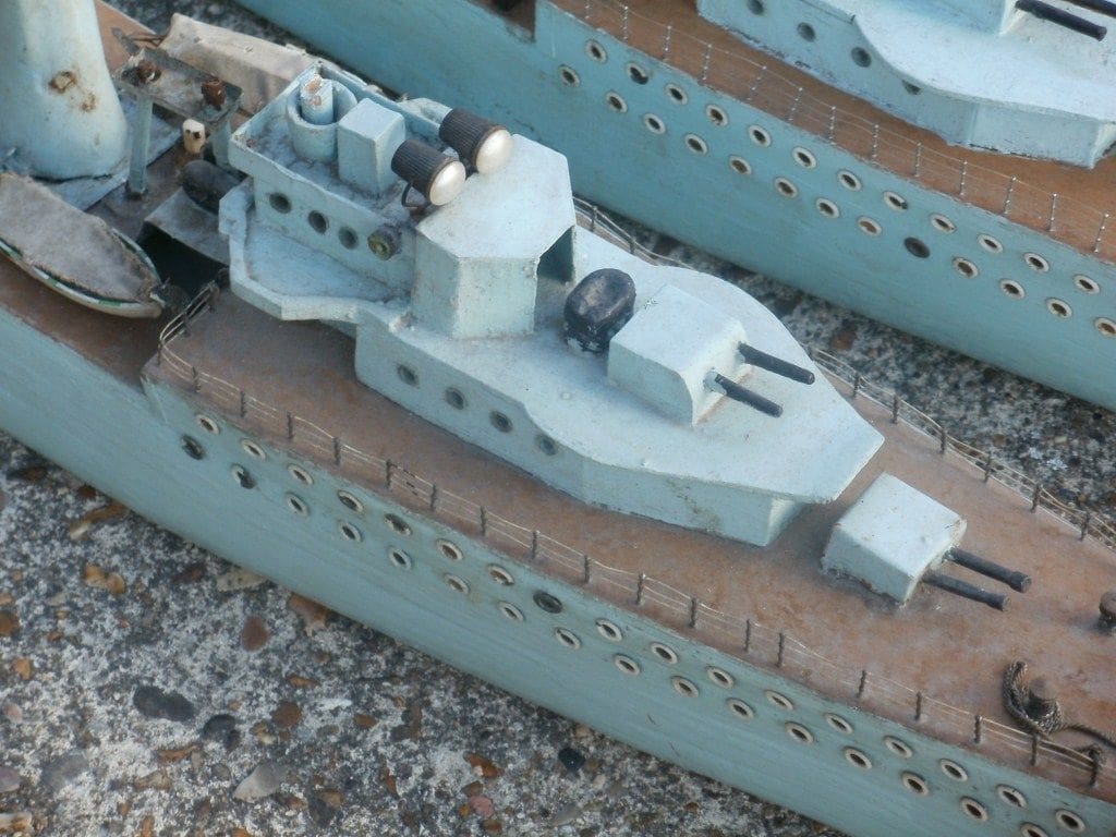

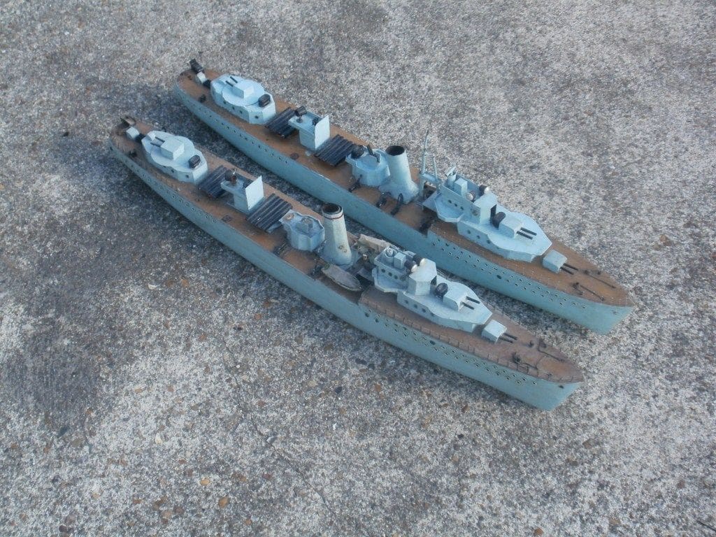

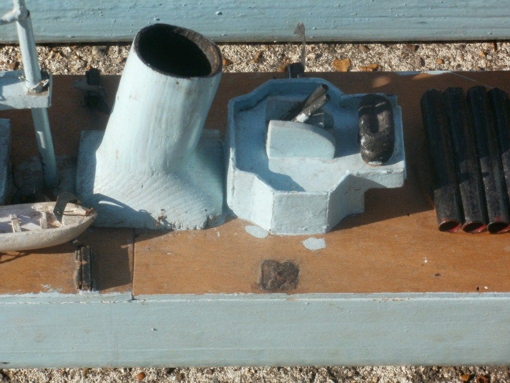

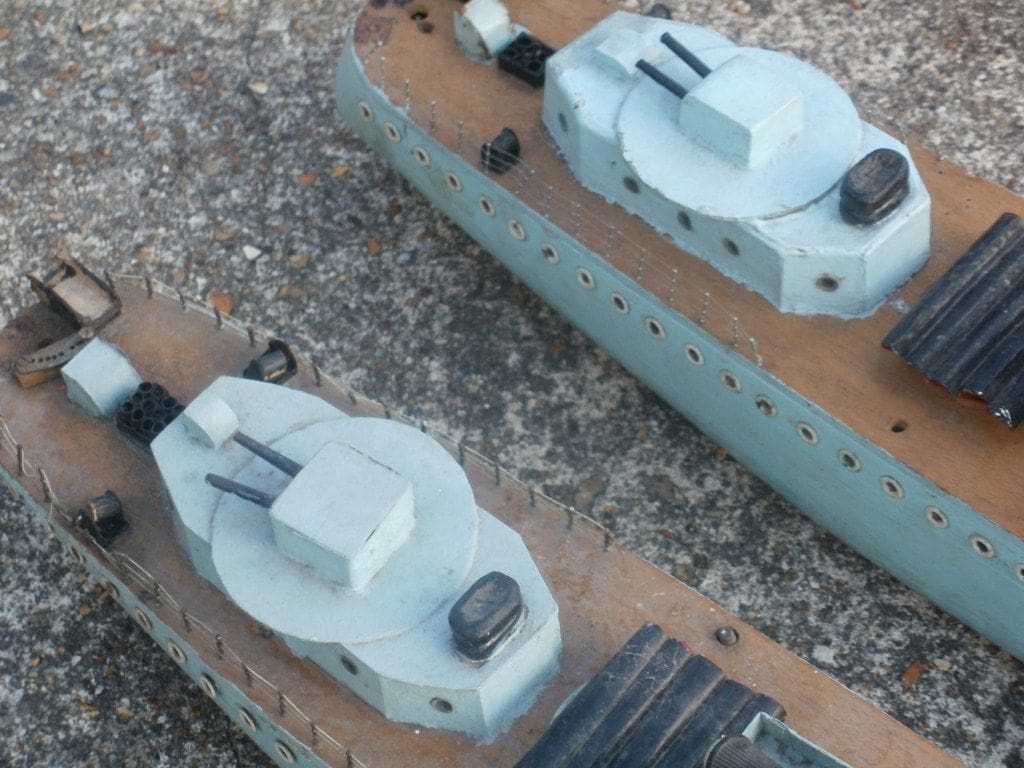

The models as purchased

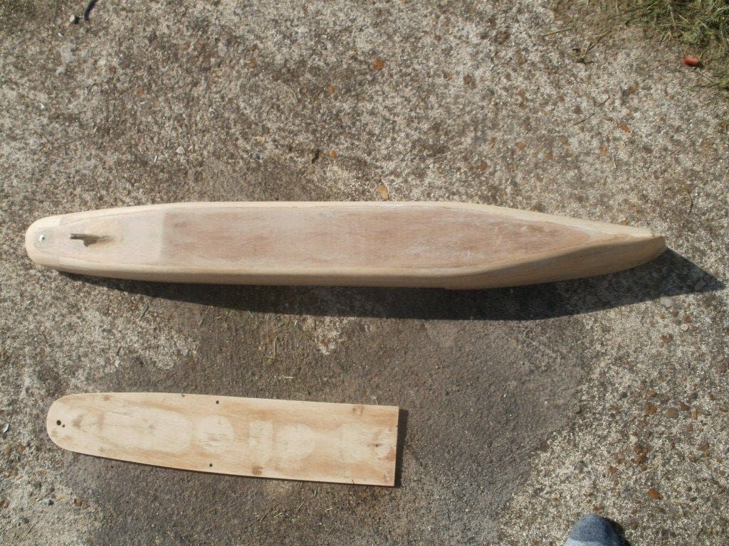

The hulls had been made using the plank on frame method and were quite sound although rough around the edges. The superstructures, as I found out later, were built up from a mish-mash of wood, card and tinplate. The torpedo tubes for example, were made from rolled card, whuch looked like old restaurant menus from an establishment in Glasgow! Perhaps a useful clue as to where they may have originated?
One of the funnels was made from rolled tinplate. The writing, although difficult to decipher seemed to come from some post-WW2 ration tins, thus also possibly a clue to when they were made. The other funnel had been carved out of a solid piece of wood.
Both hulls possessed single very heavy rudders and a single brass propshaft, each without a propeller and they were both without propulsion units which was a bit of a shame. A few days studying them and I decided that it would be better to replace completely all the superstructure components, tidy up the hulls and fit them out for modern electric drive and radio control.
The hulls were about 3 feet long. As the full size versions were about 350ft long we can assume a scale of about 1:100, which is approximate, but sufficient for our purposes.

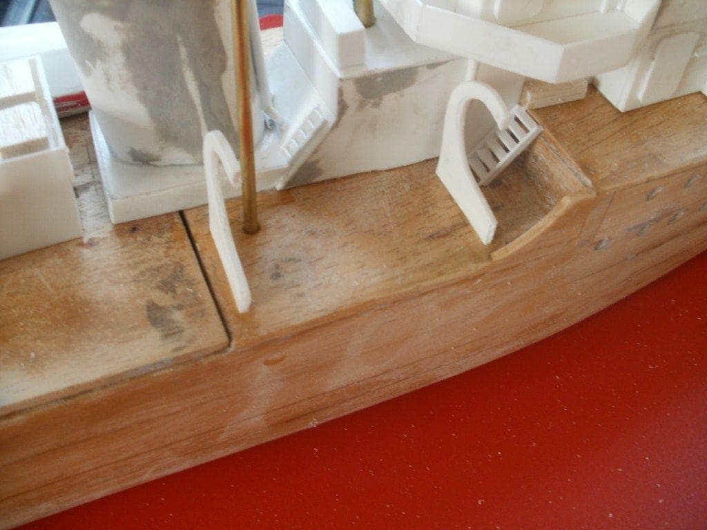

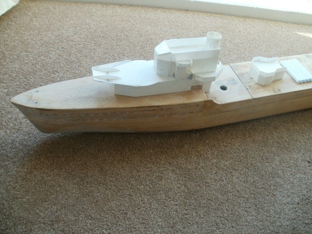

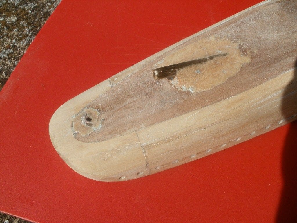

First, I set about these. The somewhat childlike portholes (which were probably eyelets) were prised out, but I still wanted portholes as they seemed quite prominent on the full sized ships. So, these were temporarily filled with cellulose body putty, allowed to harden and then partially drilled out with a 3/16 inch drill. Yes, slightly over-scale, but the result was okay and certainly better than before. This was only done on one hull as the portholes seemed pretty much in line but on the other they were somewhat irregular so those were just filled in. A tin of Nitromors paint stripper was purchased and applied to the hulls and the old blue paint speedily removed revealing the method of construction. More cellulose putty, wood filler and an electric sander were used to prepare the hulls for repainting. As mentioned earlier, they were relatively sound but quite crudely constructed, so they required quite a lot of work to obtain a decent result.
Unfortunately, removing the superstructures required brute force and resulted in damage to the decks which was rectified using cellulose putty yet again and as the decks would be painted rather than varnished, the finished result would be fine.
The break in the deck line amidships was angular, whereas on the J class the ship’s sides were curved. This was corrected by cementing suitable extension pieces to the hull and blending in with filler. Both hulls were then given a few coats of sanding sealer and thoroughly sanded ready for colour painting later.
Attention now turned to the rudders. The originals were heavy brass and steel affairs and although far from ideal, due to the very robust nature of their construction I decided to use of them anyway. New rudder arms were made from styrene and superglued in place. Each rudder arm was connected directly to a standard servo by means of a contoured brass rod as the hulls were of sufficient depth and beam to accommodate such an arrangement.

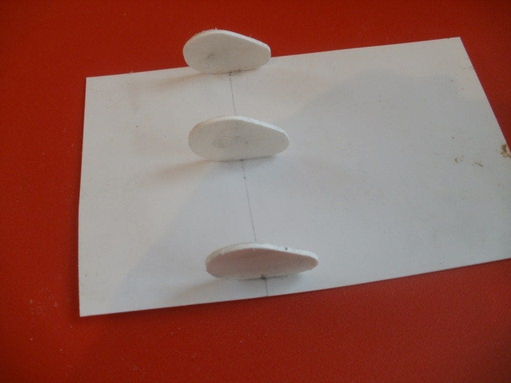

Both models lacked a propeller, so I had to guess the size of the originals. These were purchased from commercial suppliers and attached by screwing directly onto the propshaft, secured with a locknut. They are not exactly true to scale, but then little else is either! The propellers are actually twin bladed, but seem to work effectively.

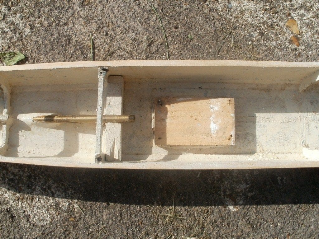

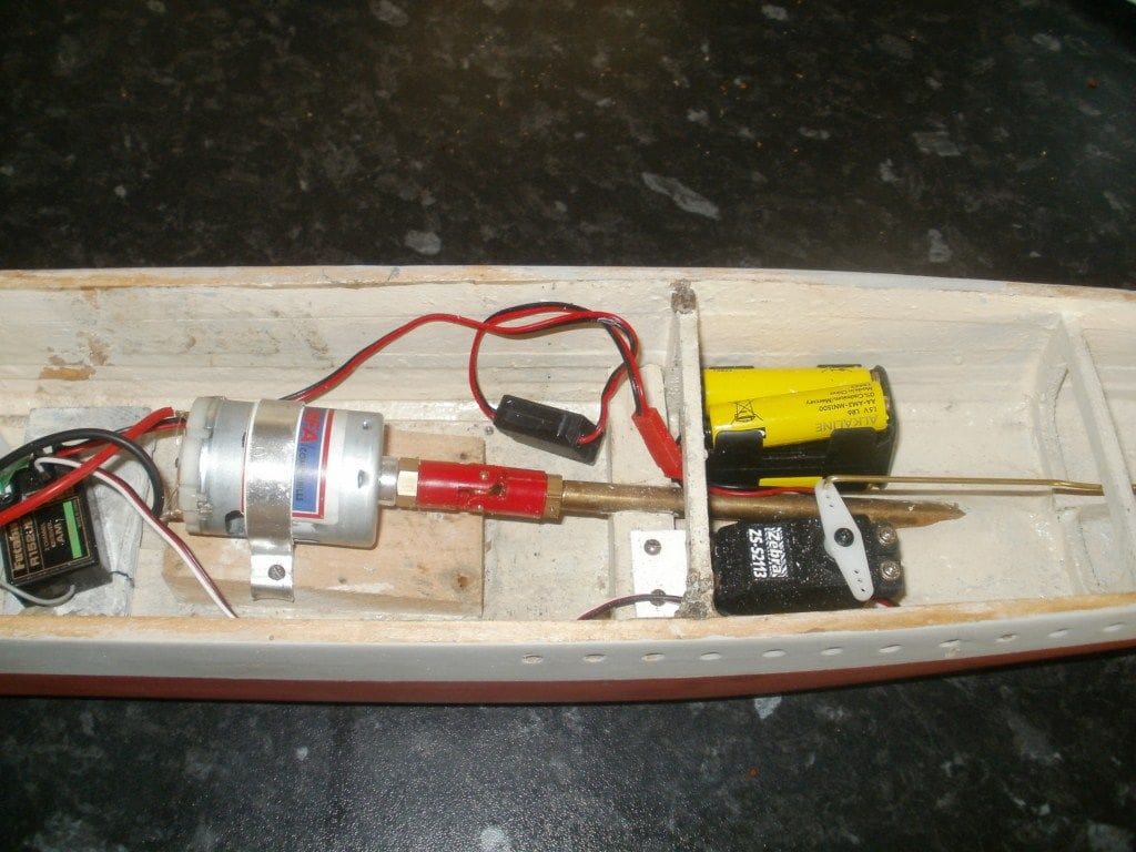

The original motors were missing and it would have been interesting to see what were fitted. Some ancient on/off switches were still attached to the hulls that gave some idea of each model’s vintage. The missing motors appeared to connect to the propshafts via dog drives which were also very heavy and I suspect would have produced a degree of imbalance. So, I installed a single MFA 500 type Torpedo motor in each hull which conveniently matched the new shafting that had been fabricated and installed. The internal motor mounting blocks still remained and as there was a certain amount of misalignment, these were removed and the new MFA motors held directly onto the bases with clamps from aluminium strip.
Each motor was connected to its propshaft using a commercial universal coupling, but it was then that I realised there was a problem with the propeller on one of the models, namely that it fouled the hull bottom. This is where it pays to observe and give proper attention when rebuilding a model!
When I stripped down one of the hulls there was a propshaft tube support which I had left off during reconstruction. I had not noticed that the angle of the new propeller shaft was now much shallower, thus causing the propeller to foul. The builder must have realized this as well and his solution was to extend the propeller shaft to produce more clearance, but requiring a propshaft support. So, I dutifully replaced the support as per original. Unfortunately, I had already made and installed a new propeller shaft which was of course too short, so a new assembly had to be prepared and machined on a lathe.
A nine volt battery appeared to supply more than enough power for the MFA motors and a nice little battery holder was made from styrene sheet. Having basically completed the innards I next turned my attention to the decks and superstructures. Before removing the latter, I had photographed and measured them for subsequent re-building. Once again a trawl of the Internet provided more detailed views of this class of destroyer, so although the same basic outline on the original models had been followed, I modified them further to follow a typical J Class destroyer outline. This rebuild was never meant to produce finely detailed replicas, just very simple, but semi-scale, models.

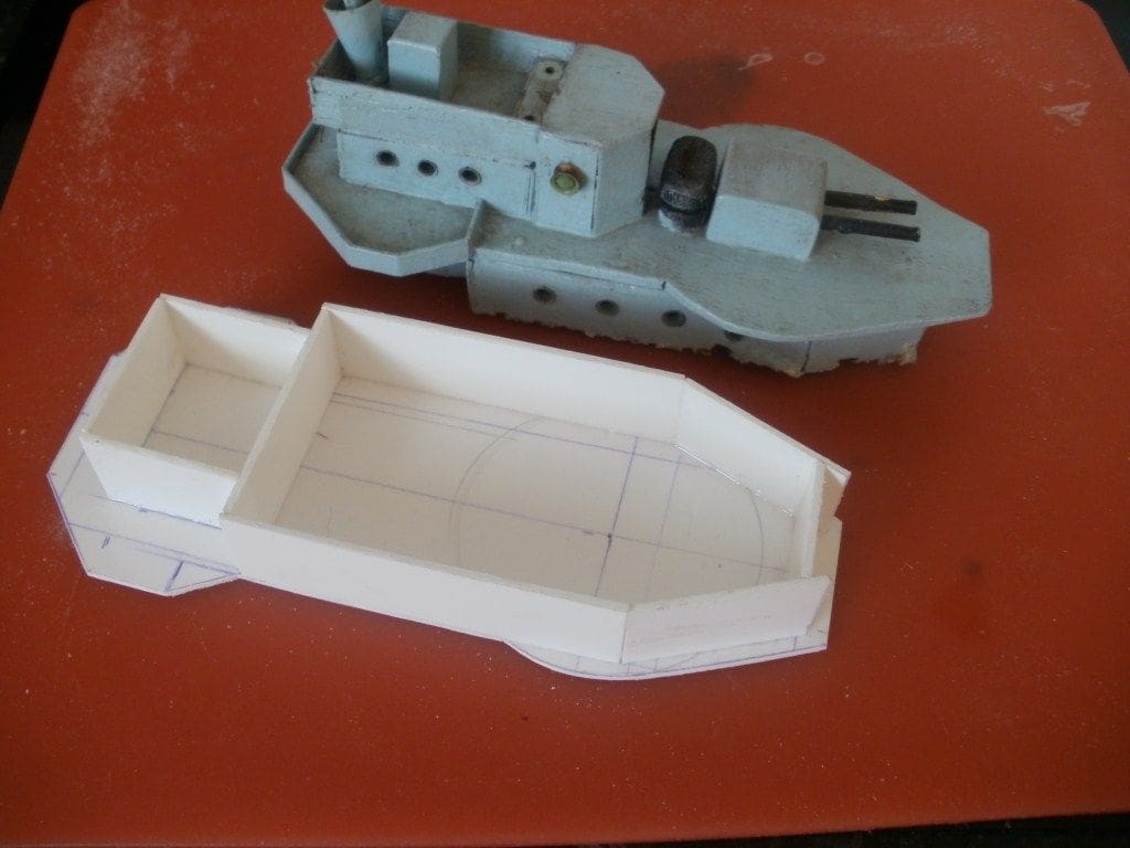

Superstructures

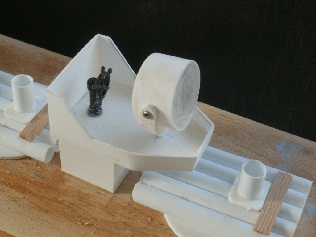

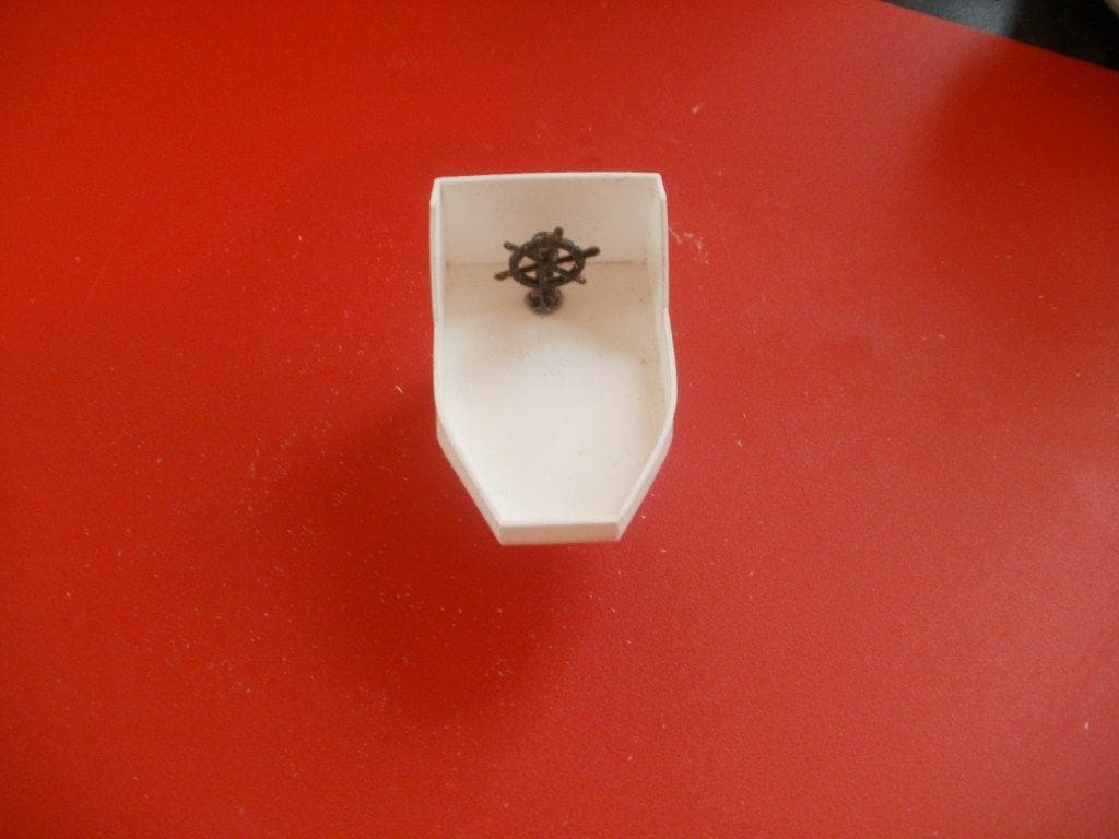

The basic structures were built-up using styrene sheets of differing thicknesses, all of which was very straightforward. This work included the main forward conning bridges, anti-aircraft gun platforms, the rear emergency steering positions and deckhouses.
I found that the easiest way to produce a vertical wall around a deckhouse was to cut out a suitable piece of styrene. then offer it up to an already cut roof. The first vertical angle bend was marked on the sheet, a line scribed and a cut made though about three quarters of its thickness.
The styrene could then be bent and offered back up to the roof and the next bend marked and the process repeated until all the bends had been completed bringing us back to the first end again. By doing it this way there were no gaps to fill on the vertical joints and it was actually very quick.

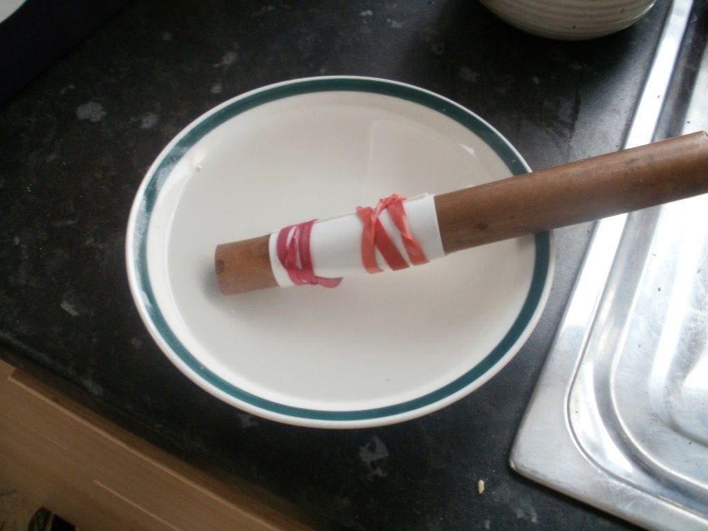

The circular mountings for the direction finders took a little effort to get a decent result. Thin styrene sheet was wrapped around a piece of 18mmm copper tube and held tightly in place with some plastic tape. Boiling water was then poured over it and the styrene sheet thus took up the diameter of the tube. The edges were fettled and adjusted for a good fit and glued together. This tube was then cut away so that it fitted snugly against the back of the superstructure and cemented in place. A small length of the copper tube was finally pushed into the tube to maintain the circular shape and also supported a floor which in turn supported the range finder which was fabricated from polystyrene tube.

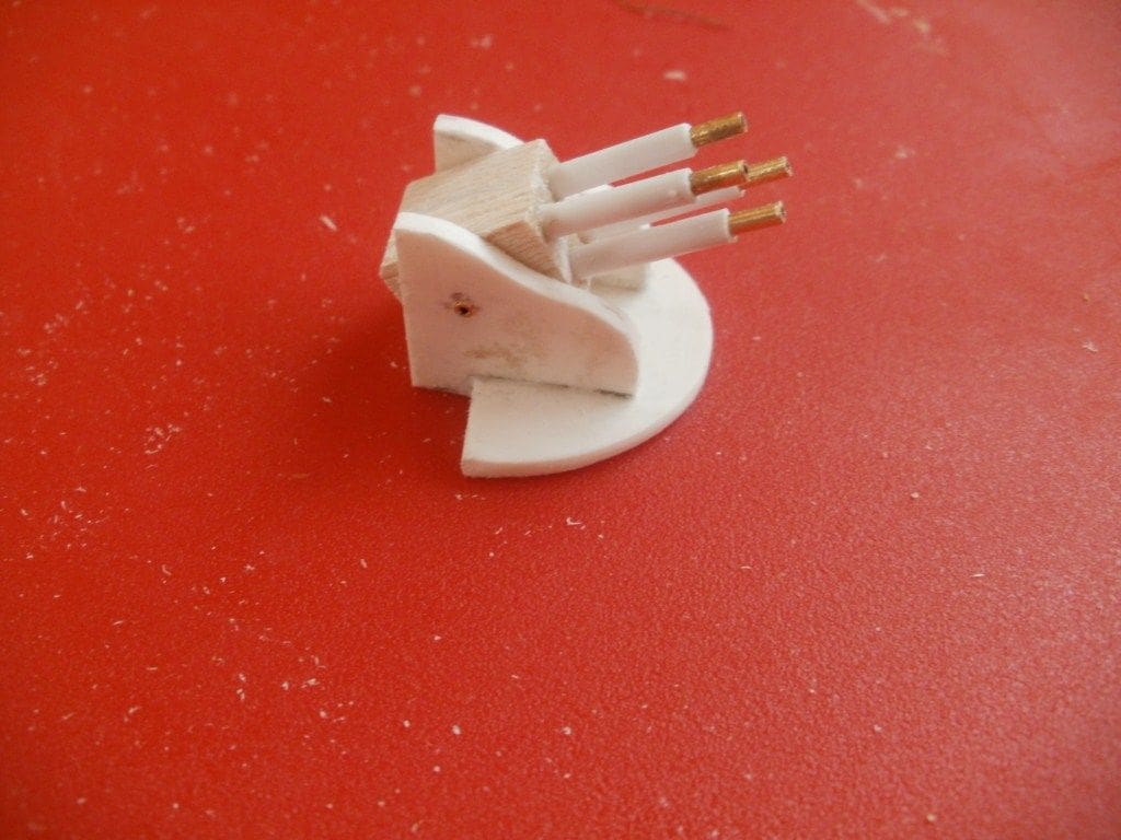

The J class destroyers were fitted with a quadruple version of the Pom Pom, but these models only had a very poor representation with just two barrels. My versions are not that accurate, but look okay and use the usual styrene sheet for the base and lower body.
The outer barrels were made from 1/8 inch polystyrene tube with smaller gauge brass tube for the inner barrels. The breech blocks were built up from 3/16 inch square balsa wood with the ends drilled to accept the gun barrels. They can elevate and rotate and look quite nice.

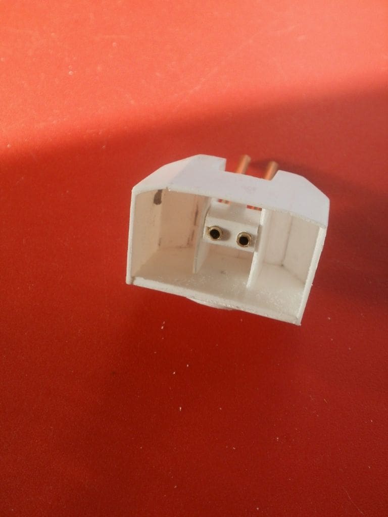

Twin machine guns were fitted either side of the forward bridge and these were constructed in a similar way. Short lengths of styrene tube were cemented together to represent the breech blocks and lengths of brass tube inserted to represent the barrels. The pivots were made from some rectangular styrene section cut in half and the barrels glued to them. The vertical mounting was made by sleeving some plastic and brass tube and gluing it to the base of the mounting. Each was then glued to the side sponsons.

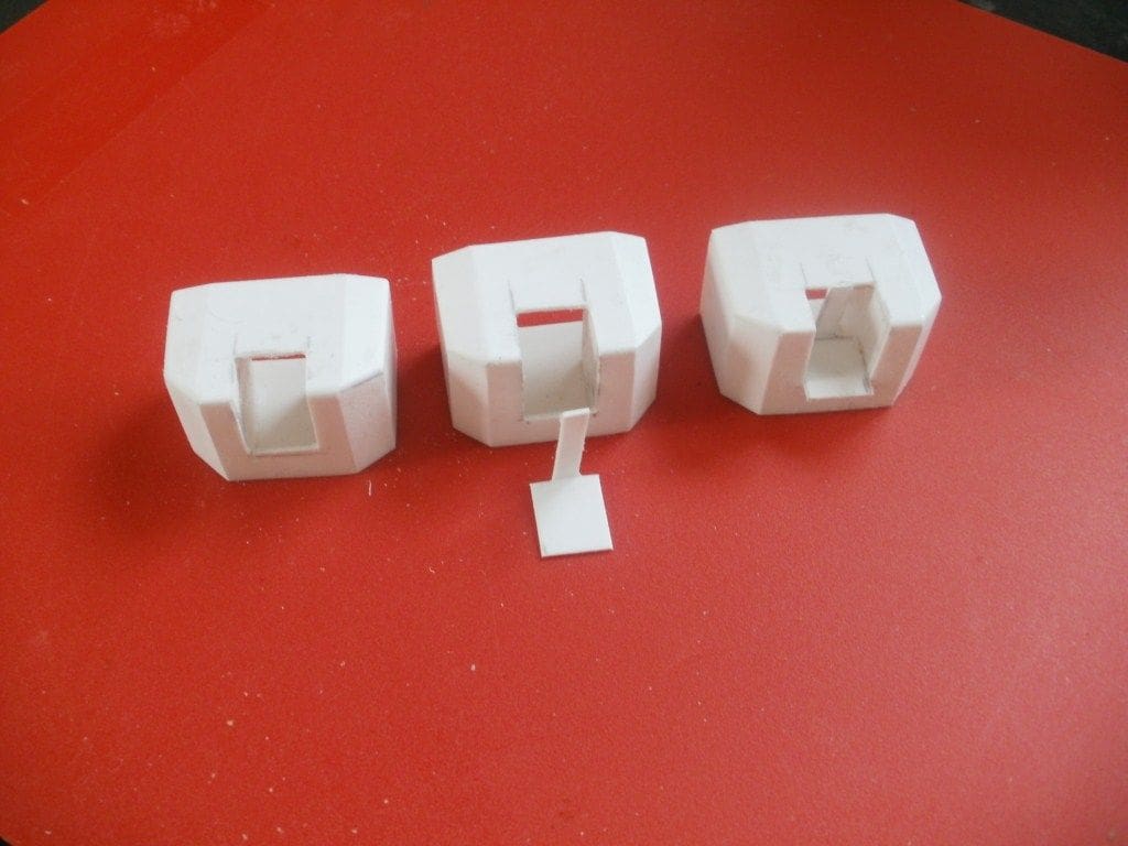

The J class destroyers were fitted with six 4.7 inch guns in three twin mountings. They were protected with shields, but could not really be called turrets as there was no rear armoured wall and the ammunition did not move with the guns, these being hand loaded. The mounting of the rear twin mounting was slightly unusual in that it did not face astern. It was mounted to face towards the bows and could not fire directly aft.
I made a start with the shields as the model guns were very poor and could not even be used as a pattern. So, using various photographs, I just guessed the correct size. It was too difficult to bend the styrene, so in the end a basic shape was used but angled rather than rounded corners were installed.

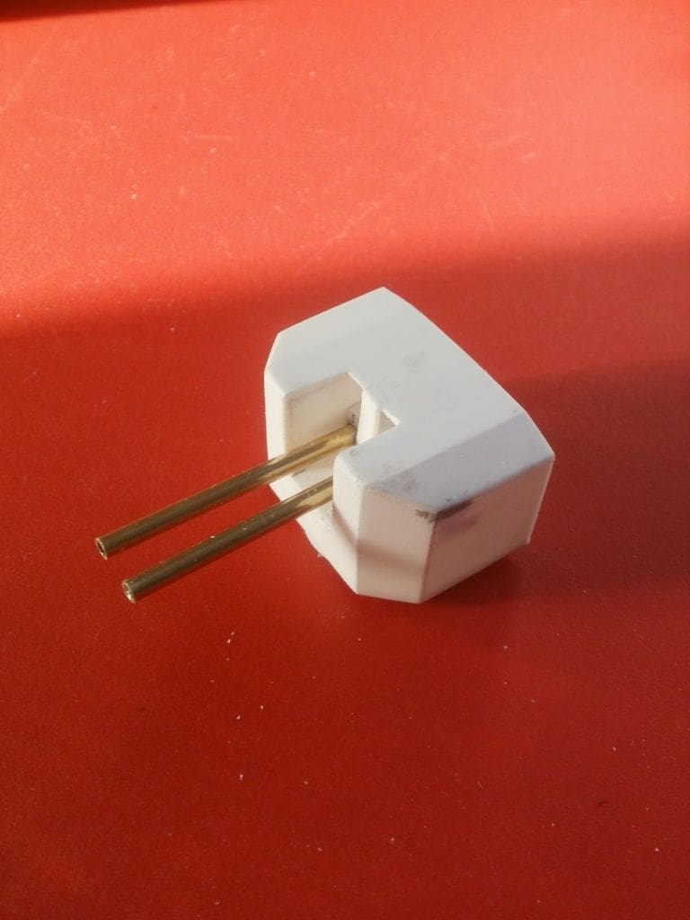

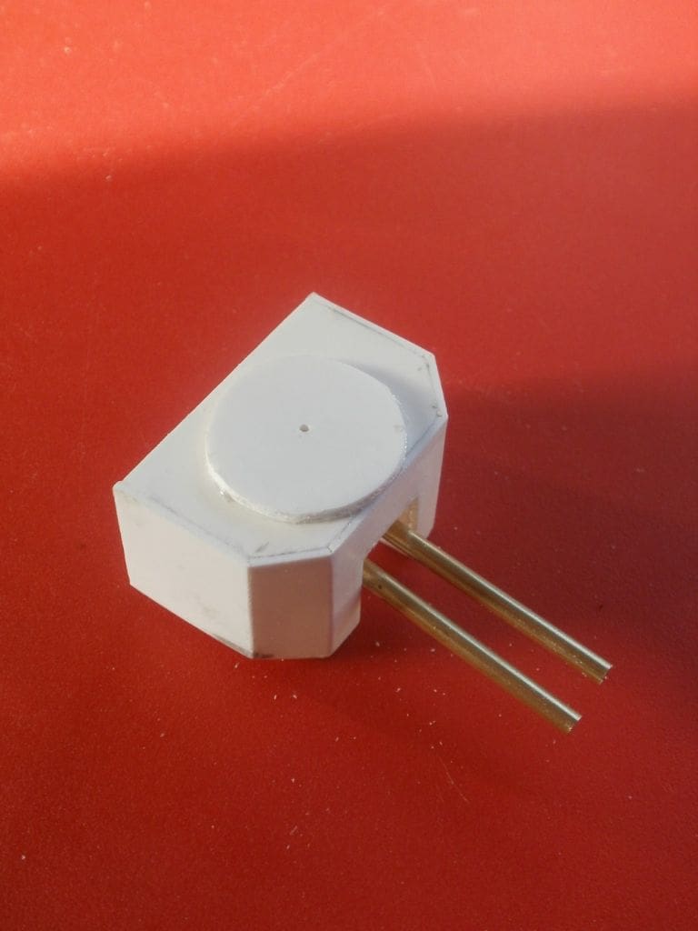

The main body of each gun shield was made in the same way as the sides of the superstructure deckhouses. Once the glue had hardened, an opening for the guns and internal dividing plates was made. After tidying things up I was quite pleased with the result, but as always repetition is a pain as I had to make six mountings in total for the two models.
The barrels were constructed from 3/16ins brass tube cut to length. There was no profiling and the breech blocks were made from rectangular section styrene. A length was cut that fitted snugly within the dividing plates and the position of the barrels marked. Suitable holes were drilled and the barrels pushed in and superglued. The complete units were then inserted from the rear and a spot of glue secured them in position. They cannot be elevated but do have a slight elevation that looks okay, however the mounts do rotate. For this, a support platform was cut from styrene sheet and glued to its base which was drilled centrally for a 6BA bolt. A corresponding hole was drilled in the deck. Depending on which turret, either a 6BA brass bolt was inserted from below or a length of 6BA threaded section glued to the deck, and the turret could be screwed onto it. Either way the turrets are able to rotate quite freely.

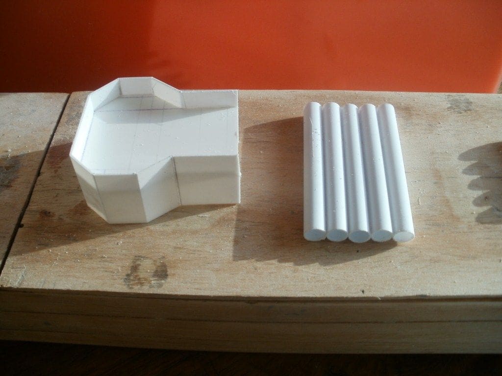

Torpedo tubes
There were two banks of five torpedo tubes on the original J class which were copied using 3/8ins styrene tube. The pieces were cut slightly longer than necessary and firmly cemented together and once set, were cut to length. The rotation platforms were cut from polystyrene sheet and again pivot around a single 6BA bolt. Additional detailing was added from styrene sheet.

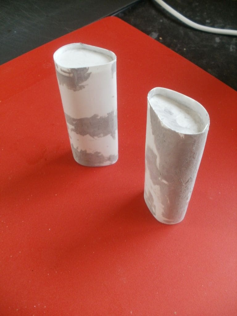

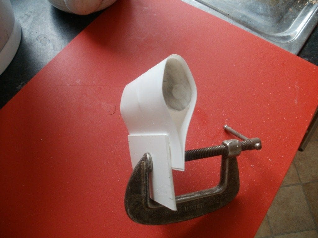

The originals were really not very good so new ones had to be made. There was a choice of materials, but styrene was selected once again as I was beginning to be quite adept at manipulating it.
Internal frames were cut to a profile that I thought looked about right. Very thin styrene sheet was then glued over these and this had to be done in stages. To attain a nice smooth surface a considerable amount of filler had to be used. This was because the sheet was so thin it was dissolved by the polystyrene cement and the elastic bands I used to hold it in place cut also cut into its surface. So, another lesson learnt! Always use the thickest sheet that you can manipulate to avoid this problem.
The funnels were supported on a small box like section that was cemented to the rear of the main superstructure. There were two steam lines that passed up the front of each funnel. I think that these were the safety valve exhausts from the main boilers and were represented using styrene tube cut, bent and glued in place.

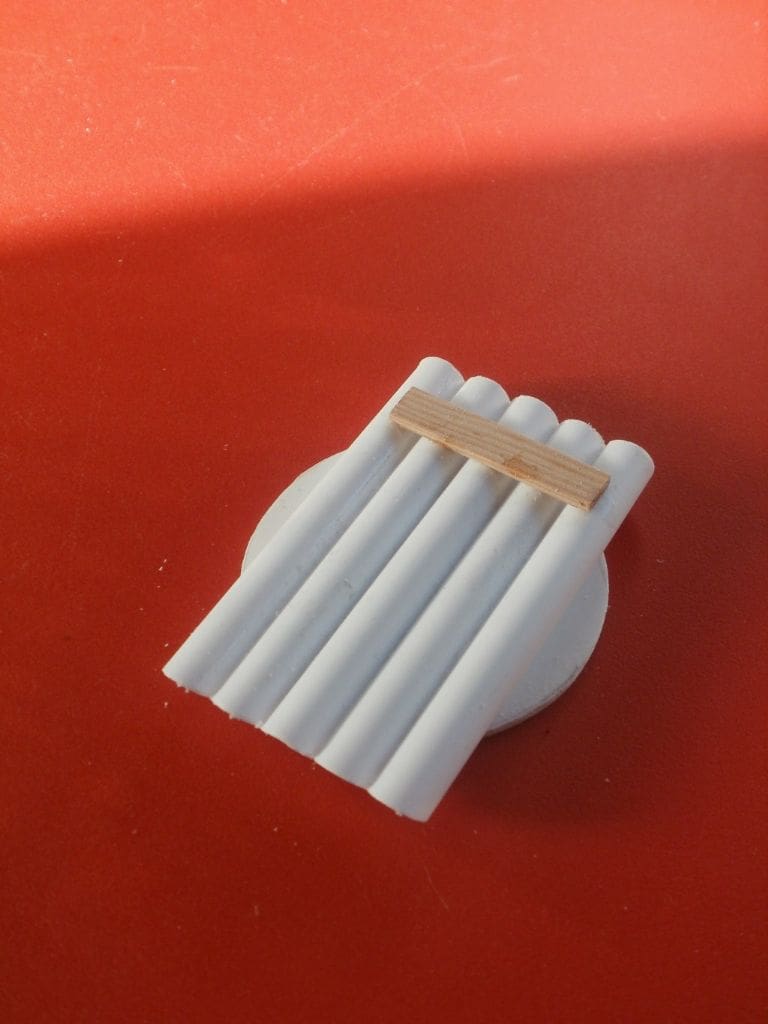

The liferafts were an interesting challenge. 3/16ins styrene tube was cut to length and assembled to form a rectangle. A floor from thin styrene sheet was then glued underneath this rectangle and the edges rounded. The end results looked something like liferafts which were glued to the sides of the front and rear superstructures.

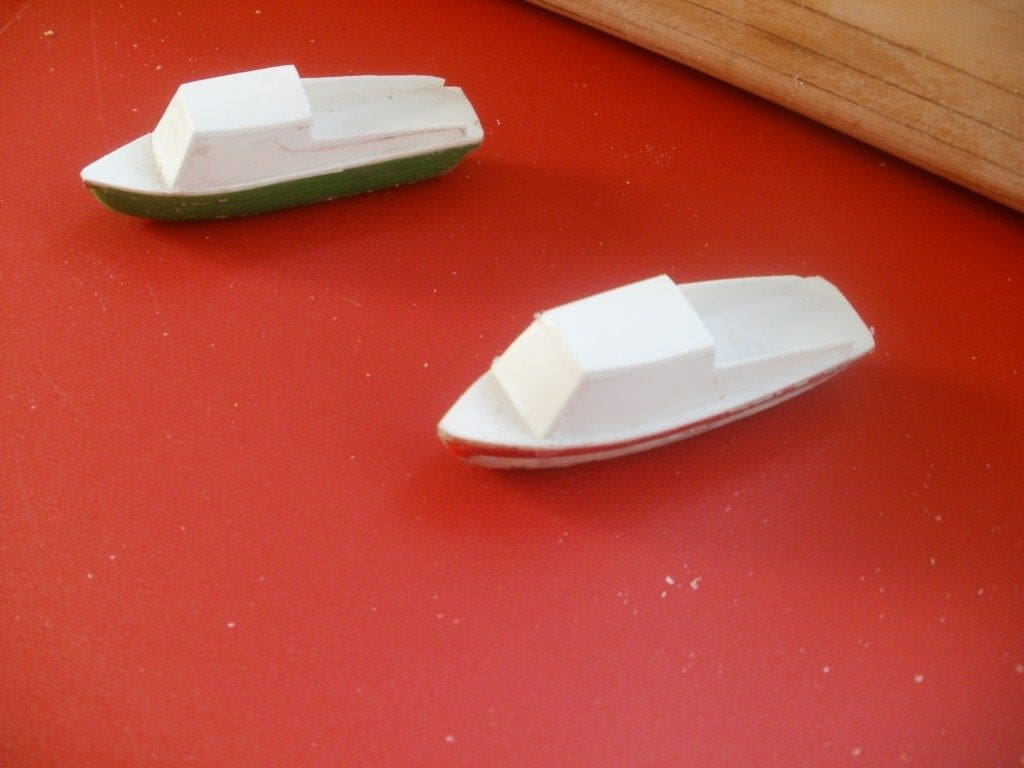

The ship’s boats were a bit of a problem as those that came with the models were incomplete and not very good either, so what to do? To start with, the davits were constructed from styrene sheet. I think that the original vessels would have had perhaps four boats, but I felt that two would suffice as these were just semi-scale models. Two, which were just open rowing boats, were selected from the original un-restored models. Decks and cabins were added, thus giving them the appearance of motor launches and they were glued directly to the davits with dummy support ropes. The other pair of boat were made by modifying some from a Revell Kearsarge kit. Now, the bulk of construction was complete, the models just needing odds and sods such as anchors, rigging and railings to be added.

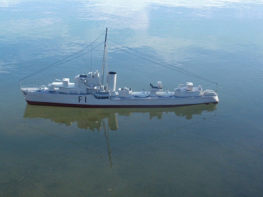

This had not been done as work progressed, so it was now time to paint the models. Fortunately, being not too detailed, this was straightforward enough. White Ensign Models, WW2 Light Grey was used for the hulls, weapons, detailing and superstructures, with a darker grey for the decks and the below waterline anti-fouling in the usual red.
Sea trials and conclusion

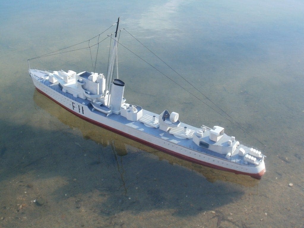

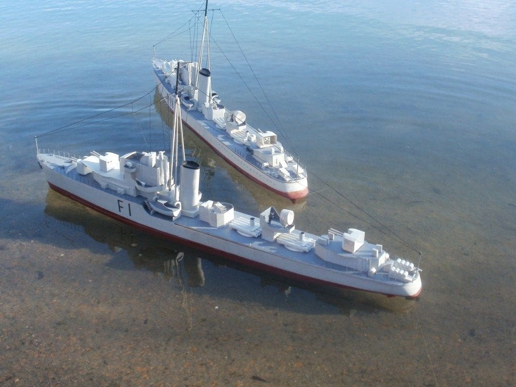

It was then time to give them their first sea trials. The original models had heavy lead ballast weights but I suspected that yet more weight would be required to get the correct displacements. The usual bath trials and necessary corrections were made before setting of to the pond and it was surprising how much ballast was actually needed to keep them upright. I can only assume that as originally built they must have been very unstable.
By using the same r/c frequency in each boat and operating only the rudders I hoped to be able to control both boats with the one transmitter and at the same time for a sort of squadron sailing. The theory sounded fine but I did wonder how my brain would react to having to coordinate two boats with just one rudder control! To date this has not been tried properly – I rather suspect that each model will perform slightly differently and very rapidly they will be going in different directions and be at opposing ends of the pond.
Anyway, I have to say that the end result was actually two rather attractive semi-scale destroyers. Yes, somewhat simplistic in design, but overall not too bad and I was (and am) happy, which is the main thing.
