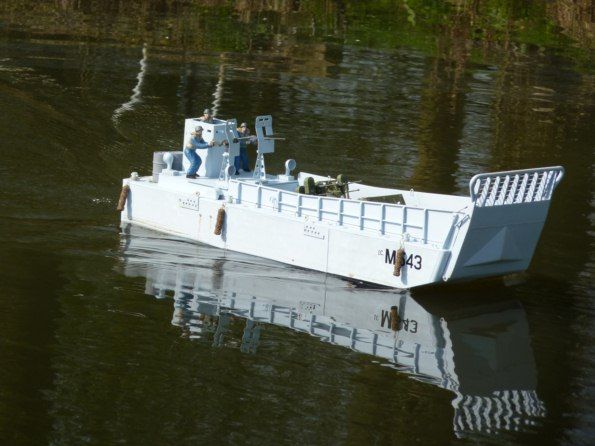

Putting everything back together and gluing the fittings in place was only a couple of evening’s work, so with batteries charged and final checks completed it was off to the lake with our Editor for sea trials.
Performance was good and not too fast but with a realistic top speed. It manoeuvred well and with the aid of the micro-switches it could nearly turn on the spot. Because of the blunt bow, I thought water may have entered the tank deck through the small gap at the bottom of the door owing to the bow wave. Surprisingly there was absolutely nothing and we would conclude the design of the whole thing is such that the pressure of water is deflected away from the door hinge area. Now for the bad news!
Things were going fine for the first ten minutes when performance markedly declined and after another five minutes the model was removed from the water. On inspection, the motors were too hot to touch and the battery was flat. Everything was free turning, so it was the motors that were at fault. As it turned out, I had installed 545 type motors with a maximum efficiency drain of six amps. A couple of low drain Caldercraft CEM550s type, drawing only one amp on no load at 8.4amp and rated for 2.4v to 12v, were obtained from Cornwall Models and solved the problem. It was not an easy task extracting the high drain motors and replacing them, but it was done with a few curses along the way. A few days later we were back at the lake and this time also with Paul’s LCM 3. Speed was the same, but battery longevity much improved and after 40 minutes the motors were almost cold and the battery still had capacity, Photo 55.
