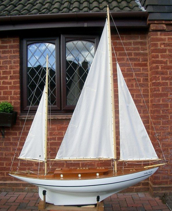

The sails were made from lightweight linen, purchased from John Lewis, the seams being double sewn and fitted with eyelets. These sails were lashed to the masts and booms in a style consistent with the age of the ketch, Photo 6. It was decided to maintain the historical integrity of the original ketch and not fit full modern radio control, so only a steering servo has been installed. Sally Slade was finished at the end of 2010, Photo 7, and she was later successfully sailed, Photo 8 at Walpole Lake, Gosport, Hampshire in August 2011.
