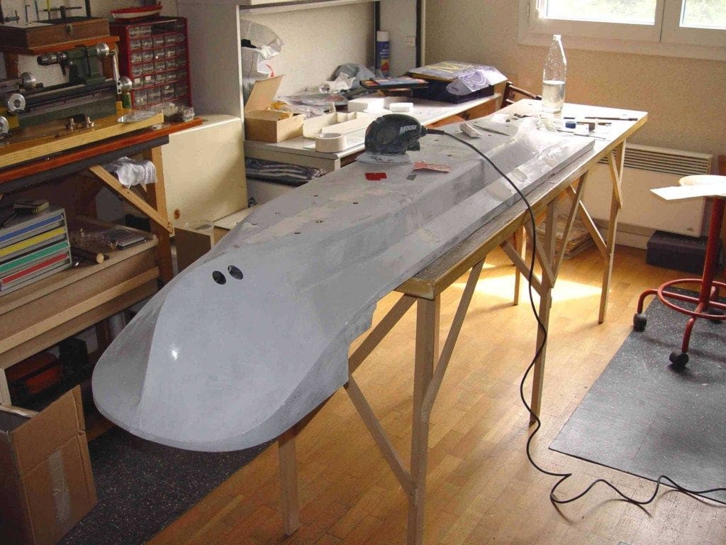

This was in two halves. Why? Well, yes it is only 1.8 metres long in total, but it is very cumbersome and awkward being 0.4 metre wide. So, being in two halves meant that it would be easier to transport and manage.
The hull is of GRP, laid-up in moulds prepared from masters of the forward section; the parallel central part and the stern section and its two propshaft fairings.
Using GRP takes time, but it’s worth the effort as the actual hull parts are then strong and unencumbered by internal ribbing. It is of course also possible to make more hulls from the original mould if required. A slight drawback was that the three GRP sections had to match up to each other perfectly and two permanently joined to each other, so some fettling on the GRP mouldings was inevitably required. I prefer standard polyester resin, even though it has an odour that some find is distinctly unpleasant. An alternative is a specialist epoxy resin, but that it is more expensive and will usually cure more slowly unless in a vacuum tent or similar.
The bottom of the hull was ‘laid up’ quite thick (about 2.5mm), with the sides thinning a bit for the upper hull parts.

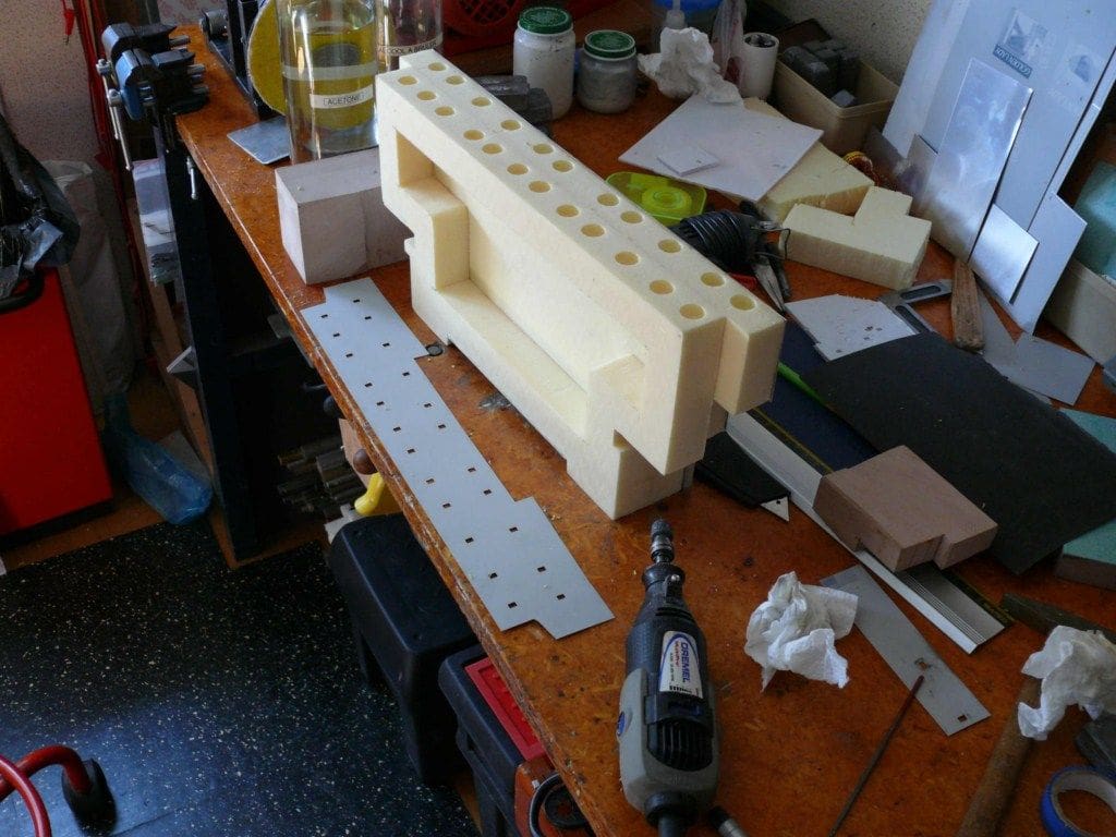

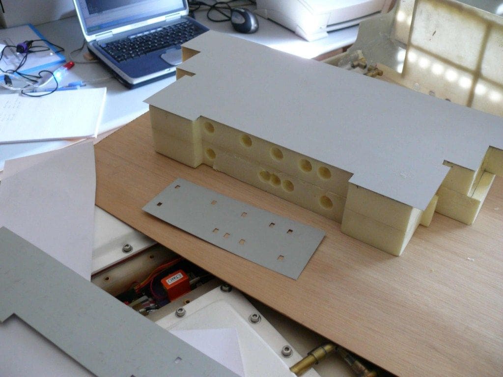

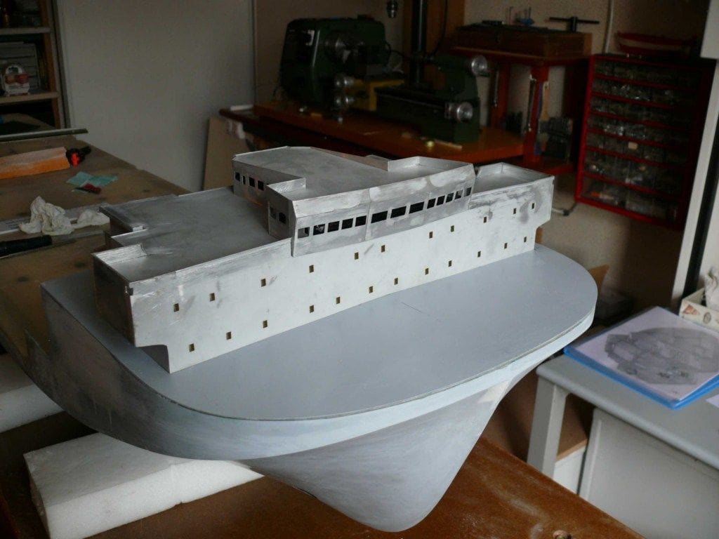

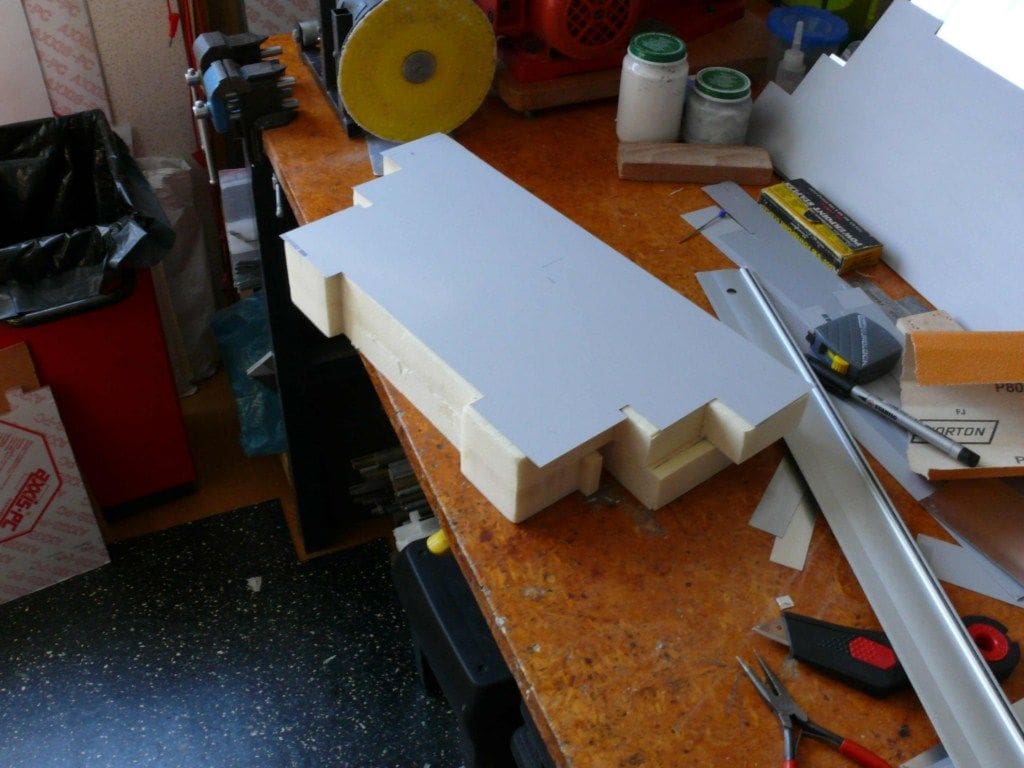

This is all on the forward part of the hull. As it had to be as light as possible, I thought I would make it of litho plate (which is very similar to aluminium) and is used in the offset printing business. One of my friends at the club was such a printer and had numerous redundant sheets suitable for my purposes. Trouble was, that it had to be glued as soldering was out of the question. You can create superb shapes with litho plate by scoring and folding it, but it is still quite fragile and is very prone to denting.
So, the whole superstructure was built around a hard polyurethane foam core, of the type used to insulate houses. Slow setting epoxy was the adhesive of choice and it worked well, the result being a very light, hard and smooth skin over a foam core, which meant it would also float.
At each point corresponding to a window or porthole, a small indent was machined into the foam to give some depth to the opening.

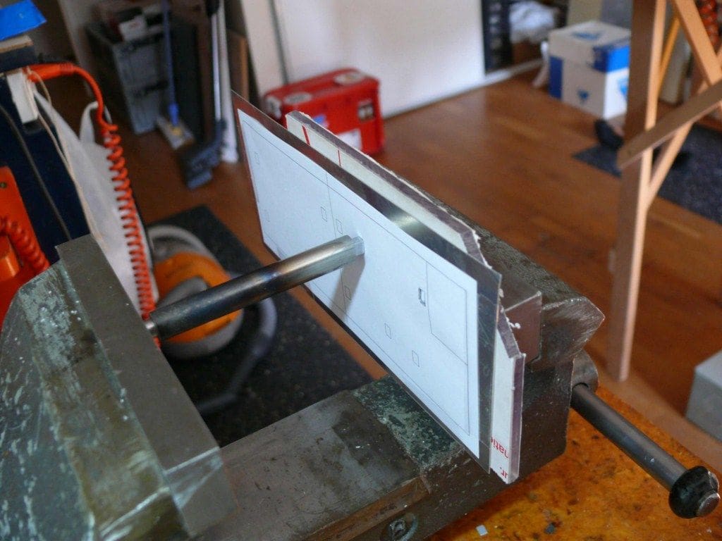

Making the window openings in the litho plate wasn’t easy, but an especially prepared punch pushed into the litho plate (which was supported by a polycarbonate backing piece) did the trick.
To achieve neat and properly aligned cut-outs, a template was generated on a computer, printed and temporarily held by Sellotape over the litho plate. There is no doubt that using dense polyurethane foam as the backing for the superstructure outer skins and decks, worked well.
