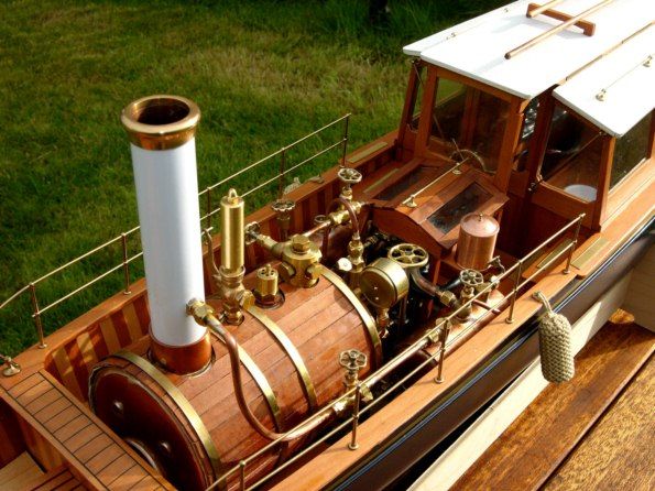

On the port side of Topaz sits the steam condenser and separator tank which as the name suggests, separates the exhaust steam from oil, retaining the oil and feeding the exhaust steam to the funnel. This tank (also supplied by Maccsteam) can be seen at the side of the engine at the top of Photo 10 (the gas tank is on the starboard side at the bottom of the picture). Although not essential, the separator tank is a positive thing environmentally and should be included in the steam plant if at all possible.

Below are some further photos showing the detail of this lovely model.
