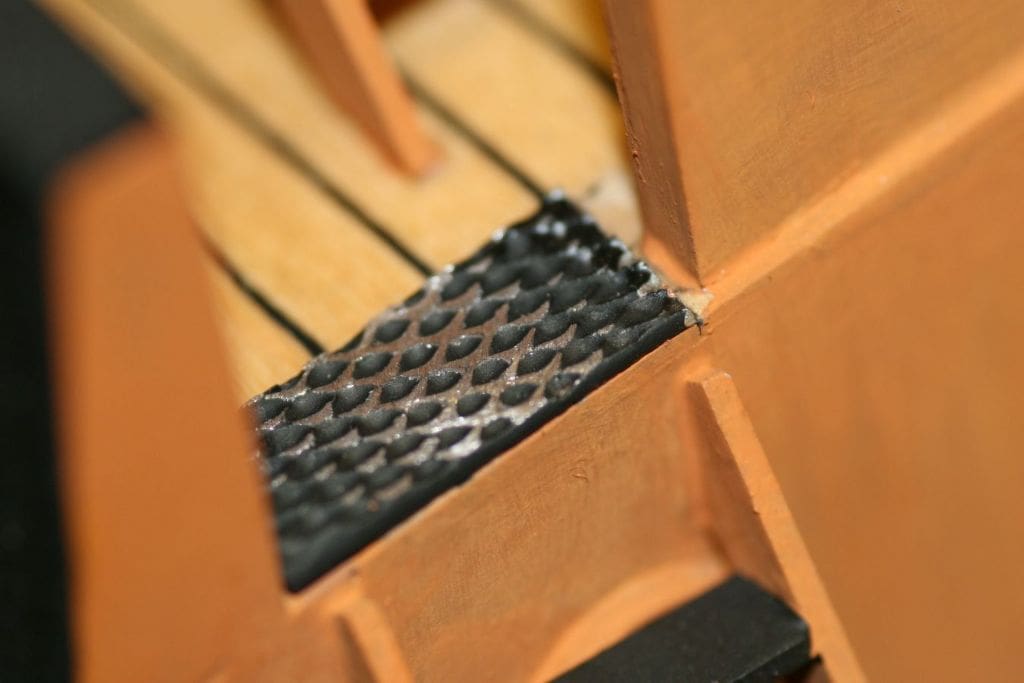

Let’s start by considering a set of steps on the outside of a vessel. As the vessel ages, the treads of the steps could well become worn, so whereas they may well start off as neat square treads of chequer plate, they will wear in the centre. If they are steel treads and the parts on your model are in white metal this could be recreated quite simply by painting the treads then gently rubbing the paint away in the middle with a small piece of very fine wet and dry abrasive, Photo 1. If they are a wooden tread and your steps on the model are wood then exactly the same technique will produce similarly realistic effects. If the real steps are steel and your model steps are made of wood then you might want to try painting the wood with a gunmetal or metallic grey paint before applying the top coat and then again gently rub the top coat away with wet and dry to expose the metallic paint. Similarly the handrails will be worn and the paint could well have started to rub away, so once again a gentle rub along the top with some very fine abrasive will remove the paint and reveal the metallic surface below. An interesting effect to try out if the top coat is a matt finish is to gently rub a soft pencil along the top of the handrail. This leaves a very effective metallic finish which can of course be very carefully controlled and has the big advantage of being removable if you are not happy with it. Once satisfied, simply seal it with a clear varnish to prevent it being rubbed off.

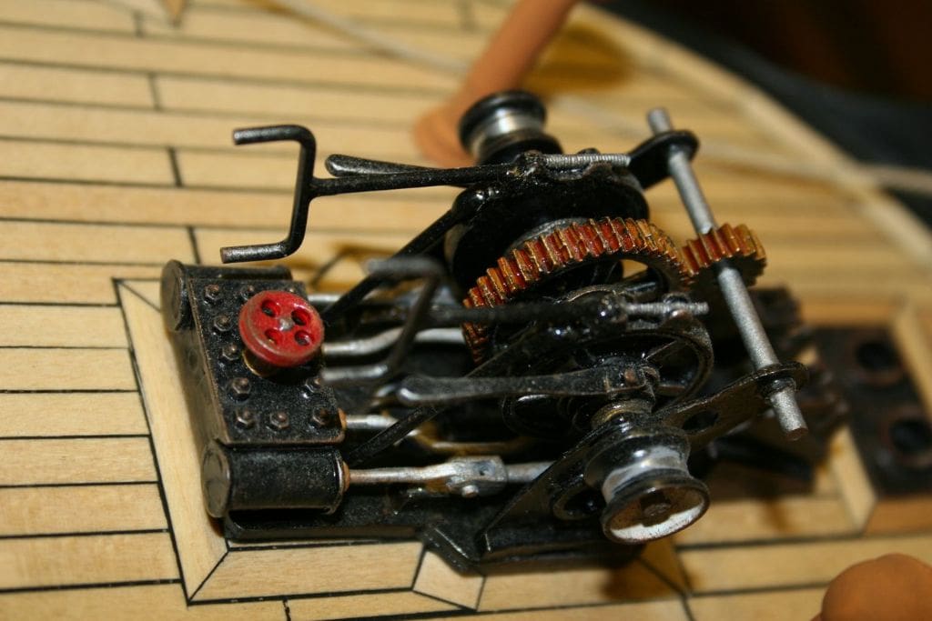

Deck machinery is another area that demands a lot of attention to see just where the opportunities for weathering exist and again they are all as a result of general wear and tear, Photo 2. Anything that involves human interaction such as handles and foot pedals will show signs of paint wear, but you will also see the effects of oil and grease on gears which could be recreated with the application of appropriate colour paint as well as the effects of maintenance such as panels that are removed regularly. These could well look scuffed and have chipped paint around the edges and around fastenings.

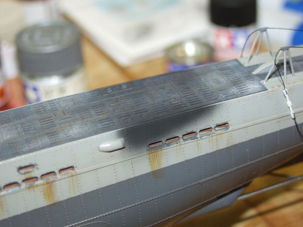

Although relatively specific, this is one of those areas of weathering that just about everyone has had a go at some time or another, probably with varying degrees of success, yet it is almost certainly something you will want to consider on a weathered model. All ferrous materials rust and when they get into contact with salt water they can rust very quickly. Maintenance of any vessel invariably involves fighting rust where ferrous materials have been exposed to the environment and adding rust to your model has to take into consideration the type of vessel, its operation and its possible maintenance regime.
Ship’s construction as with everything else is a compromise between cost and quality. Non-ferrous materials, whilst offering long term advantages with maintenance, usually cost considerably more in the first place. Consequently, although you may find brass ports or stainless steel fittings on some vessels, you will almost certainly be dealing with cast iron winch gear housings, bollards and steel hulls on a lot of them. Do your research though and don’t get carried away. Aluminium hulls and superstructure do not rust, so adding the effect will only look very wrong and adding rust steaks to stainless steel fittings will look equally odd. Steel superstructures, cast iron fittings and steel hulls are however all fair game for a bit of iron oxide.
Rust can be applied in many different ways and most modellers have their own favourite. I know there are those out there who make their own real rust from corroded iron filings, but the important thing for me is that rust is never one consistent colour, so study it on ship pictures, Photo 7. It is always built up over time with the various stages of the corrosion and tends to be darker the older it is, and a brighter orange in a newer state. Ideally your rust application should reflect this, so don’t restrict yourself to a single colour. I always use the technique described earlier with enamel paints and have a palette to hand with blobs of brown, purple and bright orange on it. These three in various combinations generally produce the range of colours you are after. I tend to apply with the dry brush technique and regularly vary the mix of colours. The end result is that you should be able to make out distinctly different colours in the rust effect. Another consideration with rust is how it forms and therefore where you will put it. Although sometimes spots do appear in the middle of a plate for no apparent reason, much of it forms as a result of water flow. Consequently where water flows over the edge of hull features such as rubbing strakes, around fairleads and hawse pipes etc., you will frequently see streaks of rust at these points, Photos 8 and 9. Dry brush the rust in vertical applications in line with the flow of water and always vary the density and colour of the paint. When you have finished with the enamels it may be worth considering adding some dry pastels to give the effect of a texture and to further introduce some varying colour shades.
Another variation on this technique, and one that you may want to use in conjunction with it, is to apply the colour then go over it with a flat brush loaded with thinners only to further streak and water down the opacity. I have seen this method used with oil paints that are then streaked with turpentine, which works extremely effectively and the additional drying time you have with the paint can be used to add pigment powders or pastels.
There are also specific products on the market that are designed to give your model a rust effect straight out of the bottle. Some of these are more effective than others, but invariably most of them are nothing more than a rust coloured wash that you paint on and build up to create an effect. Again I would suggest the introduction of additional colours on top of these products to get away from the single tone that they generate.

Talking of soot, you will not find an engine exhaust that does not have soot around it, be it from a diesel, petrol or coal fired engine or a boiler, Photo 11 (the exhaust is in the side on the casing). Applying a degree of soot to the area works wonders bringing a level of realism to the model, but unfortunately it is the one substance that really has to be applied with an airbrush. You may be able to get away with a mini-spray can if you are careful on a larger scale model, but an airbrush does make life a lot easier. Some people would not consider purchasing one for single use, but perhaps when you get to the stage in your modelling when you want to experiment with new techniques and you decide to purchase one, the application of soot will be a perfect use for it. As with all weathering I try wherever possible to emulate real life in the way it is created. Painting with a small flat brush rather than spraying gives a much more realistic texture and creating the salt puddles is following the same process that creates the effect in real life. Similarly with soot, the only way to get the realistic sooty effect is by careful building up with a number of layers of airbrushed matt black paint. Also remember the effects of the exhaust on the rest of the ship and not just the funnel as well as bearing in mind the combustion process. Old coastal steamers were notorious for poor combustion, so they would tend to produce not only a lot of soot around the funnel top, but this would quite often be all over the aft mast as well. This is, of course, exactly why a lot of them were painted black, but quite often the soot would cover a wider area, Photo 12.
