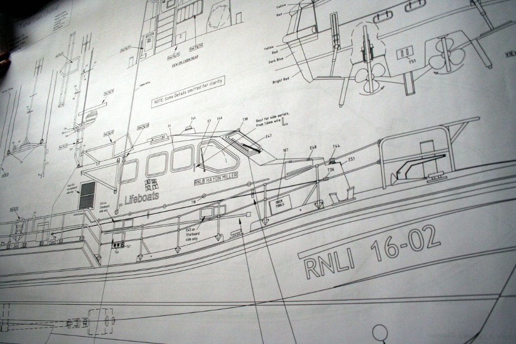

With the exception of fibreglassing work, just about everything is done on site. A new kit can take between two and three years to bring to market and as you might expect, it all starts off with the drawings. Many of the Model Slipway range are vessels which have been recently constructed and permission is needed from the owners before work can begin. The main source material will be general arrangement plans of the full size vessel from which Lawrie will develop a CAD (Computer Aided Design) file which will be used as the source data for the kit in order to program the computerised printing and routing machines which actually produce the main kit components. Hull lines drawings enable Lawrie to construct a plug which is used to make the master hull moulds from which the GRP hulls are laid up or the styrene ones moulded.

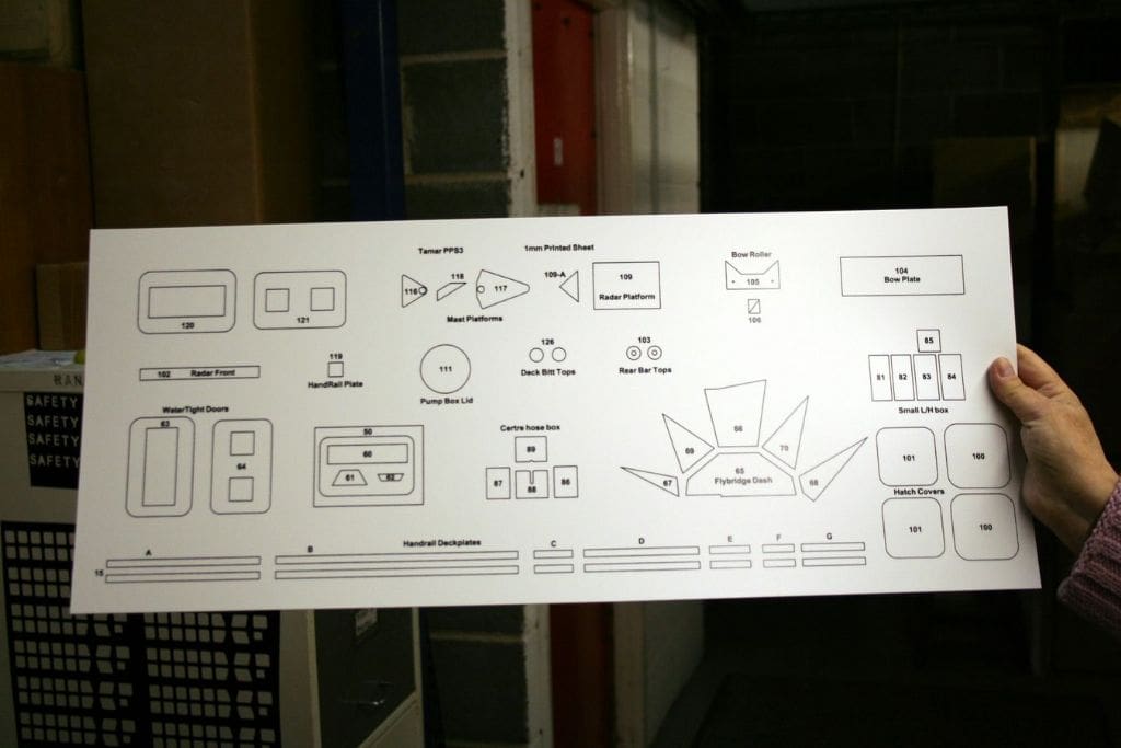

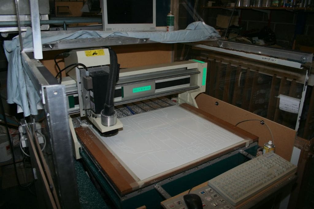

The initial CAD files are used to develop the individual kit parts such as superstructure elements and deck constructions. These can then be tested using the CNC Router to cut out the pieces to check that they fit together properly. If errors are found then adjustments are made until Lawrie is satisfied that there is a good fit. This method also means that if anything does slip through the net and is picked up by the customer, then it is relatively easy to make appropriate corrections in future production and send updated parts to existing customers on request although Lawrie says that this only happens very occasionally as the development process is extremely thorough.

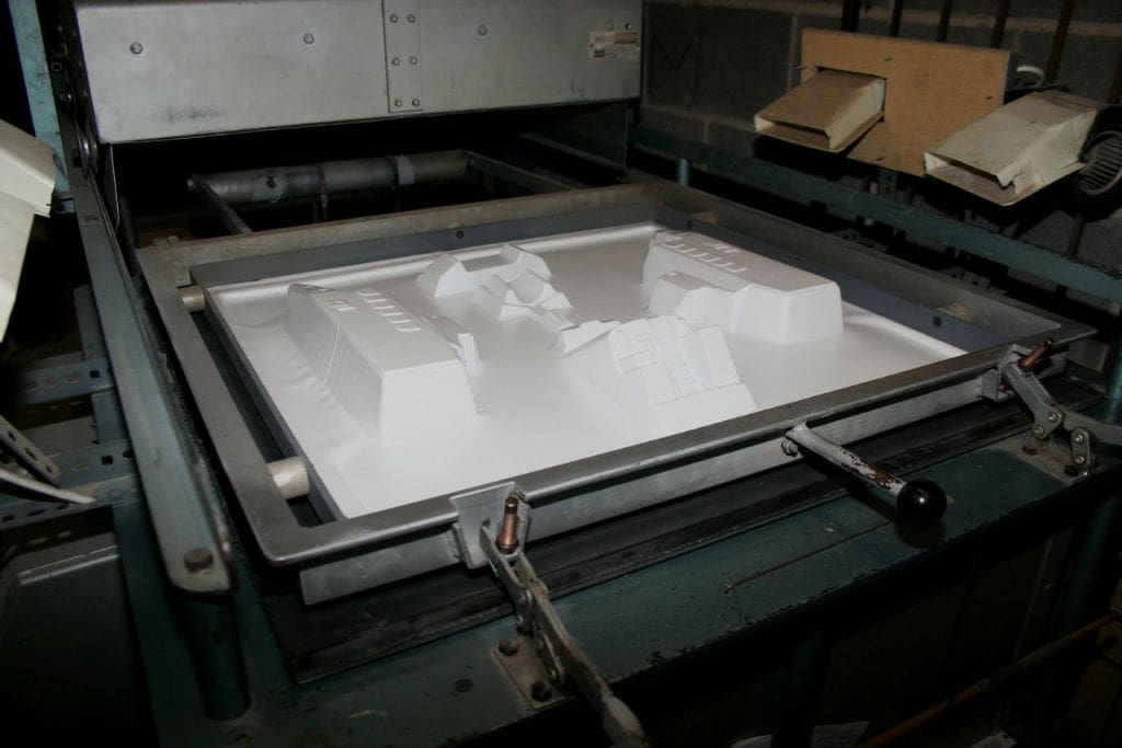

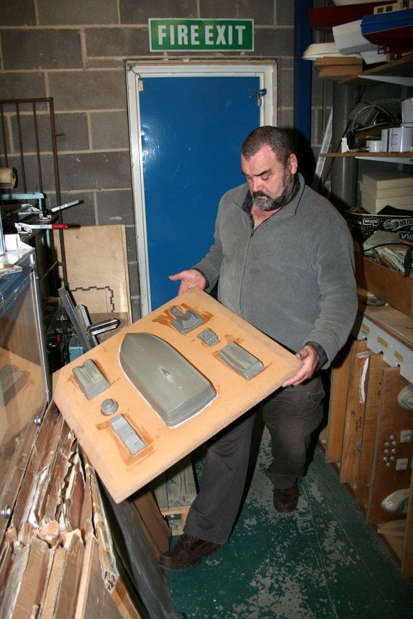

The Model Slipway range makes extensive use of styrene mouldings and the plugs for these are mounted on standard sized boards combining components that are normally required together. The boards can then be located in the moulding machine, a styrene sheet placed over the top and the heat turned on! When the plastic is sufficiently supple the air beneath the plugs is sucked out causing a partial vacuum and the styrene immediately moulds itself around the plugs. Cold air is then blown in from above to cool the plastic and the sheet with its moulded components can be extracted and cut up as required.

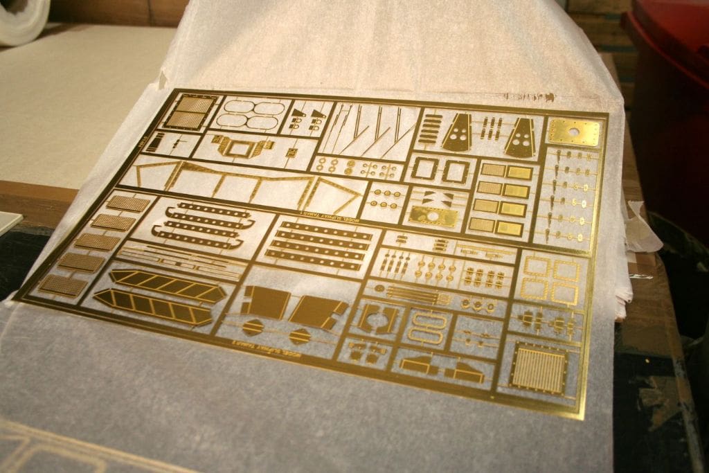

As with many kits these days, the majority of the fittings are of white metal. While this is sometimes not seen as being the ideal material for certain items, for most small manufacturers it is the only practical option as production runs could never justify the huge cost of investing in injection moulding equipment. For the majority of fittings in the Model Slipway range, white metal is perfectly okay and never less than adequate. Lawrie has gone to a lot of trouble to find an alloy mix which will preserve fine detail on smaller fittings without exhibiting shrinkage on larger items as the metal cools. Builders who wish to customise their models can always substitute alternatives from the after market if they wish, but quality control by Model Slipway is very good though. Master fittings are typically made from hard brass and used to produce a number of secondary masters in white metal which are in turn used to make the production masters. Then the primary and secondary masters are stored safely away so that if the production master moulds begin to wear, new ones can be made with the assurance that they will exactly replicate the originals. The production fittings are inspected no less than three times before they find their way into the kit box. If any rogue items should make it through this scrutiny then Model Slipway will replace it on request – and really you can’t expect better than that!
As I have noted before on these Trader Visits, small manufacturers need to work smarter to stay competitive, matching production to demand, and Lawrie and Jackie have this down to a fine art with some very clever and ingenious attention to detail. The computerised production process means that there is no need to have racks full of unsold kits in storage tying up both capital and space. The CNC router can produce a set of partially cut styrene superstructure components for a kit in just a few minutes using the CAD master instructions so all that has to be kept in stock are the basic styrene sheets. These are also used to make the styrene mouldings described above and a set of standard sheet sizes meets all production requirements. A selection of coloured sheets is kept for production of the Club 500 racers.

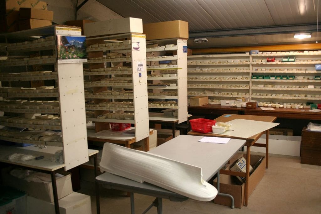

Fittings are cast or moulded in batches and stored in hundreds of labelled bins so there is always a working stock in hand. As bin contents start to run low they are replenished during the next manufacturing session.

These are a vital, but sometimes rather neglected part of any kit and can make or almost literally break a model. Model Slipway are well known for their comprehensive and clear instructions which continually evolve in response to customer feedback. The new Tamar lifeboat instruction book for example, has no less than 75 pages. Each kit comes with a detailed full sized plan with all the fittings and components clearly labelled. This is backed up by an illustrated construction manual. With many kits, you will often find that the text and the illustrations are separate, but the policy in Model Slipway is now to use the CAD facilities to associate 3D drawings with the relevant text which makes it much easier for builders to understand just how the kit goes together and reduces the likelihood of mistakes being made.
