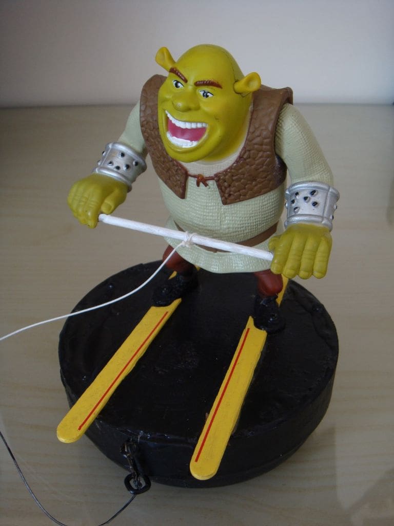

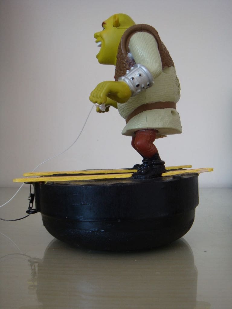

First, a float for Shrek to stand on was needed, and he uses a small circular plastic Tupperware tub, 120mm diameter and 45mm deep. This empty tub was put into a sink of water with Shrek and lead shot added to it, until it just stayed afloat. Hopefully. this would make the tub float level with the water’s surface upon final completion. Shrek was then removed from the tub, leaving the lead shot, which was then over-sprayed in expanding builder’s gap filling foam, which when cured was cut level with the top of the tub. Finally a circle of thin plywood was glued to the top of this tub so Shrek could be easily screwed, by his feet, to the top.
Hey-presto, an unsinkable float for Shrek to stand on which floated level with at the water’s surface, the lead acting as a counterweight. After painting the float with satin black paint, two lollypop skies were added for effect.

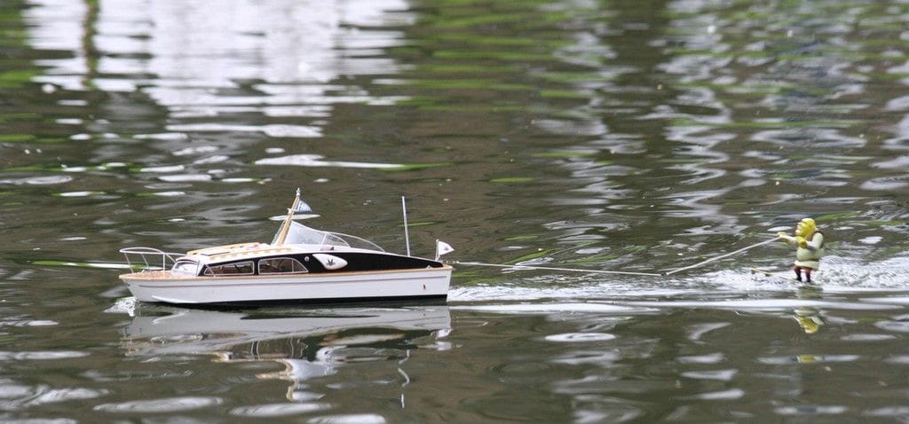

Initially it was thought that Shrek could be towed just like any ‘normal’ water-skier and that was by the hands, with some nylon cord tied between them and the back of the boat. Initial trials using this method and a Fairey Swordsman powerboat ended up with Shrek drowning face down in the boat’s wake! So, a somewhat humiliating defeat and not least as it took place in front of a gathered crowd of spectators at the Buxton MBC Club boating lake.

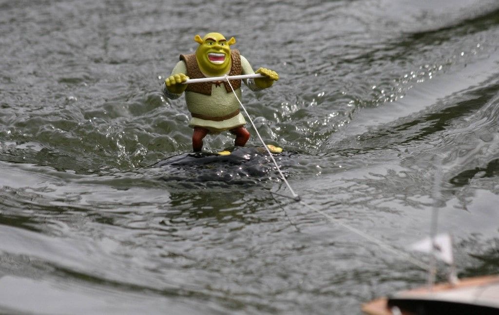

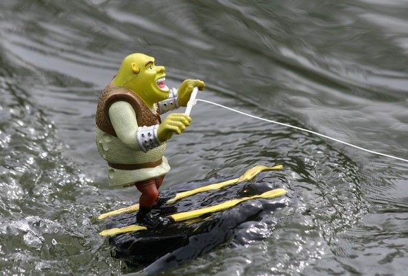

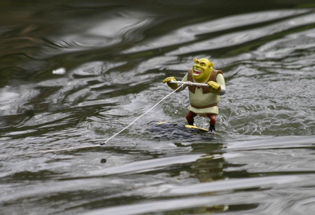

Third time lucky now and this was to keep the float line in place, but re-attaching the first line (from Shrek’s hands) directly to the float towing line with a movable bowsie to tension it. By doing this, the forward drag of the float could be balanced against the back rotation of Shrek under tow, and yes success, as Shrek had now learnt to water-ski.
Conclusion
The pictures of Shrek being towed show the connection and bowsie about mid-way above the lower line, and this has stopped the skier falling over, doing somersaults or just drowning, and the principle of the two lines going into one is equally applicable for other similar models. And the Shrek model? Well, having a McDonalds Happy Meal to get one free is hardly a hardship is it?
