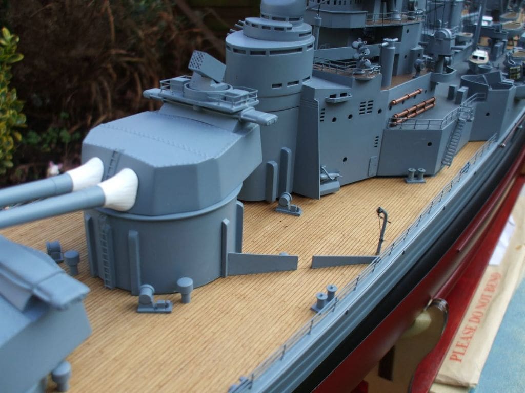

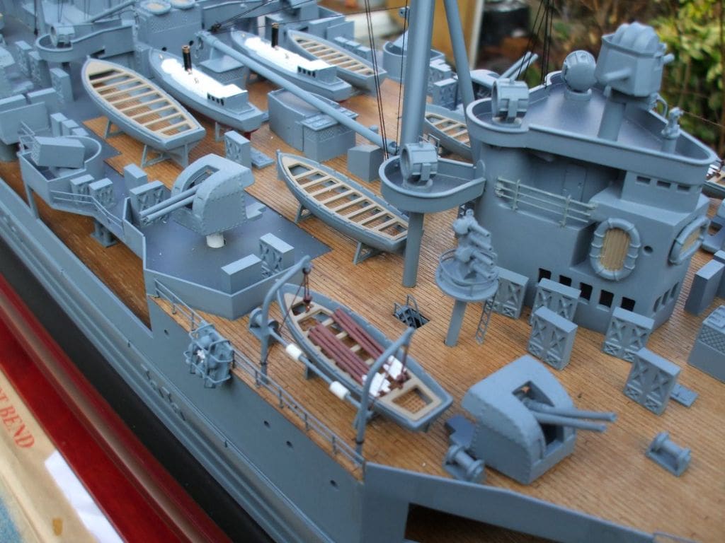

The model is inexpensive when compared with semi-kits of the same and similar sized warships. More to the point, the Graupner version fits easily into my car. However, I made the purchase with a little trepidation as I am a scratch builder and detail freak. I exhibit my models with the Surface Warship Association at various locations and HMS Hood would need to be of an acceptable finish and detail to not appear as a toy. The model became available in the UK in 2009 and I ordered one from the first batch on the understanding that it could be returned if it was not up to the standard I wanted.
I need not have worried as the model is built in China for Graupner and has a first class finish with lots of excellent detail. There was scope to improve detail, for example with better quality hooks on the cranes and ammunition davits. Also, to improve other areas, I made a new main boat boom, completed all the rigging plus re-rigged and detailed the sea boats and davits. New smaller boat booms were constructed and rigged, two night man overboard markers plus additional fittings were made for the mainmast and BECC signal flags and ensigns were flown as at 24th May 1941 to replicate the signals flying at the time of her loss in May 1941. 4.5kg of lead ballast was also needed to bring the model to the correct waterline.
