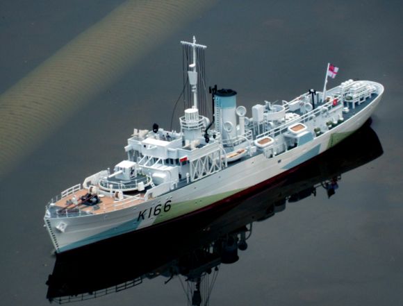

This is probably one of the most iconic kits produced anywhere in the world. First manufactured by Matchbox Kits more than 30 years ago, Revell later took it over and continued production for a number of years. Although the kit has apparently now been temporarily dropped from current Revell list, there would appear to be plenty still on the shelves of the world’s model shops. So the purpose of this short article is to show just how easily this model can be converted into a working model, through a series of ‘how-to’ photos.
Produced as a medium sized static kit, it was (and is) large enough to convert into a working radio controlled model and this particular kit has probably encouraged many people throughout the world to start their model boating hobby. At many regattas one can almost guarantee seeing one of these on the water.
The kit builds up into a perfect size for transportation, is light in weight and can cope with the average conditions at a lake. It can be built on the kitchen table and requires only a small amount of cutting and filing to convert to radio control. Photo 1 shows the kit contents and please note that the hull is in four parts which have to be glued together. Photo 2 shows the major mechanical items required for the r/c conversion. The propshaft, propeller, motor plus its mount, coupling and rudder assembly are all available from S.H.G. Model Supplies. The speed controller selected was the Mtroniks Viper Marine 15 unit, Photo 3.

Second: On another plastic tray is the Planet 2.4GHz receiver, the Mtroniks esc, receiver battery box and a set of electrical chocolate block connecters for the wiring to the motor etc., Photos 15 and 16. ‘Keep it simple’ is a good idea! With care and careful positioning of the battery, only a nominal amount of ballast will be required to bring the model to its waterline.
Conclusion
I hope this encourages readers to build this great plastic kit and convert it into a working radio controlled model. Even if you don’t intend to build it immediately, it is a relatively inexpensive kit and can be built later! The H.M.C.S. Snowberry Kit and all items required to convert it to r/c were obtained from: S.H.G. Model Supplies, tel: 01785 840308.
