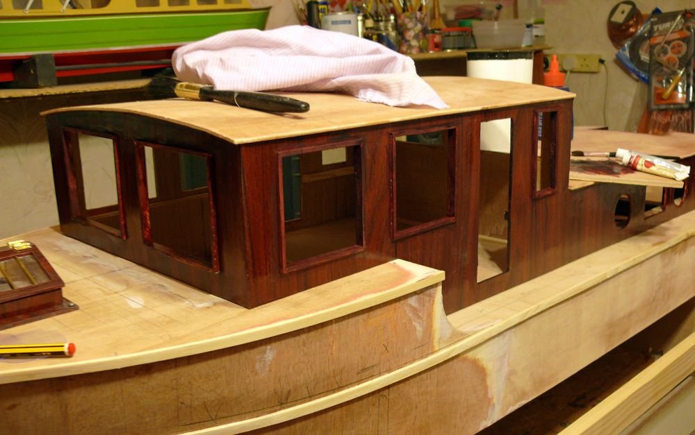

              Work in progress
              Creating the Vintage Cruiser effect

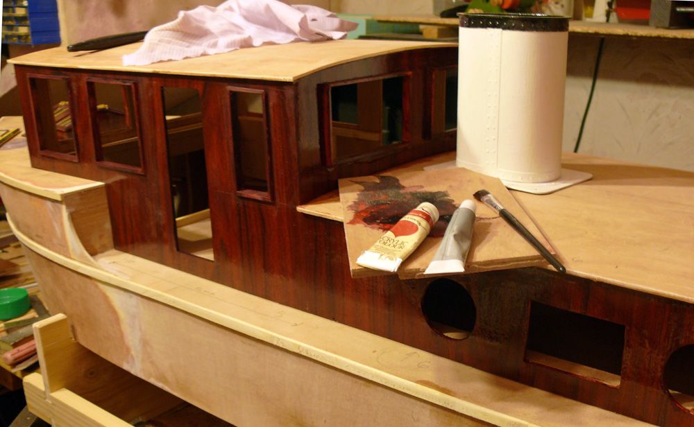

              Fitted some of the large window frames and using acrylic paint, I`ve matched the colour and wood effect to create the vintage Mahogany appearance
              Like it, Paul?
              Bob in the studio
              #54101
                It looks great you are a real life artist………….my flabber is truly gasted

                  I agree Paul, it looks absolutely magnificent.

                    I'm pleased to read that you like our latest build
                    Taking a strange delight in building this crazy OTT model
                    Merry Christmas, Peter……..Bob

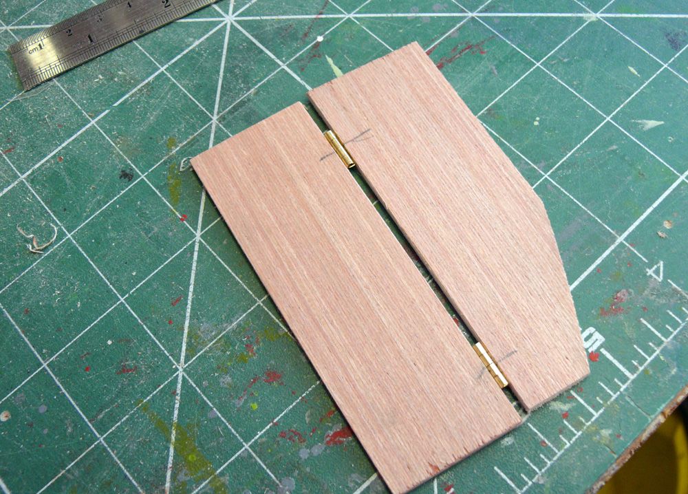

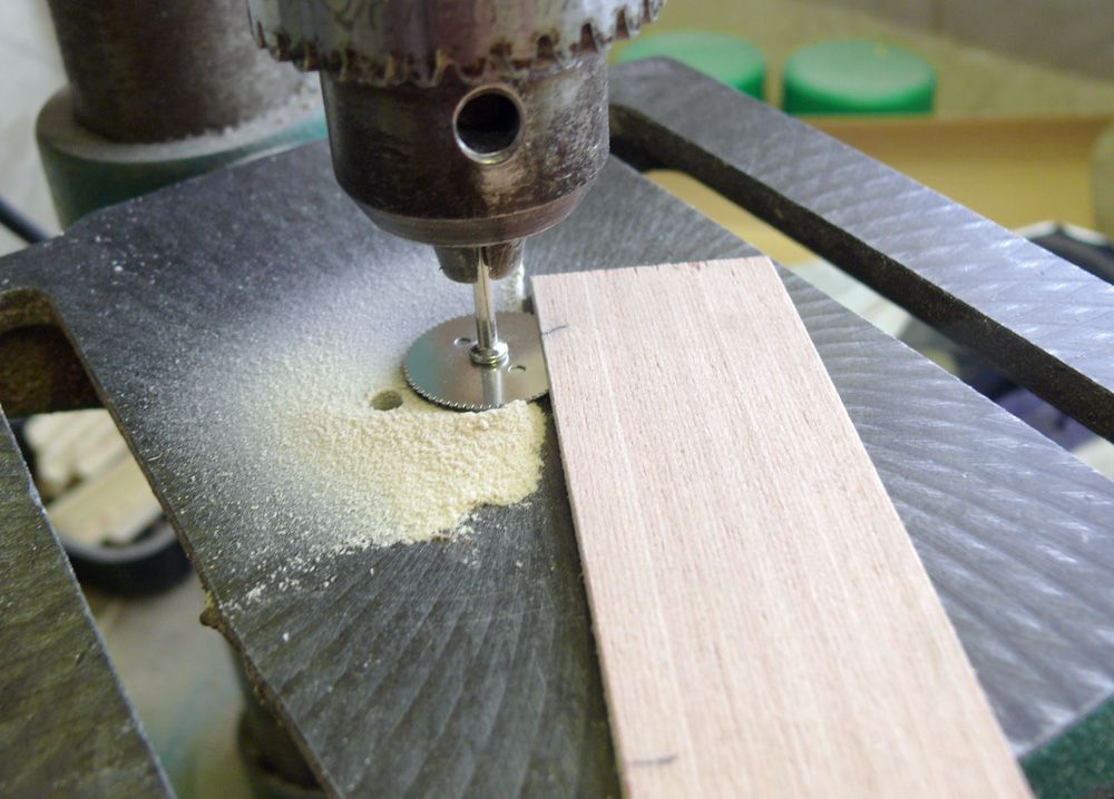

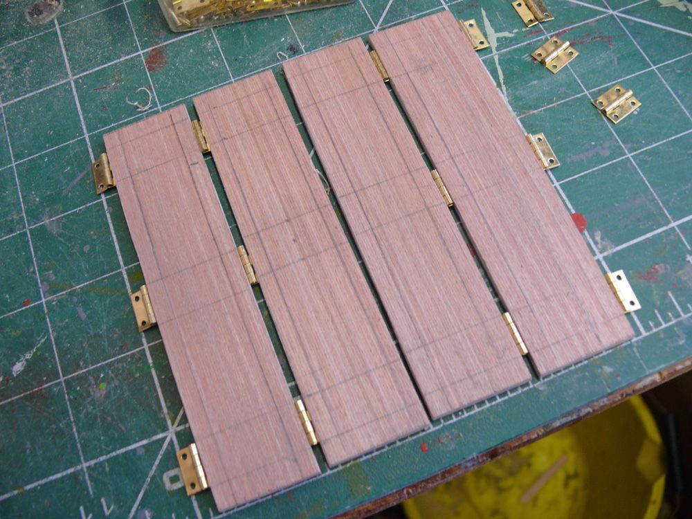

                        I needed to cut slots in the rear doors to accept the Dolls House hinges……..A very fiddly tricky job!……..Tried the modelling knife and the micro saw…..No chance!
                        Mounted two rotary mini saw blades on one spindle and used the vertical drill to cut out the slots in the edges of the doors
                        I was very pleased with the result
                        #54131

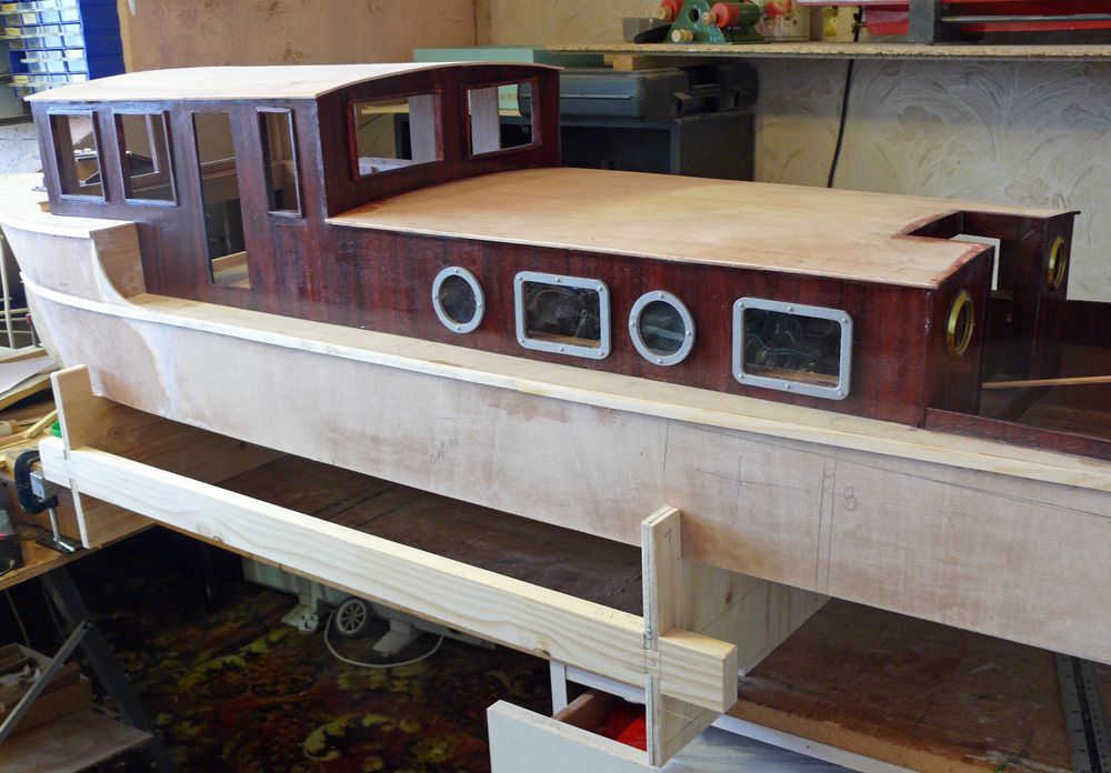

                          Work in progress
                          Rear doors and engine room windows
                          Looking nice, Paul?

                            #54134
                              Thank you, Ian
                              All great fun, when new ideas work out well!……Very pleasing

                                Hi Bob ,Like the precise marking and method of cutting ,another tip for the future .The build is coming on at a rate of knots and looking up to your usual standard ,Have a great holiday with your family before starting on our next project

                                #54138
                                  Hello Mike
                                  Thank you, for those kind words………Got to admit……I am pretty pleased with myself, sorting out the hinge attachment problem with my fiendish engineering solution!

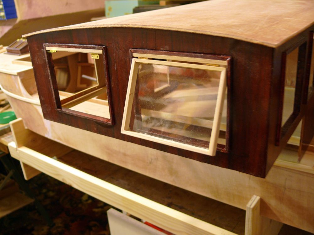

                                    Last piece of Bling for today
                                    Opening front windows……Using the new hinge fitting technology
                                    These little features are great fun and finish the model off nicely

                                    #54146
                                    Banjoman
                                      @banjoman
                                      Very nice work indeed, Bob, with the hinges! And your clever technique for slotting the panels has been made a mental note of, for future reference – thank you very much indeed for sharing!

                                      #54148
                                        Thank you, Banjo
                                        Pleased that you like the hinge installation
                                        With this method, the window can be simply pulled out of the slots, if required
                                        #54150
                                        Banjoman
                                          @banjoman
                                          Even cleverer, Bob, and most impressive to have made the windows removable in such a simple but effective way!
                                          *Ding* went the bell as another mental note registered in me ol' noggin …

                                            #54170
                                              Clever idea to hide the hinges within the ply and a lot easier than rebating them.
                                              #54180

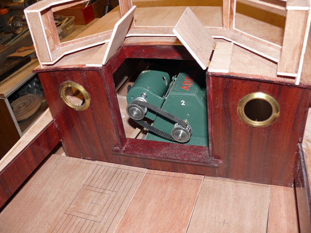

                                                Thank you, Paul
                                                Sorting out the neat hinge mounting has opened the doors to all sorts of add ons!
                                                Here`s the rear door area coming to life!
                                                Very enjoyabell to work on too
                                                ( The motor is not that close to the doorway )
