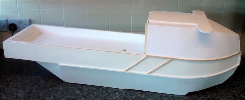

        Hi Andy
        This comes with a strange mixture of pride and embarrassment.
        I was showing him how the superstructure fitted and he pointed out that it didn't fit very well at one point and then he asked "does the whole top have to come off"?
        I told him yes because I need to get inside to fix things.
        Ryan looked thoughtfully at the model and then said "cant you get in through the back of the cabin then the walls can be fixed properly"
        Whoever said 'from the mouths of babes' had it right because in a single statement seven year old Ryan had come up with an all encompassing answer that solved quite a few design problems.

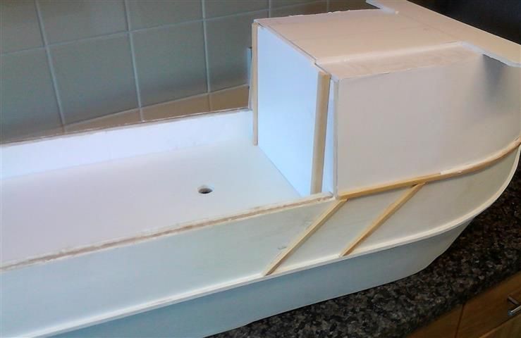

                Progress shots
                #48194
                  Like I said earlier. Paul……A few black sticky tape windows etc, simply stuck on, would be nice and would give us idea of the scale etc
                  And a 12" rule alongside?

                    Sorry but I've not fixed the scale yet so I cant do the sticky tape windows
                    Do you really need a ruler?.. I thought that the electric socket and 6 x 6in wall tiles would be a fair indication of size.
                    #48197
                      Why not try a few different sizes of windows/port holes and get Ryan`s expert opinion?
                      If your model is 48" long, a ruler comparison would not go amiss?
