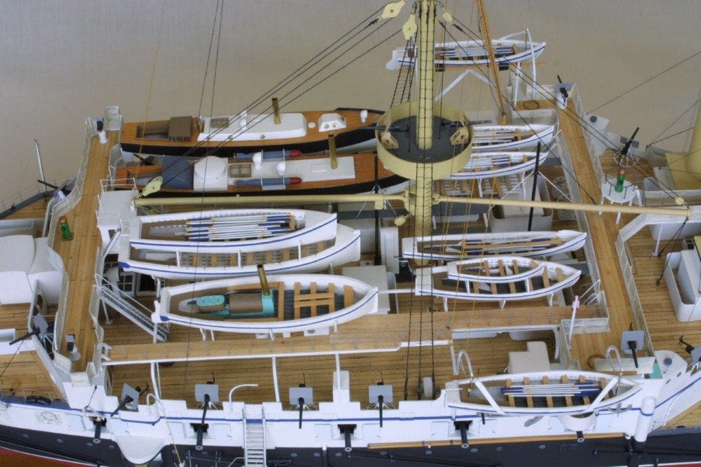

HMS Devastation, 1871
The first Victorian battleship that I attempted to model was HMS Devastation, Photo 1, sister ship to HMS Thunderer. She was a mastless turret ship and the first RN battleship without sails. She carried her main armament on top of the hull rather than inside. This meant the guns had an arc of fire of 280 degrees. The original weapons were muzzle loaders, but she was refitted with breech loaders which had longer barrels and improved her appearance enormously.

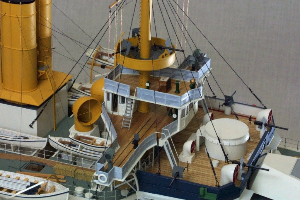

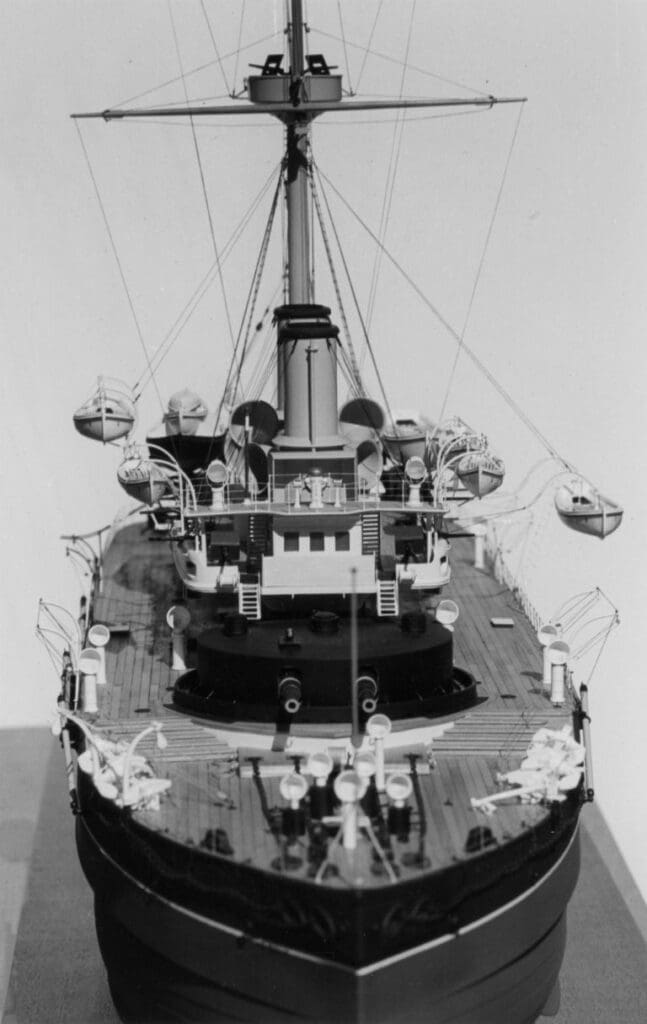

HMS Colossus, 1882
She was a very ugly looking ship and she carried four 12 inch breech loading guns, two per turret, which were in echelon, Photo 2.

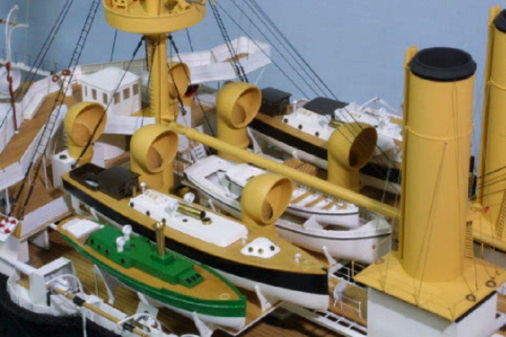

HMS Camperdown, 1885
This battleship, Photo 3, will always be remembered as the ship that sank HMS Victoria whilst trying to perform an impossible manoeuvre ordered by Admiral Tryon. This ship had an increased thickness of armour on her barbettes and a lengthened armour belt. Her main armament was in two pairs mounted in barbettes on her centreline giving an arc of fire of 270 degrees.

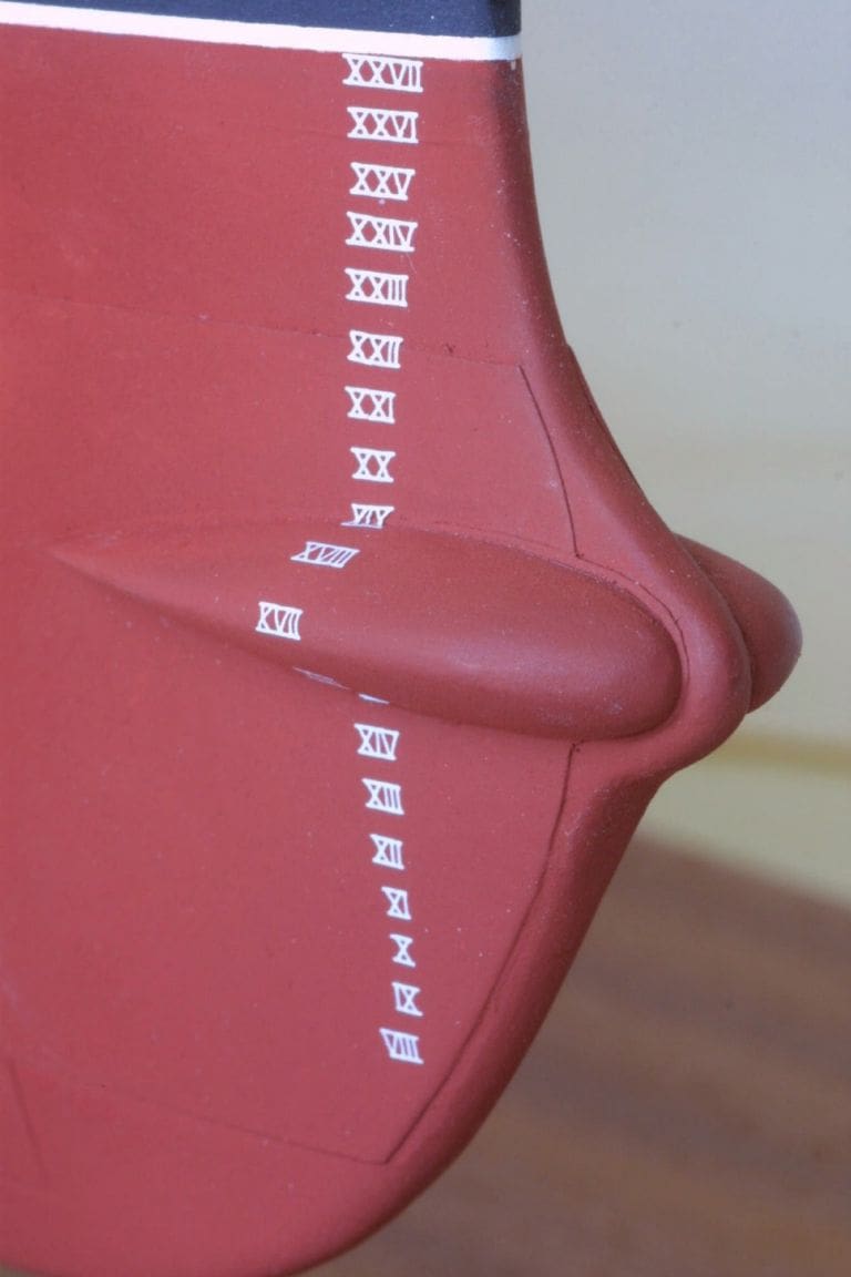

HMS Victoria, 1887
This battleship, Photo 4, together with her sister ship HMS Sans Pareil were known as ‘A pair of slippers’ as in any sea their forecastles were usually under water because of their low freeboard. They were the first battleships to be driven by triple expansion steam engines and to have their dynamos driven by steam turbines. This picture shows a large suite of ship’s boats with the sea boat cutters already swung out.

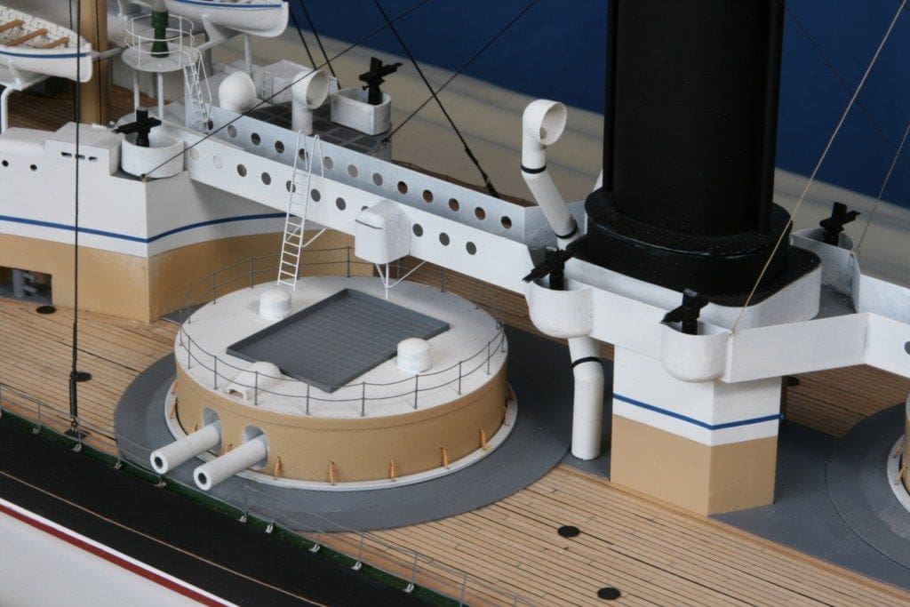

Photo 5 shows the ram bow of HMS Victoria. These were popular at this time although experience showed they were more of a menace to friendly ships than to the enemy who were unlikely to wait around to be rammed. HMS Victoria was sunk by the ram of HMS Camperdown resulting in more than 300 fatalities. This picture also shows the typical very narrow white boot topping which is an absolute characteristic of Victorian ships. If this is painted too wide on a model the whole ‘atmosphere’ of a Victorian navy battleship will be lost.

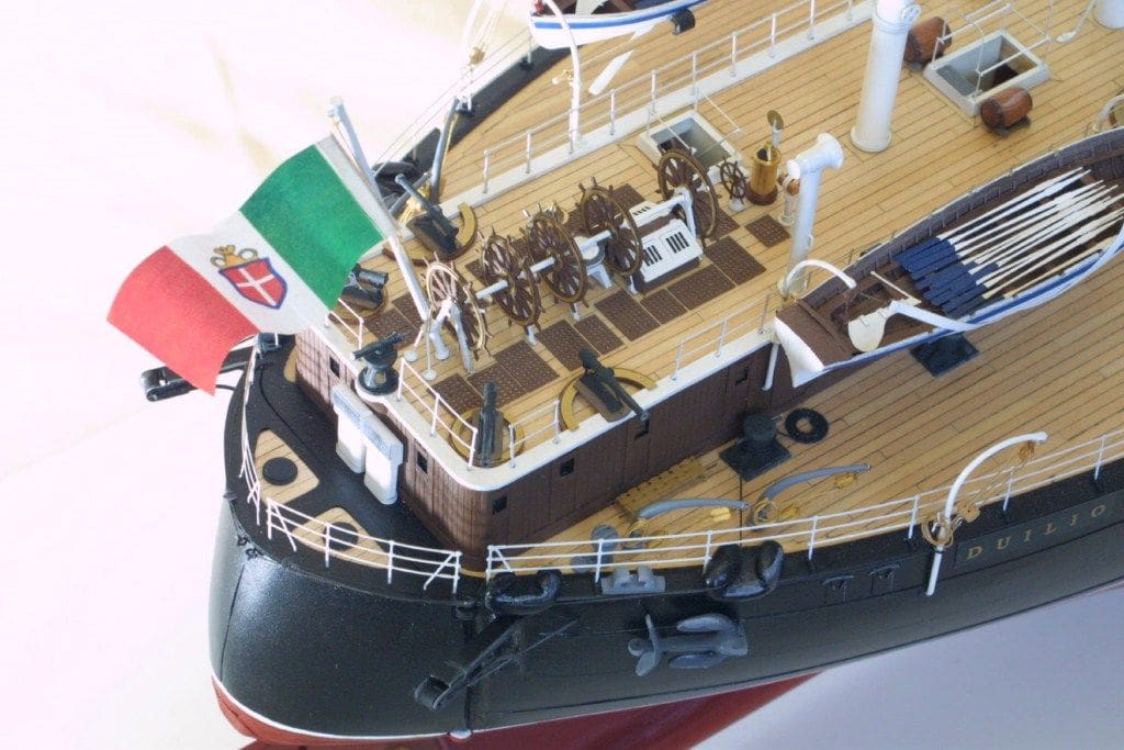

Photo 6, shows six cowl vents typical of this era. In this case the cowls were stamped out of copper sheet and soldered to the vertical cylindrical parts which was not an easy job. The picture also shows part of the suite of ship’s boats. The Victorian ships always seemed to carry a full set equipped for any task.

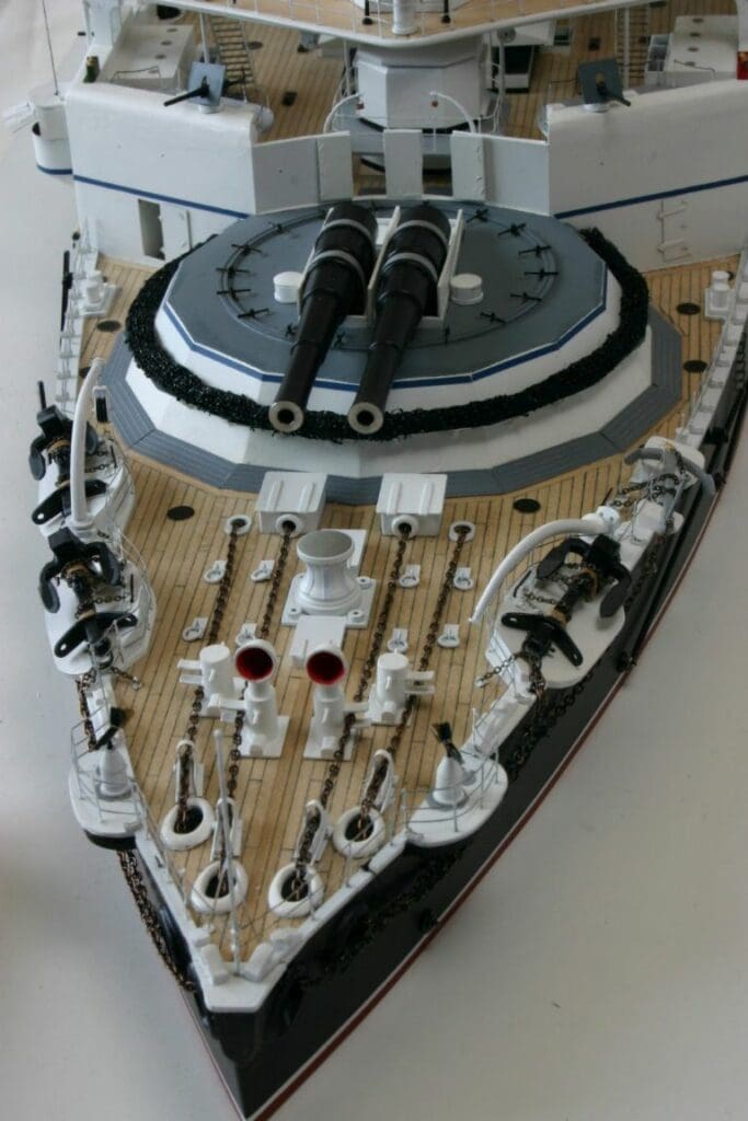

HMS Magnificent, 1894
This was the largest battleship ever built when she was launched and the epitome of the pre-dreadnoughts. She was the last battleship to have side by side funnels. The bridge was mounted around the base of the fore mast behind the conning tower. This prevented a battle-damaged bridge collapsing around the tower, Photo 7. Her pear-shaped barbettes with fixed loading positions for the main armament were not used later in her service life.. The main armament was two pairs of 46 ton 12 inch 35 calibre guns in turrets mounted fore and aft and Photo 8 shows the aft turret with its roof removed. It was not realised at this time that increased action ranges meant plunging fire and turret roofs needed armour and not merely wood and canvas. Note also the grey blast deck plates to prevent the wooden deck being burned by the muzzle flack as appearance was all important in the Victorian Navy. She also had the latest Harvey armour together with 150 watertight compartments.

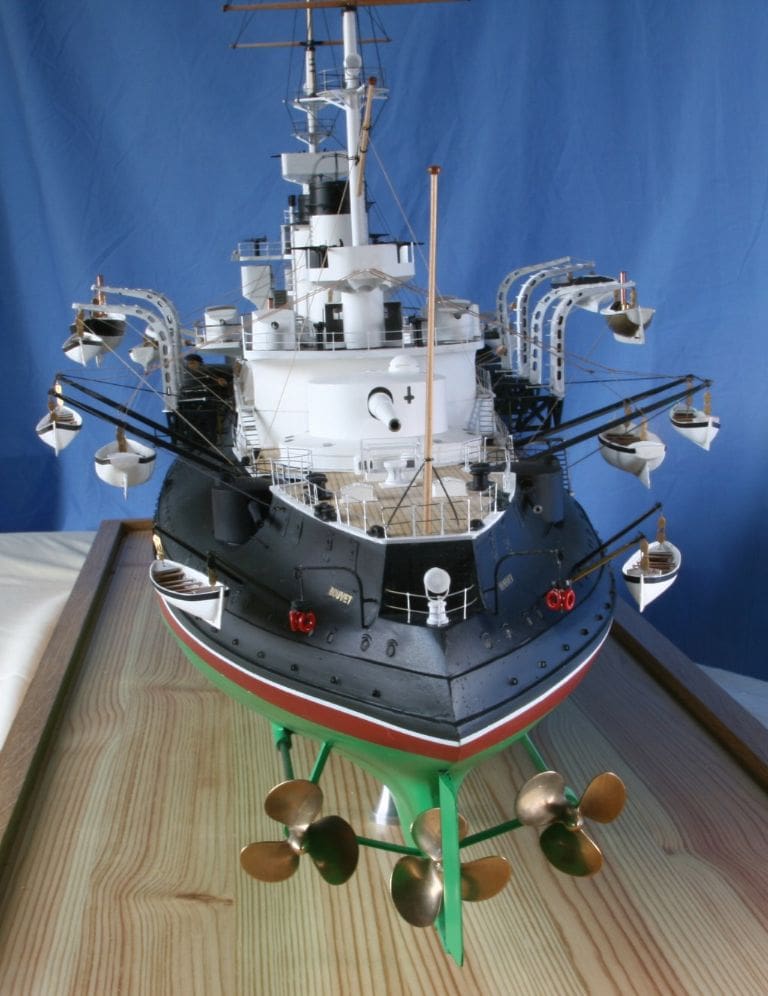

Bouvet, 1896
Bouvet was a French battleship and is my other foreign model of the Victorian era. She notably had a hull with a cross section rather like an onion, Photo 10. She was mined in the Dardanelles during WW1 and capsized and sank in two minutes, probably largely due to the hull shape. She pioneered three-shaft propulsion and had face-hardened armour. Unlike British ships she carried all her primary, secondary and tertiary armament in single gun oval turrets.
