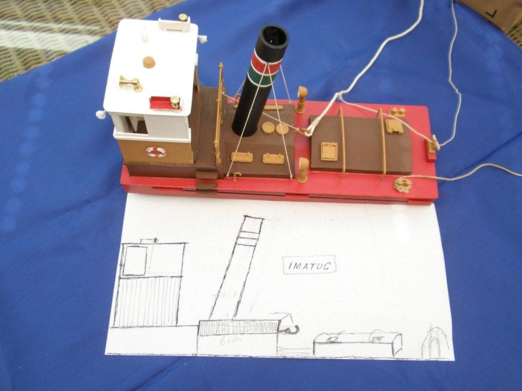

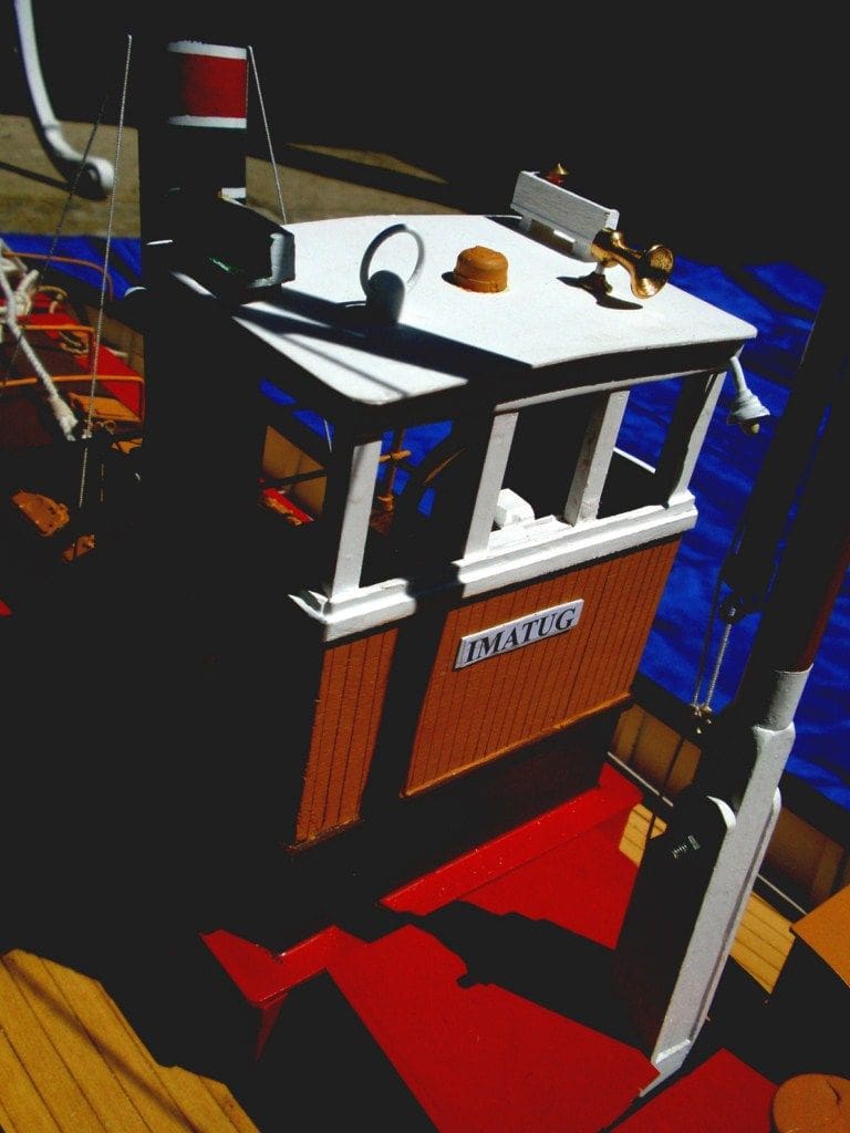

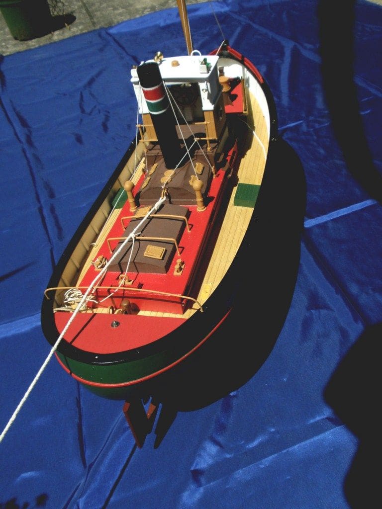

The plan was to construct a new deckhouse structure to replace the two hatch covers that identified Catherine as a fishing boat. This would be a single long hatch cover with a tug wheelhouse and funnel as in Photos 1 and 2 of the finished model. In this way, within a matter of seconds, the model could be operated as either a tug or a fishing boat. The new creation would be named ‘Imatug’, yes a shortened version of ‘I’m a tug’.

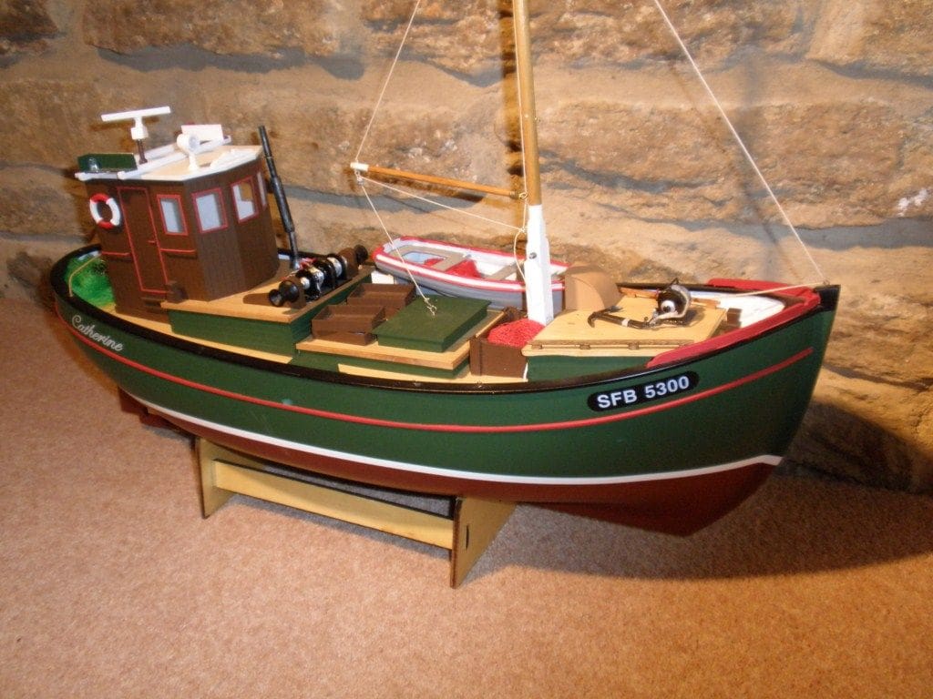

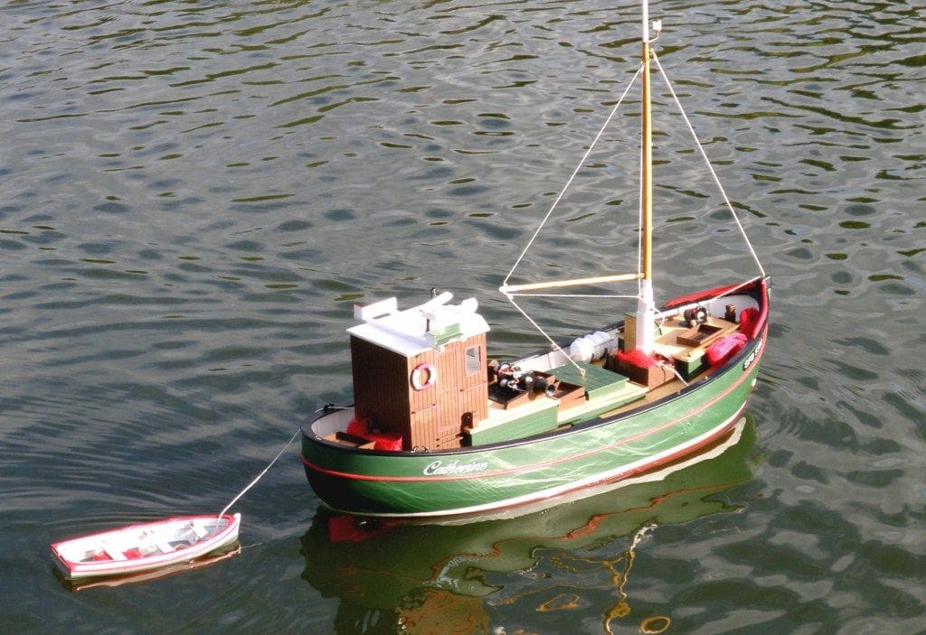

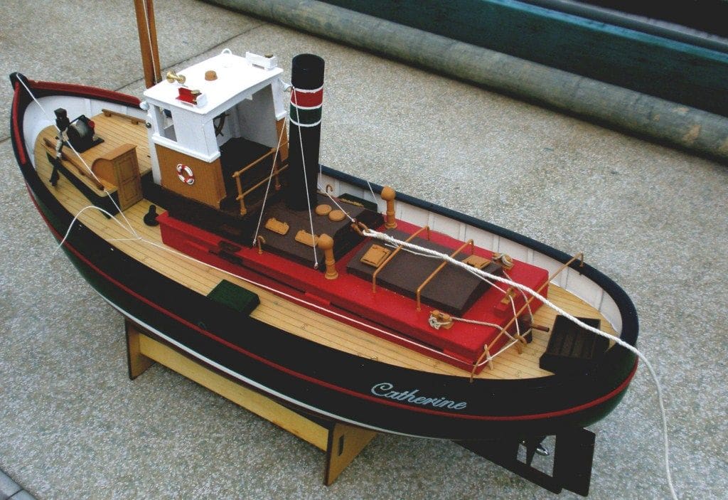

In the July 2009 MB issue there was a previous article of mine, ‘Catherine Customised’ where I described how the ARTR Thunder Tiger model had various alterations to make it more realistic, less fragile and more practical as a working model. So, this is a further reincarnation, Photos 3, 4 and 5. The basic model hull now becomes ‘Share-a-hull’ or Shareahull as the title line suggests.

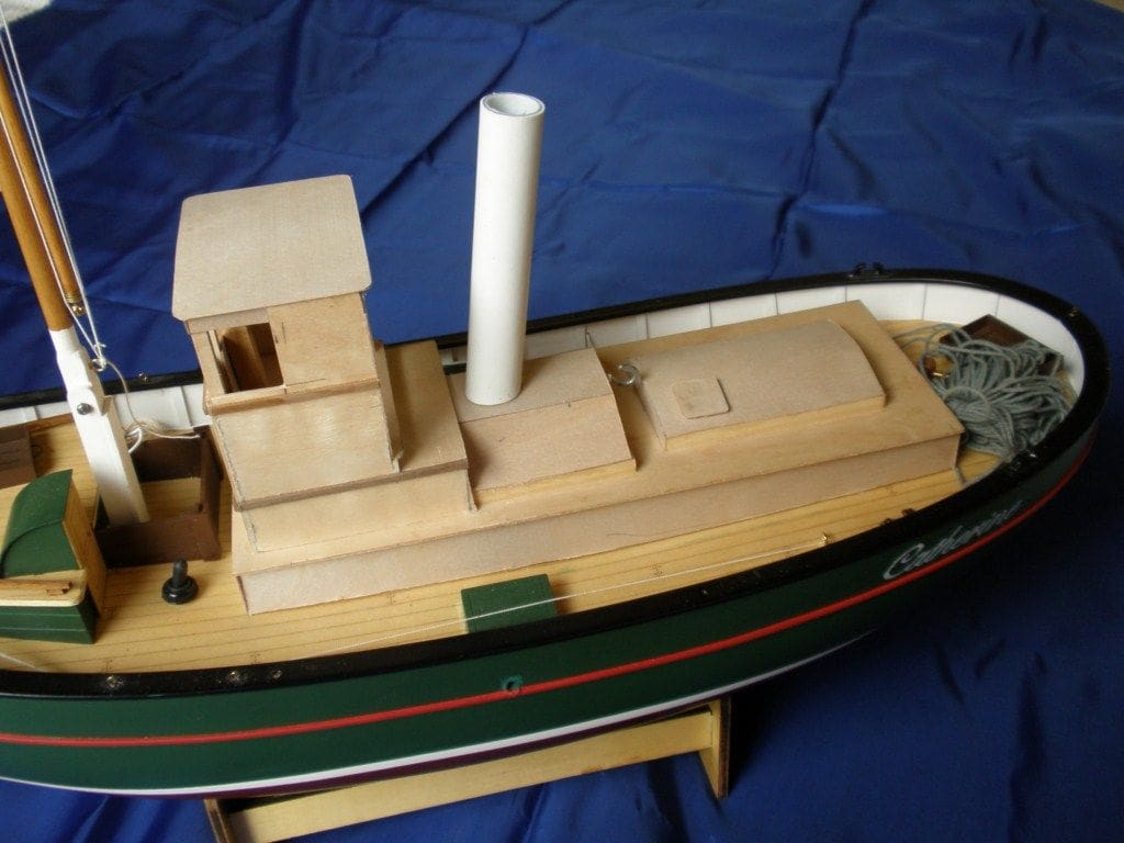

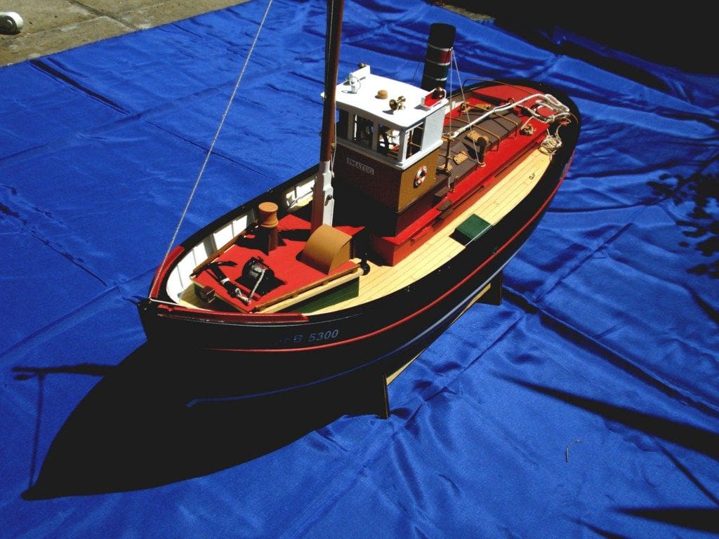

The design for the new hatch cover was very roughly sketched out full size to get the proportions correct. Photo 6 shows the basic ‘tug’ superstructure unit made from 1/32 inch plywood sheet, its pieces cut out with scissors and glued with PVA glue to form the finished painted structure you see in Photo 7 with its accompanying sketch. For added strength at the corner joints, small square section strips were inserted and the lower sides of the base unit also had to be trimmed to match the curvature of the deck. The basic tug superstructure took only a matter of hours to assemble. Good quality model grade plywood is so smooth that little sanding is needed before sealing and painting. Although styrene sheet could have been used, my preference is always to use wood, but mind you, the funnel is a section cut from a surplus plastic water pipe! I suppose years ago before the advent of plastic plumbing, some model makers would fashion funnels out of brass.

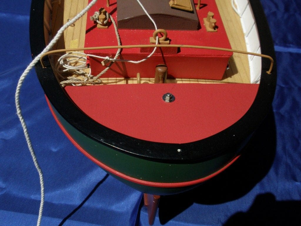

Photo 8 is a close-up of the wheelhouse front. Various fittings from the accessory box, accumulated over the years, completed the detail work, but some parts had to be scratch built. For example, the tow hook is a domestic household item hammered flat, with bits of wire glued on to it to resemble a non-working quick release system together with a lanyard leading to the wheelhouse. The metal fittings were mostly glued in place using impact adhesive, which I personally find much easier to work with, and is more reliable, than superglue. Also, wherever possible with small fittings, there is a tag or dowel inserted into the base as a reinforcement. At the stern, Photo 9, a simple flat raised deck piece hides the fish boxes beneath it with the top of a rudder bolt to simulate the small rear deck cover to the quadrant that a real tug would have. In real life this bolt could allow a tiller to be fitted if the wheelhouse rod and chains connection failed.

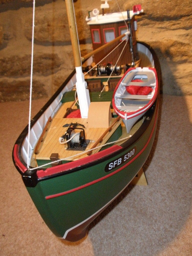

In front of the wheelhouse, Photo 10, two pieces of plywood, painted red, convert the deck to a more tug like appearance and a capstan adds to the illusion, but of course I appreciate that this conversion of a fishing boat into a tug does lack some authenticity.

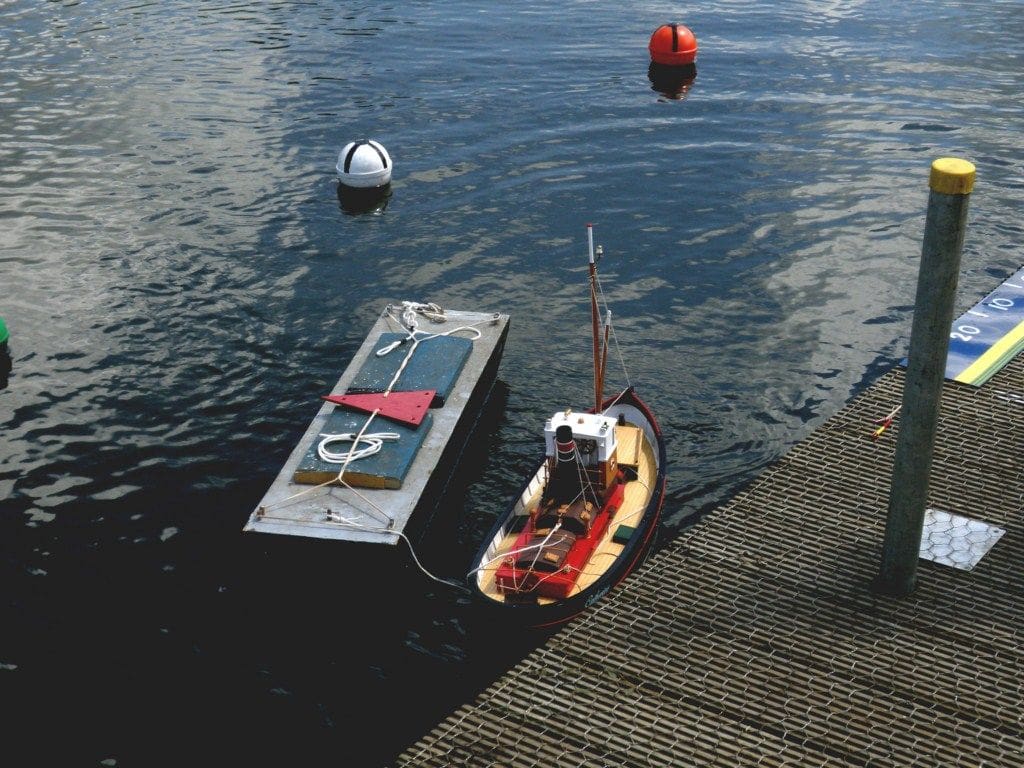

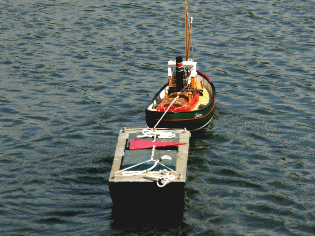

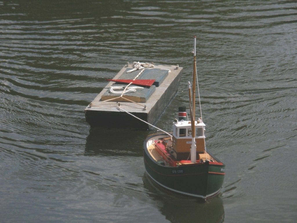

Imatug (ex-Catherine), Photo 12, tows a barge quite well and is up to the task. However, after starting off by going round the wrong side of the first buoy, I then began to get the hang of it, but inevitably it was the final docking that got me swearing. With a strong offshore wind and after many failed attempts I gave up, Photo 13! My excuse was that the wind kept blowing the barge away from the quayside, and I could not get the tug into the right a position to push it in, so I came last out of the 14 entrants.

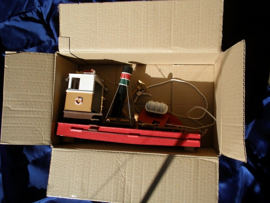

Changing over from fishing boat to tug takes only one minute and the tug parts fit safely in a shoe box, Photo 14, which is good enough for me.
