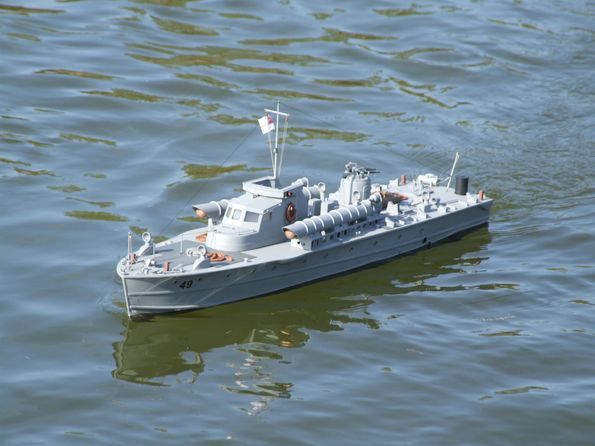

One of the models at the show from our own Brentwood MY&PBC was this fine model of MTB 49, built by Paul Freshney, Photo 6. The model was based on a 1:24 GRP hull from HSL Mouldings. Some of the fittings were also from this source, notably the Vickers 0.5 inch twin machine guns and turret, the smoke generator, torpedo tubes, and cowl vents.
Other fittings were from Precision Controls but the torpedo tube rails, hatches, bollards, mushroom vents, mine racks and fairleads were cast from resin in moulds made from Paul’s own masters. The cabin and bridge are from styrene and painting is by airbrush with subtle weathering. Propulsion is by two 6 to 12v Buhler motors running on 8.4v. Spektrum 2.4GHz radio is installed with an Mtroniks esc and the model took eight months to build. Although not visible in the picture, the rudder linkages pass through the transom and since water can enter the hull through these openings, a watertight stern compartment is incorporated to prevent the whole hull filling with water. The full size vessel was one of a class of eight ordered in 1939. Length was 75ft 9ins including the trailing rudders, beam 16ft 6ins. Propulsion was by four Thornycroft 650hp engines driving two shafts and the maximum speed attained was 29 knots. Photo 7 shows some of the detail on the model.
