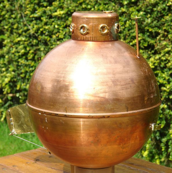

The reason for the need to waterproof servos is that in this working model of the Turtle submersible, they could not go inside a waterproof compartment – there just isn’t enough room!
At this time I was building ‘The first submarine in the world’, Turtle of 1776, and this was relevant to me as I didn’t have enough room in the WTC (Water Tight Container) for the three motors, speed controllers and servos plus the ballast system and I thought I had an insurmountable problem.
