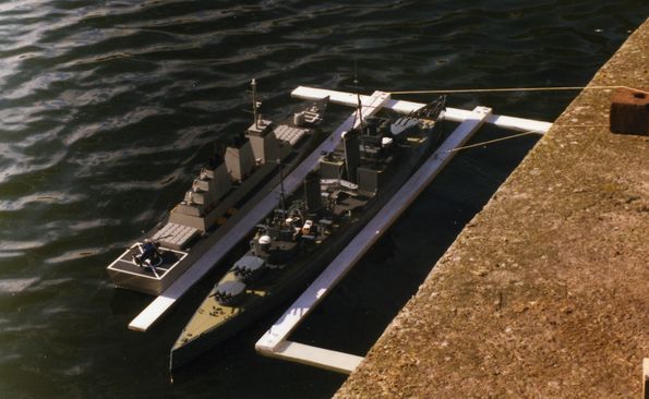

During my drop of liquid refreshment it occurred to me that it might be possible to duplicate other types of docking manoeuvres. These usually involve stopping alongside a bar where one or both ends have a barrier. Back into the garage and I quickly found that by extending the base of the ‘U’ and adding a strip to one side of the entrance, it would produce a very flexible unit. The final shape is shown in Figure 1.
I made my practice dock from some 2 x 1 inch (50 x 25mm) and 1 1/2 x 1/2 inch (37 x 12mm) timber, but these sizes are not critical. Likewise, the overall size of the dock should match that of your models without forgetting transport and storage arrangements.
The timbers were sanded, primed and painted before screwing together. My dock was reasonably compact, but you could make it as a kit to be assembled at your sailing water if that is more convenient.
Securing the dock
One thing I had not considered until the dock had been built was how to hold it secure when placed in the water. After a little more liquid refreshment the idea of using two screw-eyes fixed into the sides of the ‘U’ came to me. A loop of string tied between the screw-eyes can then be used to secure the unit to the bank side. If you have the use of a landing stage then wrapping the loop around a suitable weight (I use a brick) placed on the landing stage can also be used. Obviously you need to be careful about positioning the weight if there is any chance of people tripping over it! Alternatively a small stake could be used to secure it to a softer bank side. Both methods are perfectly adequate provided you do not want to practice in gale force wind conditions.
Figure 2 shows the different ways that this type of practice dock could be used. It would not be hard to devise other shapes and layouts. Words of caution though, get too ambitious and you could fill your car with practice aids leaving no room for models!
