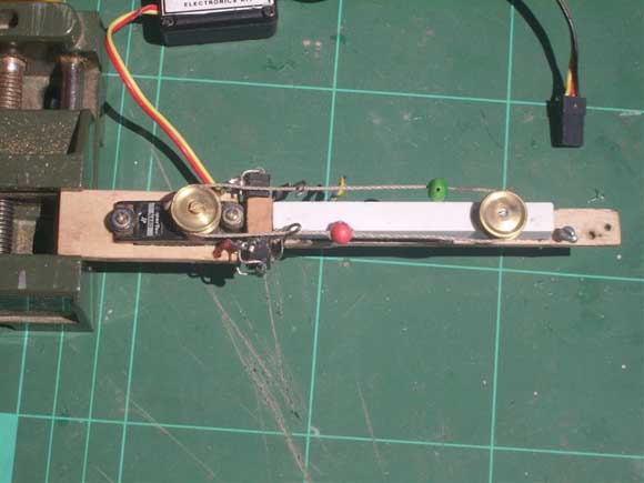

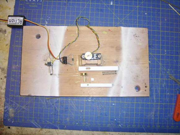

Sail winch constructionReferring to Photo 1, the component parts are: The concept is very simple, the smaller of the square tubing slides inside the larger and is spring loaded so as to provide tension to the string loop which pulls the sails in and out. The smaller tube has a vertical hole drilled through it, into which the axle of the free wheeling end pulley is snugly held. The larger of the tubes has a 10mm long slot (the same width as the pulley axle) cut top and bottom, in which the pulley spigot slides. This allows the smaller inner tube to be tensioned by the spring. The smaller tube needs a block inserted about 6mm up at the servo end, which will house one end of the spring. The larger tube is blocked off at the servo end in order to provide a base for the tensioning spring. The smaller of the tubes is slid into the larger, so that the hole is lined up with the slot of the larger. The end pulley axle is pushed into the hole in the smaller tube, at this point the inner tube will slide 6mm backwards and forwards. The spring will then tension the inner tube and that in turn the string loop. A similar pulley is attached to the servo - a small 10BA bolt cut to length will secure it. |

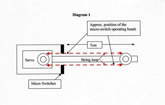

This arrangement is then glued to a 3mm wooden base on which the servo has been mounted, Photo 2. This base should be 13mm(1/2in) oversize each end so as to provide a mounting lug. For my installation in Lilla Dan, the important dimension is as in Diagram 1. Beneath the wooden base and against the servo body, glue a micro switch mounting block. The micro switches will be mounted either side of the block. |
A diode is soldered across the live contacts of each of the micro switches. Remember that a diode only allows the electrical current to flow in one direction, so you may have to re-solder one, or both, the other way around to get them to work properly. On each of the micro-switch operating levers, securely bind and glue a pre bent paper clip (as per diagram) which should allow the string loop to run freely through it, but small enough to catch the incoming bead to cut the circuit and stop the motor. If you have the diode wired the right way round, it will override the micro-switch and allow the servo to reverse. Diagram 2 is a schematic side view of the winch. You do not get strictly proportional control, but by moving the transmitter control stick forward or back and then back to neutral the servo will stop in the desired position. |
Tying the string loop and operationFirstly wrap the string once round the servo pulley and put the two beads on it. Then thread the other end of the loop back through one of the beads. Pull both ends of the string through the bead so that the spring is fully under tension add a touch of super glue to secure it. A virtually non-slip loop is achieved. One bead is sited on either side of the loop to be set in position later to operate the micro switches, Photo 3. The sail sheets are attached to the beads and obviously as they move they pull the sail in and out. The ‘run’ for these sheets can be via fine brass or styrene tubes to the desired outlet points for direct connection to the sail(s). Obviously, the longer the sail winch is, then the greater the sheet movement that can be obtained. |
