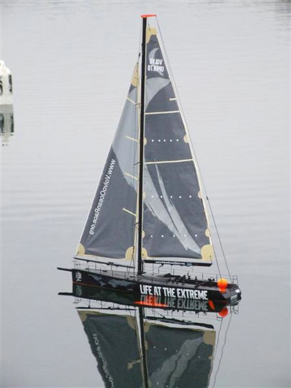

With our esteemed Editor at the controls (so that I could take the pictures) the model sailed reasonably well around our club lake at Brentwood, Photos 20 and 21, bearing in mind our total lack of experience about setting up a model yacht. The wind varied considerably from a light breeze to zero and was not strong enough to require the stabilisers also provided with the model.
Not unsurprisingly, some adjustments had to be made. The plastic bag around the r/c equipment was fouling the winch lines so that problem was solved by repacking the radio equipment. The winch lines also crossed each other, which I should have noticed during assembly. This was rectified by pulling the mainsail sheet back through the deck, uncrossing it and feeding it back through the deck. This gave a much smoother feed to the main boom.
