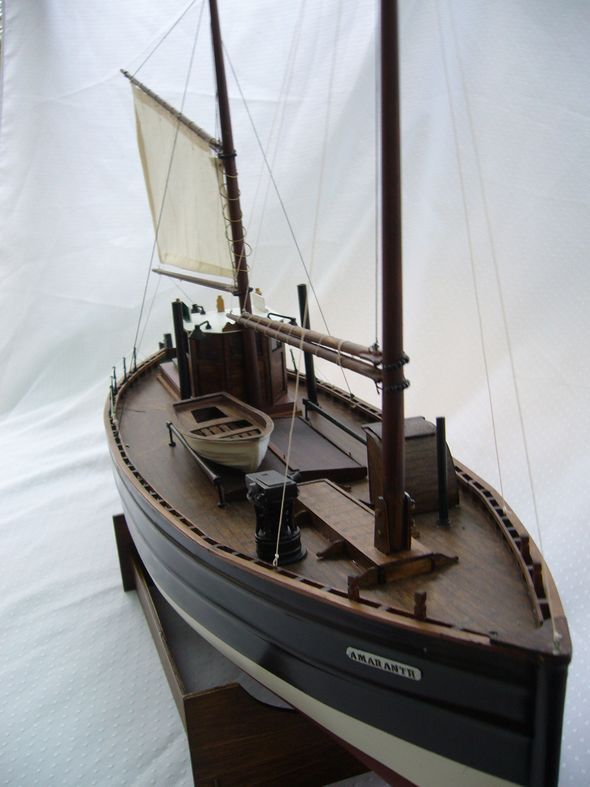

This was straightforward to construct within my limitations and I decided to stain the wooden seats and gunwale medium brown before finishing off with satin varnish. The exterior of the dinghy hull I chose to paint satin white, rather than green as recommended in the instructions. With this type of model, the colour scheme can within reason be whatever the builder might personally choose.
Next came the preparation and assembly of the whitemetal parts for the steam winch, which were also painted satin black before fixing to the deck. The companionway was however rather more challenging. This was due to the radius of the roof and I decided to assemble it on its own base before gluing it to the deck. It was not too difficult forming the radius of the roof with the thin plywood supplied, but I found it difficult to keep it in place whilst the glue was setting. Rubber bands were a great help in solving this problem and after a few adjustments, a successful result was achieved.

The masts were duly stepped into the hull and my thoughts turned to the sail and rigging. The sail supplied needed to be slightly modified to fit the shape of the aft mast and boom. This task was sub-contracted to my wife with her expert sewing skills. The metal rings for running the sail up and down the aft mast were simply made by winding some brass wire around a wooden dowel the same size as the mast.
All was now complete except for the whitemetal name plates. To paint these correctly and finish the model in the manner it deserved, this last piece of work was clearly beyond the ability of The Wobbly Shipbuilder and help was sought from a local artist who is an expert in miniature painting. As would be expected, the results were excellent and finished off my three and a half year’s work. So yes as you have guessed, I am not a rapid builder, but I find it very therapeutic and satisfying to achieve a decent personal final result.
The Motor Fifie Amaranth has now been placed on its own special shelf in the summerhouse, below the ship’s clock and barometer kept from my last full size boat.
