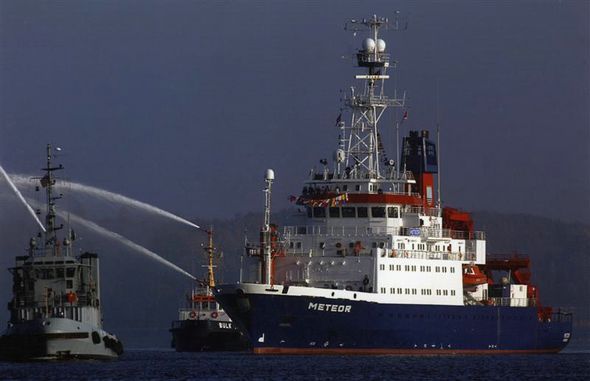

Built by Schlichting Shipyard at Travemunde and launched in 1986, RV Meteor, Photo 1, has been contributing to German ocean research since that date. She is described as a multi-purpose research vessel for living and non-living resources, and is capable of world-wide operation. She is owned by the German Federal Republic, however scientific voyage planning is the responsibility of the German Research Council's Senate Committee for Oceanography and the running of the vessel is entrusted to the Meteor Head Office at the University of Hamburg. She is one of the world's best research platforms and is managed by a private shipping company, Reederei F. Laeisz based in Hamburg. She is at the disposal of all marine research disciplines working in ice-free seas.
Meteor is 97.5 metres long, 16.5 metres beam with a displacement of 4780 tons and is powered by twin diesel-electric motors in tandem. Her normal crew consists of 33 personnel and she can accommodate up to 30 scientists using the laboratories and large number of items of scientific equipment embarked.
