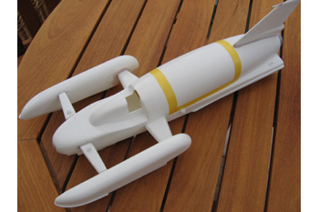

AssemblyWith the parts cut out it was time to start the assembly, but first I decided on the glue to use. As recommended in the instructions I used liquid Plastweld which can be obtained from model shops and is a plastic solvent glue which works best by capillary action when gluing two plastic items together. But a word of warning, do not overuse on ABS plastic as it can melt or deform the material. I also used Revell Liquid Contacta Professional for the stronger joints as this has a very fine nozzle for accurate application onto joints etc., but it takes longer to set and may require clamping parts together. Photo 3 shows the two glues with the first parts ready to join. The two halves of the main hull were the first to work on and with the edges of the parts sanded level they were glued together and left to set, as were also the parts for the sponsons (outriggers) and the rear fin; these can be seen in Photo 4. The sponsons were made from two parts of vac-formed ABS plastic, jointed and made watertight. With the main hull and the sponsons parts joined they need to be fitted temporarily to the spars, wood dowels that pass through the hull and into each of the sponsons. These must not yet be glued as the spar covers need to be fitted. Photo 5 shows the dowels and sponsons. The spar fairings need to be fitted and again these are made up from two parts of vac-formed plastic and glued together. These parts are probably the most important to get right as they have to be trimmed to fit as near as perfect to match the contours of the hull and the sponsons. When happy with the fit they were slid over the dowels and all were glued together as can be seen in Photo 6. Any slightly open joints were filled with plastic filler. When working on the front of the hull I turned the hull upside down and fitted the planing wedge on the underside of the nose. I decided to make this wedge from balsa, (not provided in the kit, but a wooden wedge is) and faired in with Isopon as can be seen in Photo 7. The rear fin is also in two parts that are glued together and sanded to the shape of the hull and then glued in position. To finish this section of the building the main access panel on the hull was cut out and held temporarily in place with masking tape, also the cockpit cover was temporarily fitted, but more on this later. Photo 8 shows the bare assembly ready for the next stage. |
