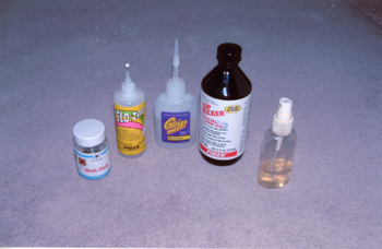

AdhesivesBefore starting to describe the build, a few words about the adhesives that I use. These are cyanoacrylate esters, (Superglues), that are either Grip or Pacer make. I also use an accelerator spray called Pacer Zip Kicker, Photo 1. These glues come in different types, i.e., thin, medium and thick, which I use depending on the part of the model where I am working and the material I am using. Superglues bond almost immediately which can sometimes be a problem. Pacer market a glue called SloZap that takes up to about a minute to cure, depending on the temperature where it is being used, allowing some adjustment to the part being fitted. I you want to speed up the curing process you apply a light spray of Kicker and the glue will grip almost immediately. If you haven’t used cyano glues you will not be aware of the problems associated with their use. These glues must be used with a degree of caution. Superglues aren't new so we are all well aware that if you get it on your fingers they will stick together, and in freeing them you will remove some skin. If however you use Kicker with the glue, the combination produces a great deal of heat, which if it lands on your skin will give you a most painful chemical burn. I always wear disposable surgical gloves when working with cyano, and I also use an after work cream. Finally the glues should be used in a well ventilated place and you should avoid inhaling their vapours. Read the instructions and warnings on their containers. Pacer also produces a debonder to free bonded surfaces which is very handy to have around. Building PlansBefore building commences I would recommend that some time be taken to carefully study the plans. As I am not very careful when handling my plans the first thing I do is to make several copies of them, at A3 size, at my local garage or Post Office. Most new plans are now drawn to a scale of 1:50, although plans drawn some time ago will be to a scale of 1:48. If you wish to convert plans drawn at 1:50 to 1:48 they should be copied to 107% of their original size. However the difference in scale is so little that it doesn’t really matter. I make two copies of each part of the plans and stick them together with transparent tape, one copy for reference while working on the model, and one for templates. Building CommencesThe first task is to cut out the templates for the frames and transfer the outlines onto the 4mm plywood, Photo 2. Next draw, on the inner side of the frames, the part that will be cut out and discarded, Photo 3. If you are careful when drawing the frames onto the plywood you can save a considerable amount. The distance between the inner and outer edges of the frames should be about 5/8in. At the bottom of each frame, where it will be notched out to join the keel, measure upwards about 1in and draw a line across the bottom of the frame. This will ensure that the frame has sufficient strength to prevent it from splitting while you are working with it. Remember to number the frames in several places! Because I was installing an untried bow thruster system in the model I used frame 7 as a watertight bulkhead, as you can see in Photo 4. When all the frames are cut out sand the frame edges and lay them aside until required. Keel and DeckCut out the keel template, to which the frames will be attached, about 1in wide. See Photo 5 and subsequent photos for details. Attach it to the plywood from which it will be cut with drawing pins and draw its outline, marking the frame positions. It’s extremely important to ensure that the keel is completely straight after it is cut out, and that it isn’t warped or twisted. If it is, discard it and cut another, as it will only lead to trouble later in the build. Cutting out the deck is quite straightforward, bearing in mind the above remarks. | |
