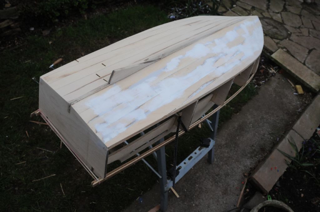

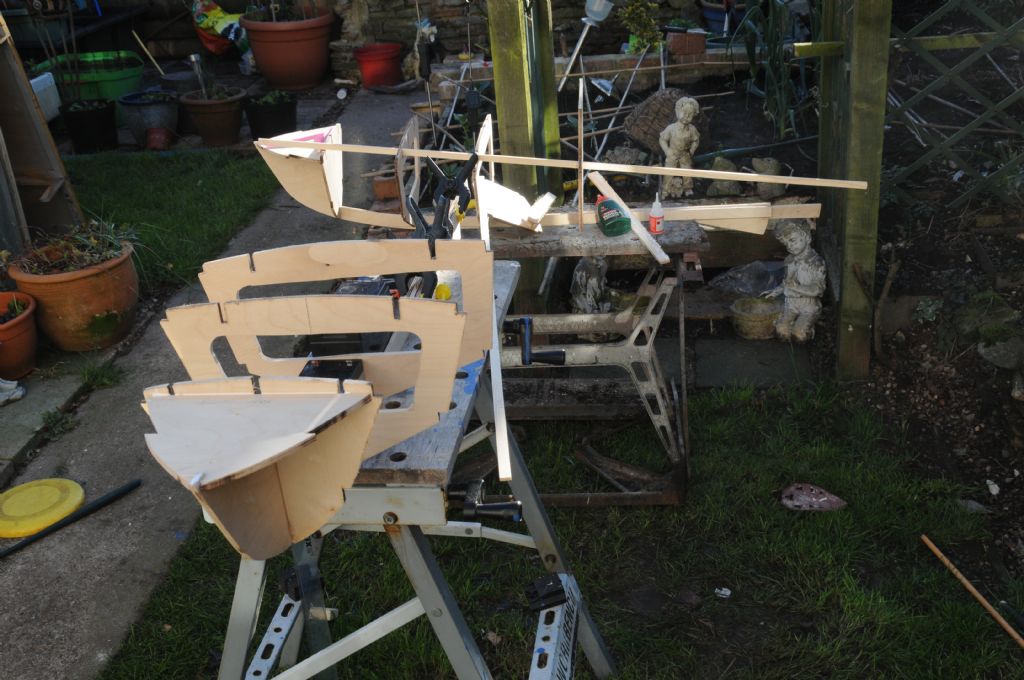

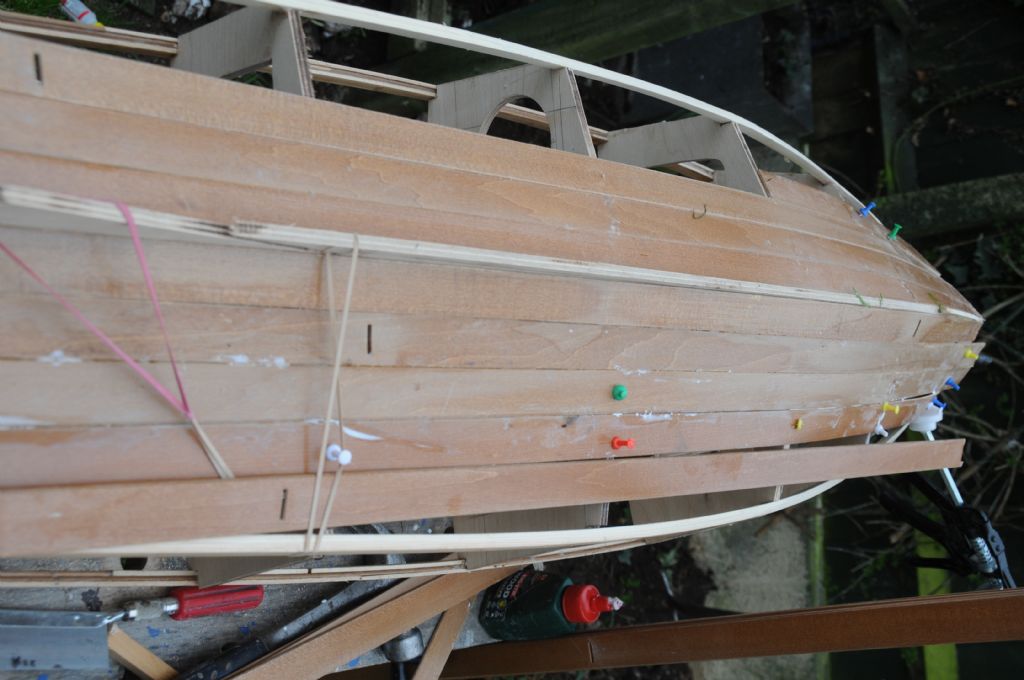

Hello Ed,
I can find your pictures to view the state of Sea Queen ,
if the skins are allin place , try a running a coat of polester resin round in side hull
just poure it in and then move the hull to get in all the nooks and crannies use a pait brush to coat remaining , also poly varish can be used. i do this on all my hulls plugs any small defects and gaps, here is exsample of a sea queen i am building at the moment using plank on frame using Ikea blind slats se pics ....larry .....sea queen
