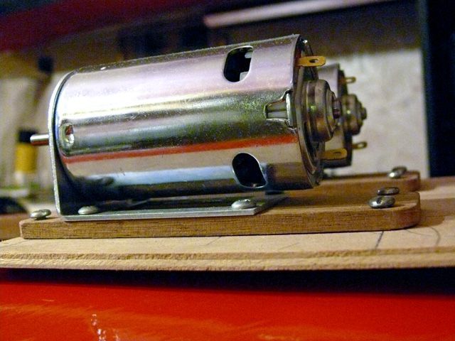

Just a pet niggle of mine......
If the motor manufactures had any common sense, they would have made the motor base 1" wider..........Then we could reach the screws easily!
I would also like to see the shaft protrude at the back end..........Would be handy for ganging up?
What`s your pet niggle?

I have found this too Bob. Removing a motor becomes like a chinese puzzle where you have to think three moves ahead- especially in the confines of a smaller hull. I am going to have a go at making the mounts for my next boat to accommodate this and watercooling coil problems.
I see you got round it by making another wooden mount. Cunning!

What is wrong with the solution displayed in the first post of this thread?     If the base is too small for you, bolt it onto a bigger piece of metal plate with countersunk bolts through the bottom and drill new mounting holes in it!

i always make my own motor mounts i just go to our local iron mongers and buy a cpl of off cutts for the price of a cuppa tea, then drill bend etc to fit, my last 4 mounts have cost me 50p and a little time.

I am afraid that Ron has it, making new mounts is the easiest way round it. if you have to go to the trouble of special mounting plates and wot not, you may just as well make a new mount in the first place. I must say that I normally use a clamp arrangement for my motors avoiding this problem. Oddly enough i had to remove the motor to fit water cooling on the Seahawk, wot used the standard mount and only just managed it by removing the motor first whith the front screws, ...HOWEVER..when replacing the motor i used cap head screws at the front and it was much easier to put back in. An allen key will hold a capped screw on its end , and the bend of the key means you can get to the screw directly underneath the shaft no probs.
